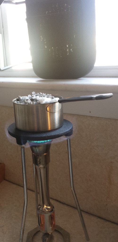

Additional photo and info - I found that I had to cover the entire surface of the metal in the pot with about a 2 or 3 mm layer of NH4Cl and then I think I added more part-way through the melting. The black thing in the background is an exhaust fan in an open window, right next to the melting pot. That's a Meker burner using propane.
melting pot.jpg - 204kB
