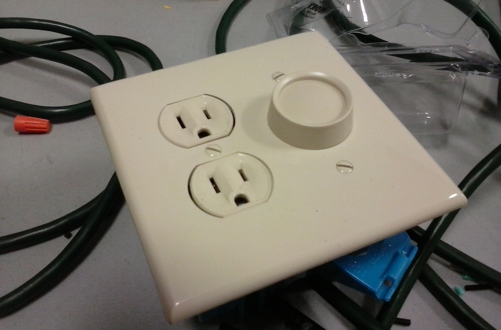

So anyway, I bought an immersion heater. At 120v it's a 125 watt heater. The plastic part of its housing appears to be composed of some kind of hard thermoplastic that I think can withstand 200 C or so. If the housing melts or burns, I might try making repairs with a silica gel bound composite.
I stopped by Home Depot and picked up the following parts:
600 watt dimmer switch
15 amp grounded electrical outlet
2 slot electrical receptacle
outlet / switch combination receptacle cover
13 amp grounded extension cord
I assembled these items into a current regulating device. First, I cut the extension cord off at about 10 feet from the plug and used it as a power source to the receptacle. I wired the outlet to the dimmer switch and the dimmer switch to the power source. Then I screwed the components into the receptacle and installed the receptacle cover. I tested the device, and it seems to be working great for regulating the heating of a cup of water. Since the device can take two plugs, it will output 250 watts if I add a second immersion heater.

I took pictures as I was constructing the device and will post them in the near future.
[*] posted on 17-10-2015 at 00:54
20151016_191055.jpg - 869kB 20151016_191610.jpg - 790kB
20151016_193710.jpg - 847kB20151016_194249.jpg - 827kB20151016_194559.jpg - 795kB
