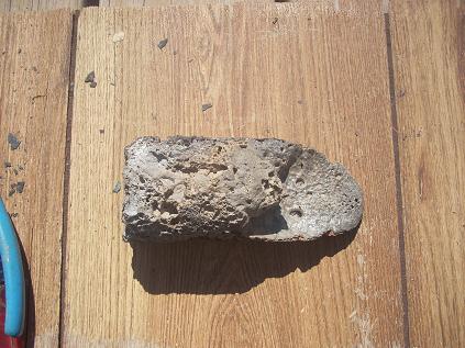

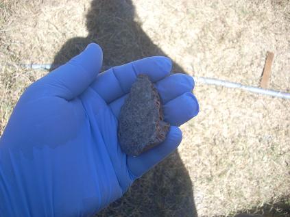

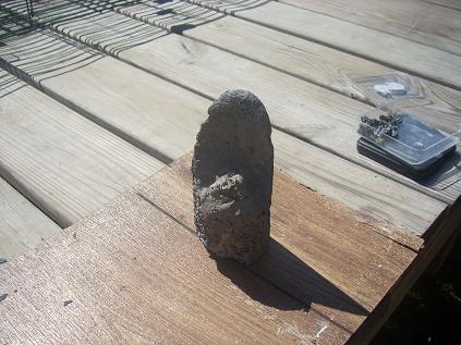

it can be cut and peeled off the mass of slag without too much hassle. when a heavier vessel is used it may prove more challenging. i think another run in more controlled circumstances is called for with more stringent data records.
Have you actually had a close look at the slag inside the can? You might actually find quite some P near the exhaust... Just a thought...
Rogeryermaw
Posts: 656
Registered: 18-8-2010
[*] posted on 1-10-2010 at 10:51
yes sir i have. i reuse the 3/4 and 1/2 inch piping on each reactor. there is little if anything to get from it. however under the conditions i've been using it would likely burn away trying to recover it. from my observations the bulk of the P is still in a gaseous state until it hits the water at which point some is recovered and some is lost, the ratio of which is still a mystery to me. it is my (quite unconfirmed) opinion that there may still be some in the melt, some of the chemicals are not reacting and there are losses to atmosphere. keep those thoughts coming though because they are what have been pushing me in the right direction.
it also occurs to me that some of the reaction may not be as straightforward as i have been assuming. there may be significant losses to the formation of metal-phosphides as part of the slag. that, to me, would be an acceptable loss since it is the use of a reactive metal that has brought the whole concept of phosphorus production within the reach of home experimenters. i wonder if using the excess aluminum is contributing to this...

i will get to the more important numbers and testing soon but here is some preliminary data.
1.JPG - 68kB
the initial weight of the reactants was about 217g and post reaction almost 200g give or take (scale accuracy)
2.JPG - 71kB
3.JPG - 74kB
mass as removed from can (minor losses due to the brittle nature of the slag)
4.JPG - 75kB
appearance of the inside. note the gas pockets. smelled terribly of phosphorus when broken open(wasn't trying to sniff it but couldn't help catching small whiff as it was very strong.

Thought-provoking Teacher
Posts: 10340
Location: Old Blighty
[*] posted on 2-10-2010 at 12:43
Good work!
You could repeat that small test by means of some muriatic acid (HCl) instead of water, that would be definite proof... (AlP +3 HCl ---> AlCl3 + PH3). AlP may be more resistant to H2O than we might think...
Bear in mind though that although AlP will have a considerable Heat of Reaction (it can indeed be synthesised by direct union of the two elements), the HoF of Al2O3 is likely to be much higher, thus enormously favouring the formation of the Al oxide over formation of the phosphide, at least in near-stoichiometrical conditions. In the presence of large excesses of Al, formation of AlP would almost certainly occur. A formulational error could thus have dire unintended consequences!
We shouldn't exclude unreacted NaPO3 being present in the slag either: in a melt like that, dropping concentrations of one of the reagents may cause reactions speed to drop quickly and thus yield to be very incomplete...
[Edited on 2-10-2010 by blogfast25]

Strepta
Posts: 44
Registered: 6-5-2004
[*] posted on 2-10-2010 at 12:48
There will always be some traces of phosphine, evidenced as gas bursting into flame as it surfaces the water in the receiver. This is presumably due to an inability to completely de-hydrate the calgon. I performed my experiments 2-3 years ago (indoors) using my fume hood. Following the reaction I disassembled the apparatus underwater (after careful post-reaction weighing) and don't recall any evidence of a reaction between the slag and the water. An abundance of caution is always advisable, however.
"Incorporation" of the ingredients may be a factor. Have you ever made your own black powder and compared it to a sample of XXX Goex? It's no contest. I used pyrotechnic Al with the calgon and silica flour and whizzed everthing in a coffee grinder for 2-3 minutes.
I averaged about 50% yield (actual recovered vs theoret. available). The weighing indicated that about 70% of the theoret. P was released. Collection efficiency was therefore about 75%, which was good enough for my purposes.
not_important suggested using an equimolar amount of boria (boron trioxide) for silica, which I tried. It actually produced a marginally higher yield (52%) and the slag appeared to be a lesser amount. Boria begins to soften about 450C, considerably lower that pure silica.
Looking forward to your next results!
