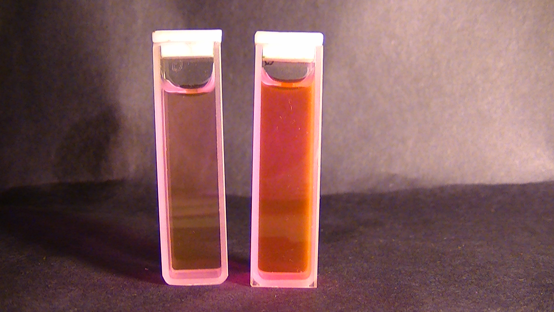

I have to repost this again since the images were deleted by the moderator previously by mistake, so here goes, I built my own spectrometer so I could do spectral analyzing of organic compounds from a kit by Plab, and here are some of those results:
FINAL DATA on S1 thru S4 532nm scans mar25.png - 88kBraman laser mar22.JPG - 659kBrhod b samples mar22.JPG - 598kB20160203_153632.jpg - 427kBexcitation data for SC1 thru SC4 532nm rhod b methyl b mar27.png - 26kB

While that is cool, I think you should talk more about your design. Both rhodamine B and methylene blue have very distinct VIS spectra (both absorbance and emission). Perhaps more information would open a discussion on hacking a monochromator (1 for absorbance, 2 for emission) in order to try and get a recognizable spectrum?

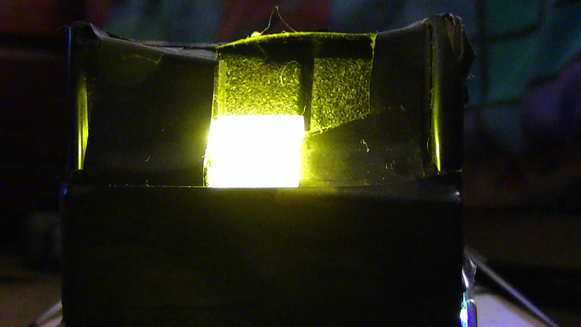

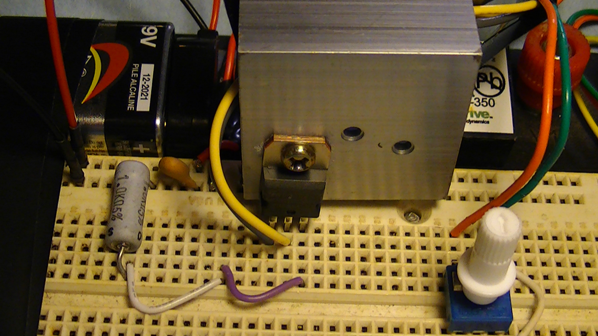

[*] posted on 6-4-2016 at 15:08
New upgrade for my spectrometer
I redesigned the LED driver circuit for the prolight UV LED I use for my spectrometer, and here are the schematics and some pics of the circuit in operation and some work I'm doing with Fluorescein:
baseln crrtcd prolight fluorscn 1ml apr5.png - 22kB 1ml fluorscn prolight apr5.png - 95kB Prolight fluorscn ready to plot apr5.png - 23kB view of pot.JPG - 700kB front view.JPG - 696kB 1W prolight LED driver circuit apr6 rev2.png - 26kB close view of NPN.JPG - 645kB

Rev 3.0 to my LED driver circuit...
I revised my schematic to incorporate the bourns POT to control the main voltage and use the trimmer POT to control voltage at the hundreth of a volt range.
specs on the bourns POT:
Bourns POT 82A1AC28BA0728.
1/4" diameter flatted shaft. 10K Ohms, linear taper. 2W, single-turn cermet potentiometer.3/8" diameter threaded bushing. New pot, prepped with three 6" wire leads.
1W prolight LED driver circuit apr7 rev3.png - 27kB
