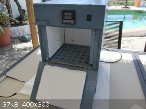

[*] posted on 4-4-2018 at 04:01
A couple of days ago i finally knocked up a DIY Incubator using some plywood, sheets of polystyrene from the bins, a light bulb and a $10 PID Controller set off ebay.
https://www.ebay.co.uk/itm/AC-100-240V-Digital-PID-Temperatu...
Works reasonably well. Gets up to 40 C reliably.
closed.jpg - 39kB open.jpg - 37kB inside.jpg - 33kB

[*] posted on 16-8-2018 at 09:10
Aga
That's a nice setup there. I like it. Professional looking too!

CharlieA
Posts: 645
Registered: 11-8-2015
Location: Missouri, USA
[*] posted on 16-8-2018 at 15:35
Very nice job, aga! Your work is very professionally done! Does your unit have a fan for air circulation? I would think an old PC cooling fan would work OK, since the operating temperature of the incubator will be low.
Metacelsus
Posts: 2524
Registered: 26-12-2012
Location: Boston, MA
[*] posted on 17-8-2018 at 13:26
Looks great! My only concern is that the wood might be difficult to clean. What do you plan to use the incubator for?
