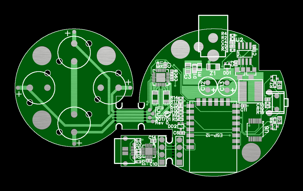

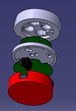

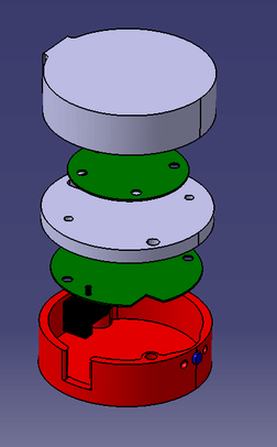

In other news, I'm back from my holiday, so I'll be slowly chipping away at this project. During the holiday I couldn't resist building a very preliminary mechanical and electrical design for a stirrer-only project:
What you're seeing here is an exploded view of the mechanical design as well as the (again, super-preliminary, this-wont-actually-work) electronics. The mechanical design is an exploded view, showing the overall shape (bit like a hockey puck). It's made of a top aluminum block which houses the inductors (which sit on their own round-ish PCB), a middle aluminum disc which mounts the second PCB and acts as a heatsink for the driver and a bottom plastic cover because.. well, wifi is screened pretty effectively by aluminum otherwise. Power entry is through the black connector and a little button is on the front. Mounting the stirrer can be with either standard 60mm clamps or with an M10 thread in the back (also fairly standard among retort supplies).
The PCB is shaped... weirdly. This is mostly for testing purposes. Really, it's 3 PCBs all stitched together in such a way that they can be easily broken apart. On the left is the inductor mounting PCB, on the right is the main electronics (dominated by the big wi-fi module, some power management and the driver chip) and in the bottom is a USB to serial PCB to program the ESP8266. This can all be assembled in one go and tested, and then before mounting it in the enclosure it's broken apart into the separate PCBs.
This design is NOT meant to be any kind of idea of how the final product would look or work. I mainly just wanted to have some kind of baseline as to how big everything would be and how the costing would look. So as of now, these are just pretty pictures to look at.

As a repair enginner, the first things I saw were;
. electrolytic capacitors in a hot unventilated enclosure, at least use solid/polymer capacitors
. no way to replace the capacitors - could you use lands that protrude beyond the capacitor leads ... then they will be easier to replace.
(to get old ones off, grip with pliers etc. and twist cw/ccw/cw/ccw... starting gently, the body will come away without damaging the tracks, allowing de-soldering of the remaining bits of leads)
the same applies to the lands for the indutors.
[Edited on 8-1-2017 by Sulaiman]

Note that this is just a stirrer, this is not designed to become warm at all. The electrolytics are designed to be safe life.
Most round lands you see are actually through holes, but my PCB rendering program for some reason doesn't render them as such. So yeah, the inductors and caps are in fact through hole components :)
