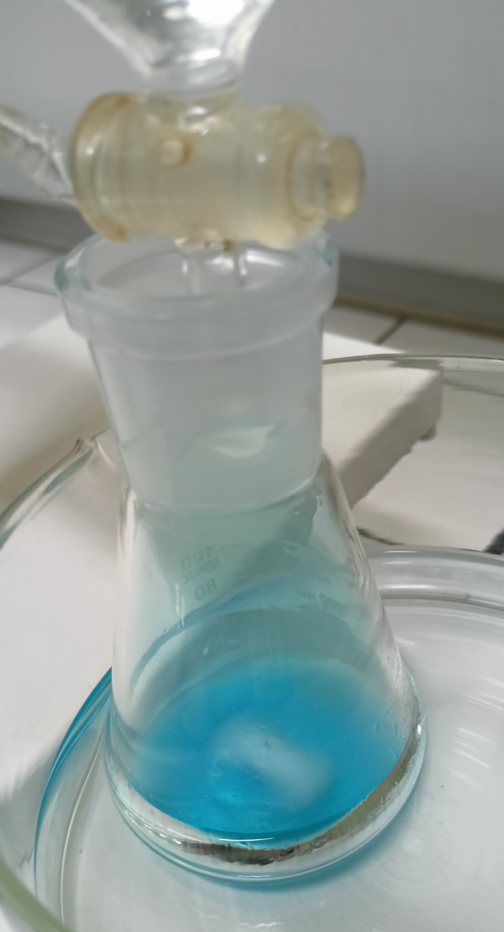

Reagents:
-20% H2O2, diluted from 27% chlorine free pool shock
-Sodium tungstate, hydrate, used from bottle as is
-t-Butylamine, distilled from CaH2 the day before to a perfectly clear liquid
Procedure:
1eq t-butylamine is added to an equal volume of water, and 0.035eq Sodium tungstate is dissolved in this, a small amount stayed undissolved, but this cleared up later on. This is chilled in an ice bath, and 2eq of Hydrogen peroxide as a 20% solution in water are dripped in over an hour, keeping the temperature between 15-20oC. The first few drops only resulted in a cloudy solution. The solution was stirred for another hour without the ice bath, and here is what I came back to.
1.jpg - 567kB
The procedure states salt can be added to clear the "emulsion", but separation was already great, so I didn't bother. The blue liquid was separated, washed with very dilute HCL, and dried with MgSO4. It should be noted that at this point the dimerization to the clear solid is significant, and I would recommend working with haste.
2.jpg - 578kB
