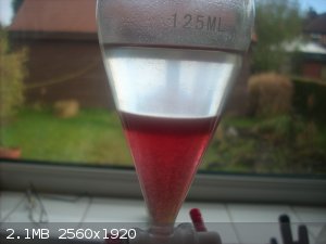

The presumed acylated intermediate appears to be soluble in neither pet.ether nor xylene, as the freebase.
The solution from the acylation was basified with 30ml 30% w/v NaOH and it immediately solidified within a few seconds. Upon adding H2O to attempt to get it out of the sep funnel (I ended up having to stopper it and shake the bejeesus out of it to free the (hopefully) 1-propionylpiperazine in chunks. On adding a lot of H2O, sufficient to make the solution up to a little under 1/4 liter and then trying first pet.ether, and then when no change, the last of my xylene (well almost, I have a little more in an OTC product, but this would require distillation, and currently I am not in the mood, since I've been working all night without sleep, so that, if it must be done, can wait until tomorrow)
The xylene initially turned slightly cloudy, on shaking, after adding a little argon to the headspace of the flask) Product appears soluble in neither however, although this is as yet unconfirmed for certain and will not be until a sample of the nonpolar fraction is gassed with dry HCl to test for ppt) However a pale cream-amber brownish layer set up on the interface between polar and nonpolar layers, this is being saved separately from both polar and nonpolar fractions, it appears at first, as a fine floc, mostly suspended in the basic aqueous fraction, and then, slowly, migrates to the interface.
Photos attached
Edit-red coloration is due to the source of the piperazine, there was some red dye, erythrosine or carmoisine, the latter I believe, remaining due to the source of the piperazine, which was 'pripsen', a (formerly, its now, I believe, been discontinued, at least here in the UK, but fortunately, I had some on hand due to another project I have on the go, the synthesis of DM-235, 1-propionyl-4-benzoylpiperazine, one of the AMPAkines, and quite a potent one at that, IIRC acting as a phosphorylation inhibitor as well as positive allosteric AMPAr modulator. Whether, like PEPA, this is flip/flop isoform selective I don't know.)
Which makes everything rather handy really, since the practical work done in the acylation, will prove invaluable.
So ignore the coloration of the aq. fraction, if it ends up left behind in the product at all, once alkylated, then it matters little, for recrystallization will see to that, and even if traces remain, it is after all, harmless, being of a grade sourced from a pharmaceutical product in the first place. So I am not unduly bothered about a little dye hanging about halfway during a synthesis.
1-propionylpiperazineflask.JPG - 2.2MB interfacepip.JPG - 2.1MB

Did get some of what is most likely the acylated product, although its pretty much a pain in the arse to work with, And the first attempt WAS done acylation first. This is going from a reference found online, it seems like the yield is very sensitive to the solvent conditions used
