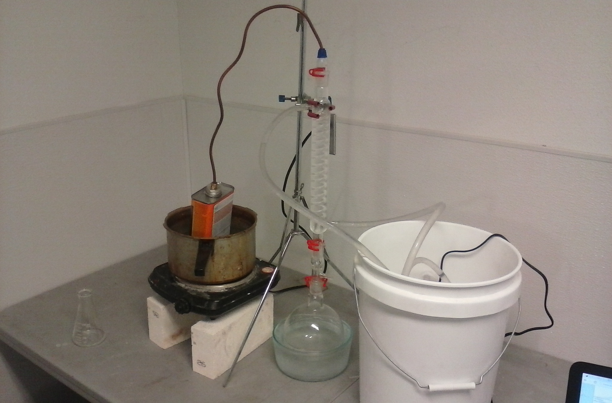

I usually use boiling water to get DCM out of the bottle.
Db33
Posts: 206
Registered: 25-11-2016
the method JJay uses is exactly what i used except i actually fixed a 24/40 distilation adapter on top of the stripper can and led to a condenser and
used hot water.
