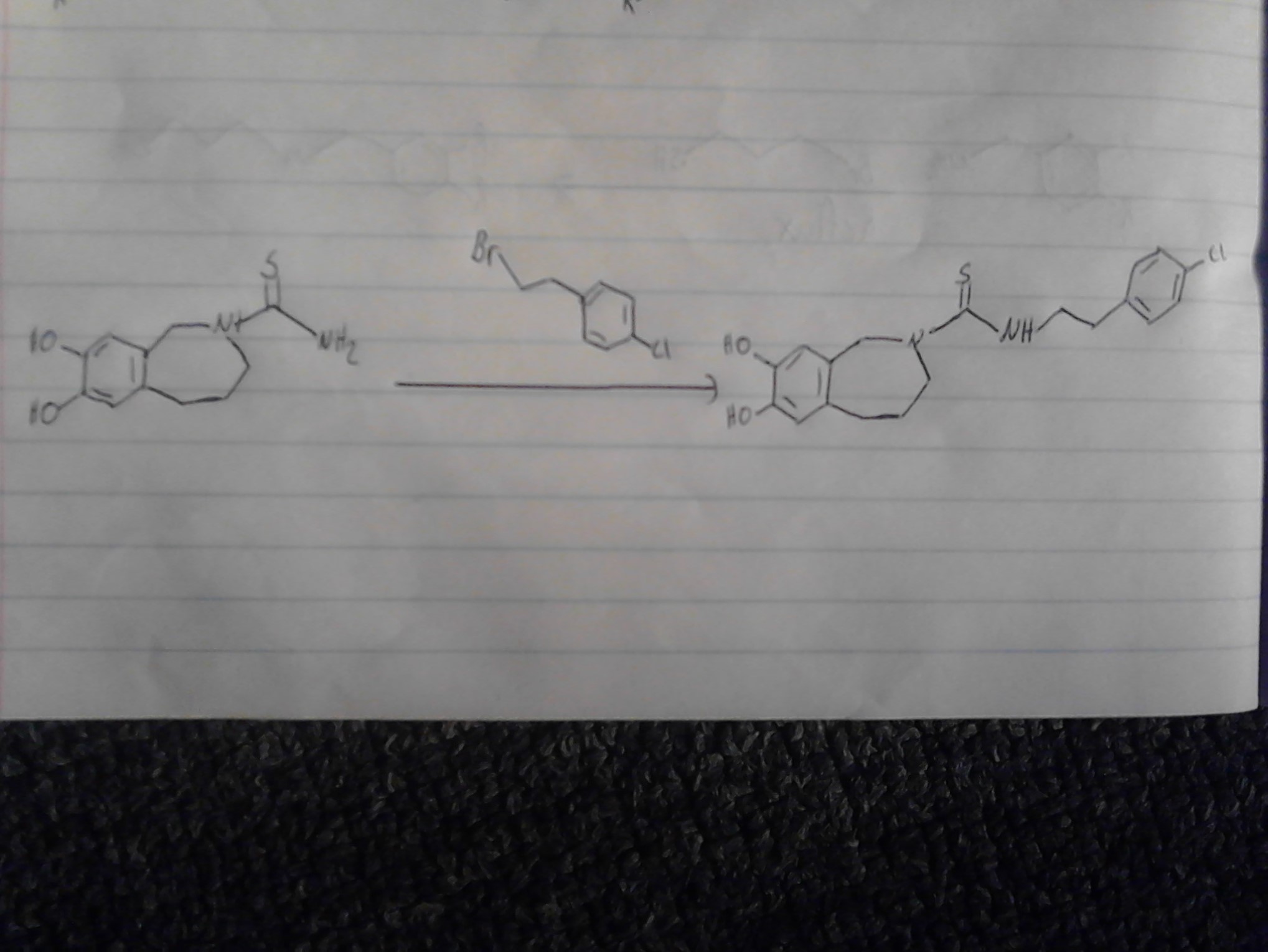

Alice this might help
I was having issues uploading the photos from my camera, for some reason they registered as being to big but i have managed do this using my phone so apologies for the bad quality, also I don't have much light so they arn't the easiest to read.
This is my origional idea however i haven't drawed out the route to the p-chloro-phenyl-2-bromoethane.
I skipped drawing out the reduction of the nitro group and the deprotection/demethylation of the diol.
I will try drawing out the route suggested by CuReUS soon.
Again given recent posts this method wont work, however it may work if we were to replace the grignard between the bromobenzene and 2-bromo-nitroethane with possibly a mannich reaction between catechol ammonia and formaldehyde however im not sure if this would be specific enough to just alkalate the desired position and we may end up with 2,3-dihydroxy-phenylmethylamine as a side product.
IMG_20170507_142906.jpg - 312kB IMG_20170507_143906.jpg - 258kB capsazepine.jpg - 237kB IMG_20170507_144356.jpg - 274kB IMG_20170507_144927.jpg - 177kB capsazepine Final.jpg - 263kB

Assured Fish, thanks for the pics. Now as you can see, in the second pic, there is a carbon vanishing. :D
For drawing such schemes, either use the chemdraw trial version or the ChemSketch freeware.
For the bromination, NBS is not OTC, but as this is an activated arene there is a vast number of halogeation reactions available. Br2 being one of them or just in situ generated Br2.
As for the deprotonation, is the grignard able to deprotonate due to the close proximity of the electron withdrawing nitro, i know their are examples of condensation between halo arenes and halo alkanes but im not sure about their limitations.
Yes, either there is a concerted elimination of HBr or the negative charge is resonance-stabilized by the nitro group before elimination happens. See Henry reaction where deprotonation is intended in order to generate a nucleophile. Bromonitromethane won't solve the problem either as it's deprotonated too.
For the next step the reagent you suggest is 3-bromopropane-1-thiol. This will also react with itself and reacts twice with the benzylamine, as such a reaction would be performed with an auxiliary base, otherwise HBr formed blocks benzylamine for further reaction or may deprotect the phenolic groups. A short search reveals for such reagents the thiol is often protected as thioacetate.
For the other routes, CS2 isn't the only problem. For the other reactions stuff like phosgene, diborane, TiCl4, ethyl chloroformate, NaN3, POCl3, trichloroacetic anhydride, and TEMPO are required. Reagents difficult to make or pretty much dangerous to handle. This is hardly pratical and for being OTC something more straight forward and easier would be nice.
Additionally, the most crucial part for all of these reactions isn't the reactions themselfes or the various reagent preparations, but how to purify the products and how to make sure the compounds are the compounds intended. I count about 10-11 transformations not including the reagent preparations. :D

[*] posted on 8-5-2017 at 21:53
Aaaaaand im late to the party.
The following scheme is what I think was origionally proposed by CuReUS starting from safrole or eugenol, however i am a little confused as to how you intended to use a modified schmidt reaction on the ketone/amide, i thought we would just want to reduce this completely using NaBH4 or LAH to get the benzazepine ring.
benzazepine.png - 13kB capsazepine synthesis.jpg.png - 19kB
The formation of the benzazepine ring was taken from this reference that was sent to me from CuReUS. http://pubs.acs.org/doi/abs/10.1021/jm00039a006
Fenclonine to nitrile. http://www.sciencemadness.org/talk/viewthread.php?tid=32534
And his reference for the deprotection of the diol for which i don't have access to. http://pubs.acs.org/doi/abs/10.1021/jo9910740
I have a modification though for which i have not drawn out unfortunately.
Instead of forming the isothiocyanate from the amine using CS2 we could instead opt to convert the amine to an isonitrile using chloroform and a base which would be about as OTC as you get:
CHCl3 + NaOH/KOH -----> CCl2 + R-NH2 -----> R-NC
The isonitrile could then be reacted with sulfur like in the following reference:
http://www.organic-chemistry.org/abstracts/lit4/754.shtm
This would mean that we could do away with the CS2 and instead opt for an OTC approach using sulfur, chloroform and KOH to bridge the p-chlorophenethylamine and benzazepine forming the thiourea bridge.
:D
Man,your compound seriously heated up this thread:D
Brilliant drawing,but you have messed up a few steps:(
1.In the 2nd step,the acid undergoes an intramolecular FC acylation using TCAA to form the ketone
2.Then the modified schimdt is done on the ketone using HCl/NaN3 to get the cyclic amide(lactam)
3.Finally,the lactam is reduced to benzazepine using LAH
As for the right half-
1.I just realized now that there is no need to convert fenclonine to the nitrile and then reduce it,it can be directly decarboxylated to the amine
https://erowid.org/archive/rhodium/chemistry/tryptophan.html
http://www.sciencemadness.org/talk/viewthread.php?tid=8574
2.The safrole is deprotected before the coupling,following atara's recommendation.
3. As I mentioned above,acetonitrile is used as the solvent in the coupling step,not toulene. Did you have any reason for using the latter ;) ?
from the ease with which you suggest making isonitrile,its obvious that you have never worked with them.I suggest you don't,they stink to high heavens and they are extremely toxic(I got poisoned from just one whiff the first time I made them:()
