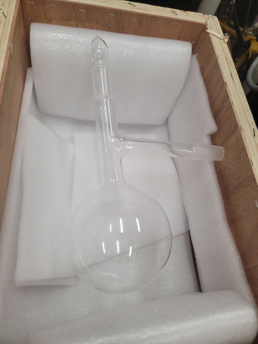

[*] posted on 4-11-2022 at 10:09
The 1L quartz distillation flask arrived! Wow, the quality is top notch. It arrived packaged in a mini-shipping crate, so it could probably survive quite a tumble in transit.
