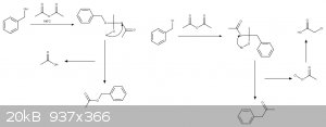

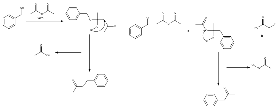

Putting 1 mole of benzyl chloride with 1 mole of acetic anhydride is the mechanism of the reaction in the picture right?
If they are wrong what is the mechanism of the reaction? And what products?
And the reaction of benzyl alcohol and anhydrous acetic acid are right?

The reaction between benzyl alcohol and acetic anhydride is correct. This reaction is a well-known reaction called an esterification, with the
products of this reaction benzyl acetate and acetic acid.
The second reaction is a bit confusing. The more seasoned members of this forum should probably explain it.

To answer your question though, the reaction between benzyl chloride and acetic anhydride does not take place under normal refluxing conditions.

The second reaction is not just suspicious. It makes no sense! Somehow benzyl chloride has to add across carbonyl just like benzyl magnesium chloride
or other metaloorganic benzyl reagent. Formation of O-Cl bond is really unfavoured thermodynamically. And there is no sensible mechanism
(polar/radical/electron transfer/electrocyclic/whatever) as theese steps omit potentailly quite a lot of stuff that may happen in between them.
That makes more sense, as such reaction maybe could work via reduction of benzyl chloride to chloride and short-lived benzyl anions, which would
add to acetic anhydrides carbonyl. They even mention adding metal complexes which would complex/bind/do whatever (call it however you want,
metalloorganic bond will be temporarily formed) with benzyl anions and make them more stable and improve their ability to add to carbonyl groups. The
mechanism is, however, drastically different from what OP proposes.
