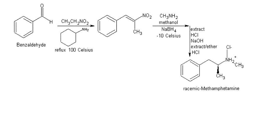

By the way @Melgar, could you explain to me why sodium borohydride alone can reduce phenyl nitropropene with methylamine directly to metamphetamine in a kind of reductive amination?
I read about an experiment like this on this book:
A Laboratory History of Narcotics
Vol. 1: Amphetamines and derivatives
A Laboratory Manual - 2007 - page nº 111
Jared B. Ledgard
But I can't explain why this can go on, since I ever thought borohydrides alone only reduce the double bond of the alkene to an alkane, but not the nitro group.
Could you or someone here explain to me the mechanisms envolved in this reaction below showed on that book? Is it possible?

@ChemiPharma Sodium borohydride can only reduce double bonds that are sufficiently polarized by the groups on either side of it. For most alkenes, this isn't the case, but if, say, there's a strongly electron-withdrawing group on one side and not the other, that will be enough for borohydride to be able to align itself right to reduce it. Sodium borohydride can reduce imines for the same reason it can reduce aldehydes and ketones: because nitrogen (like oxygen) is more electronegative than carbon, and sodium borohydride is good at reducing double bonds to carbon when the carbon is double-bonded to something more electronegative than itself.
Sort of a simplified explanation, but it helps to realize that when sodium borohydride reduces double bonds in imines and nitroalkenes, it's really the same mechanism as when it reduces aldehydes and ketones.
Oh, also, you'll have to quote someone more authoritative than that notorious idiot if you want anyone here to believe that the reaction you describe is real.

[*] posted on 24-10-2017 at 03:08
Sorry @Melgar, but I didn't understand the last part.
This reaction was extracted from a published book.
Do You believe that's impossible to occurs? The author is a fraud? yes or not? why?
Here's the complete text at the book I have cited, on pages 111/113:
Nitroalkenes and redutive amination with methylamine and borohydride.JPG - 25kB
