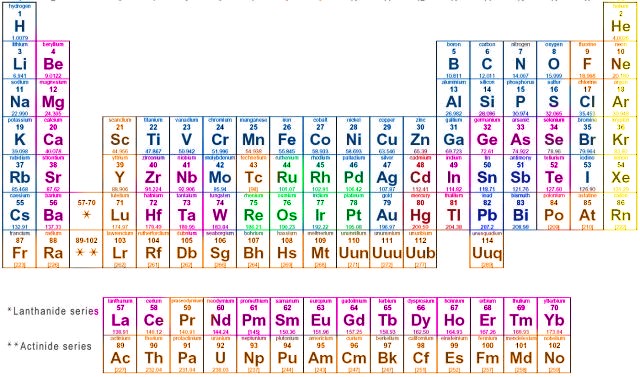

[*] posted on 7-8-2018 at 18:30
Acually your right
There is alot isolated who would have thought
Ceasium. potassium and phosphorous
Here is a periodic table of whats been isolated
The blue is ones that have been isolated
The purple is ones that can be isolated
The orange is radioactive
The Red is dangerous
ChangeColor_7-8-2018-7-0-4.jpg - 88kB
Fluorine could be proven isolated by making a fluorocarbon by electrolysis producing HF and F in situ
[Edited on 8-8-2018 by symboom]
