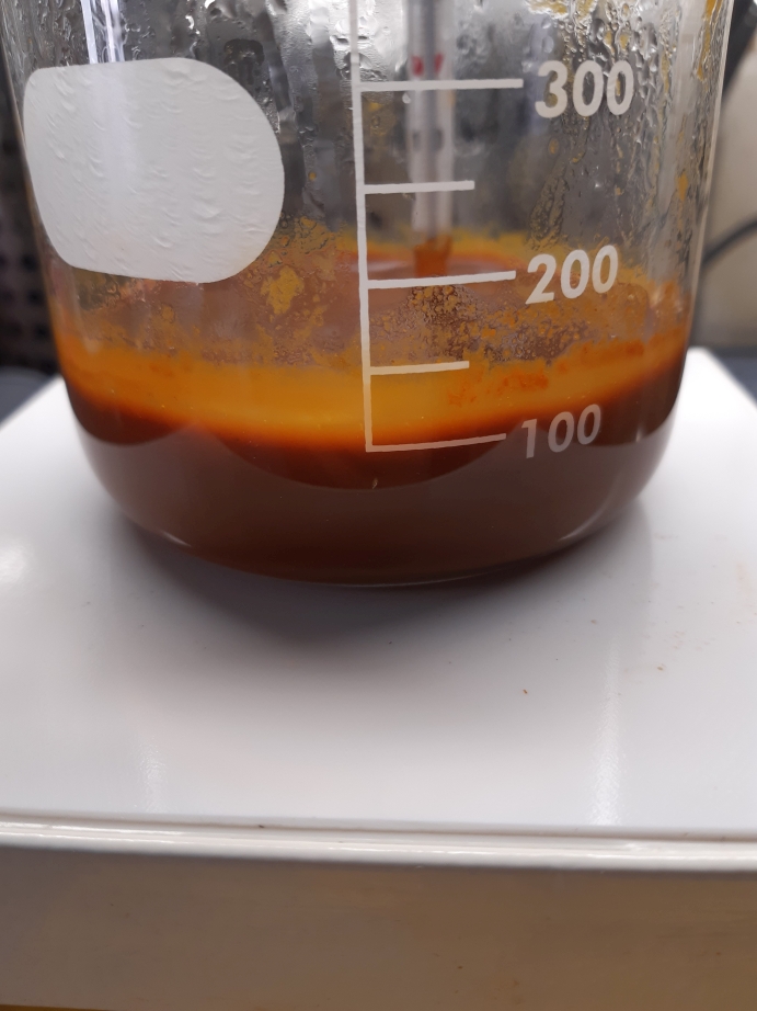

Advice from someone who has successfully prepared crystalline DBX-1
I have prepared DBX-1 according to Fronabarger twice, with similar results. I have no doubt about the nature of the product, which deflagrates on
contact with flame and detonates on heat or under light confinement. On the other hand, I observe that the product, when dried on a filter, appears as
lumps, which leave a fine sticky dust on the finger when touched. Under the microscope, this powder appears amorphous. Moreover, its density is low,
and even under high pressure it is difficult to reduce its volume: for the same weight, it is 4 to 5 times more voluminous when pressed than AgN3 for
example. Also, I wonder if I missed the crystallisation step: according to Fronabarger, at about one third of the addition of the ascorbate, the
product starts to precipitate and the solution takes on a rusty colour within a few minutes. I have observed these changes, but still my DBX-1 appears
amorphous, and in this form I do not see how it could replace Pb(N3)2 according to the drop-in replacement principle.
Also, I would be interested in having someone who has obtained DBX-1 in crystalline form look at the attached photos to tell me if any differ from
their own experience. Thank you!
(sorry, the pictures are in reverse order)
(the microscope pics are 1 mm in lenth)
[Edited on 11-5-21 by pdb]

From my experience making DBX-1, I'll get a near identical amorphous brown sludge most every time I run from scratch. The sludge dries into chunks
just like yours that are flame sensitive and detonate when confined and heated. However, I have never been able to get this first product to detonate
confined with a fuse, even as a powder.
What I've found and and have yet to publish in a video is that when I've taken a small amount (~2-3 grams) of this amorphous product and fed it into a
repeated synthesis from scratch, the impure DBX-1 present in the first product catalyzes the formation of much more visible DBX-1 crystals that are
red rather than brown. Additionally, it appears much less gelatinous sludge remains intermixed with the product in this case.
Hope this helps.

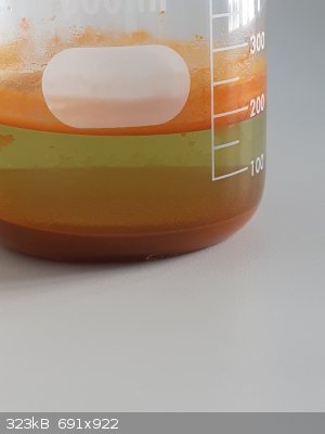

Hi guys, if you're following DBX labs (ReactiveChem) procedure with NaNO2+H2SO4, make sure to keep your temps within +5c of specified temperature (65
degrees) or you're gonna get some micro detonations and have a scary time.
First one scared the hell out of me. Thought my Chinaware was preparing to shatter, did a quick recon and just about the time I put the pieces
together and realized what was happening the SECOND one happened. This occurred with the following setup:
Solution 1:
2g 5-ATZ
1.36mL H2SO4 (93%)
10mL Water
Solution 2 (to be added to solution 1):
5.68g NaNO2
20mL Distilled Water
Temperature was about 72 degrees when I did maybe the fifth 1.5mL addition of solution 2 into solution 1. Being done on a round bottom flash inside of
my stirring heating mantle.
edit: was also blowing air into reaction flask to help clear evolved NO2. Maybe that contributed to the micro detonations
[Edited on 12-2-2022 by FanofYellow]

I only just read this first post properly. You should not get detonations with this reaction, nor should it be so touchy within 5C of the recommended
temperature. You should have added the ATZ solution to the nitrite, not the other way around, that is your problem.
