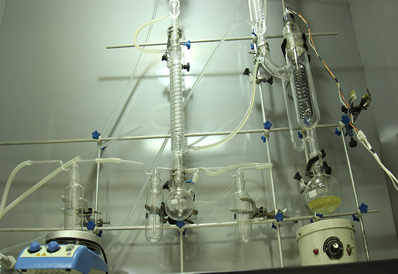

[*] posted on 30-12-2015 at 17:48
I want to congratulate Praxichys on his construction of an ingeniously simple ketene lamp and successful synthesis of acetic anhydride using this lamp. This can be seen at Doug's Lab on YouTube.

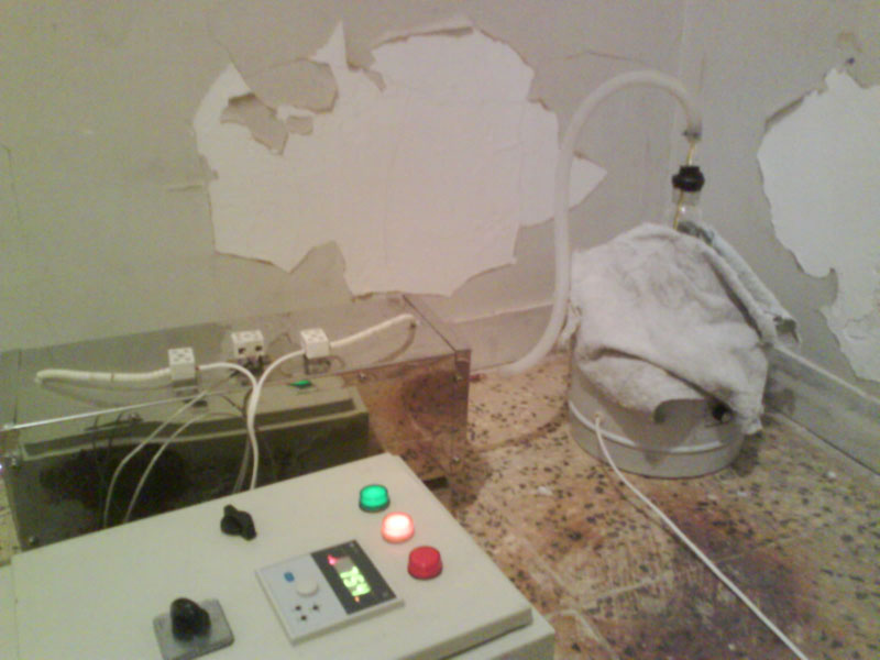

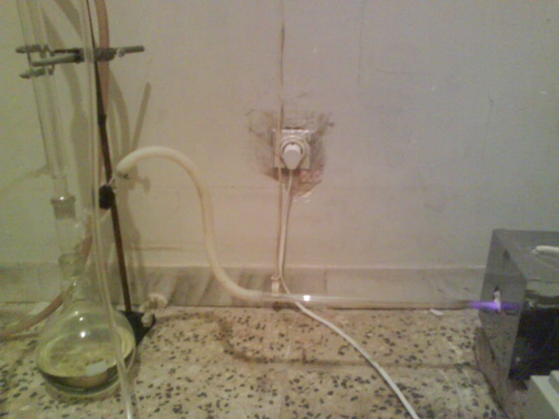

[*] posted on 4-1-2016 at 11:15
My old Facilities for making Keten by Furnace (6 years ago):
1.jpg - 88kB
2.jpg - 88kB
3.jpg - 103kB
And now by keten lamp(in my lab):
4.jpg - 403kB
[Edited on 4-1-2016 by Waffles SS]

[*] posted on 4-1-2016 at 11:50
@ Magpie: Thank you! I'm working on an article for prepublication to commit it to the annals of SM.
@ Waffles: Wow, that is a proper ketene lamp. What are you using for the heating element? I like how you used a schlenk flask with a septum for the acetone reservoir, probably so you can inject more acetone while it's running? Very nice!

[*] posted on 5-1-2016 at 09:34
Thanks Praxichys,
I used 2.5mm diameter Ni/Cr wire and i built this system according to Vogel Keten lab instruction.(Vol.3,p372-373)

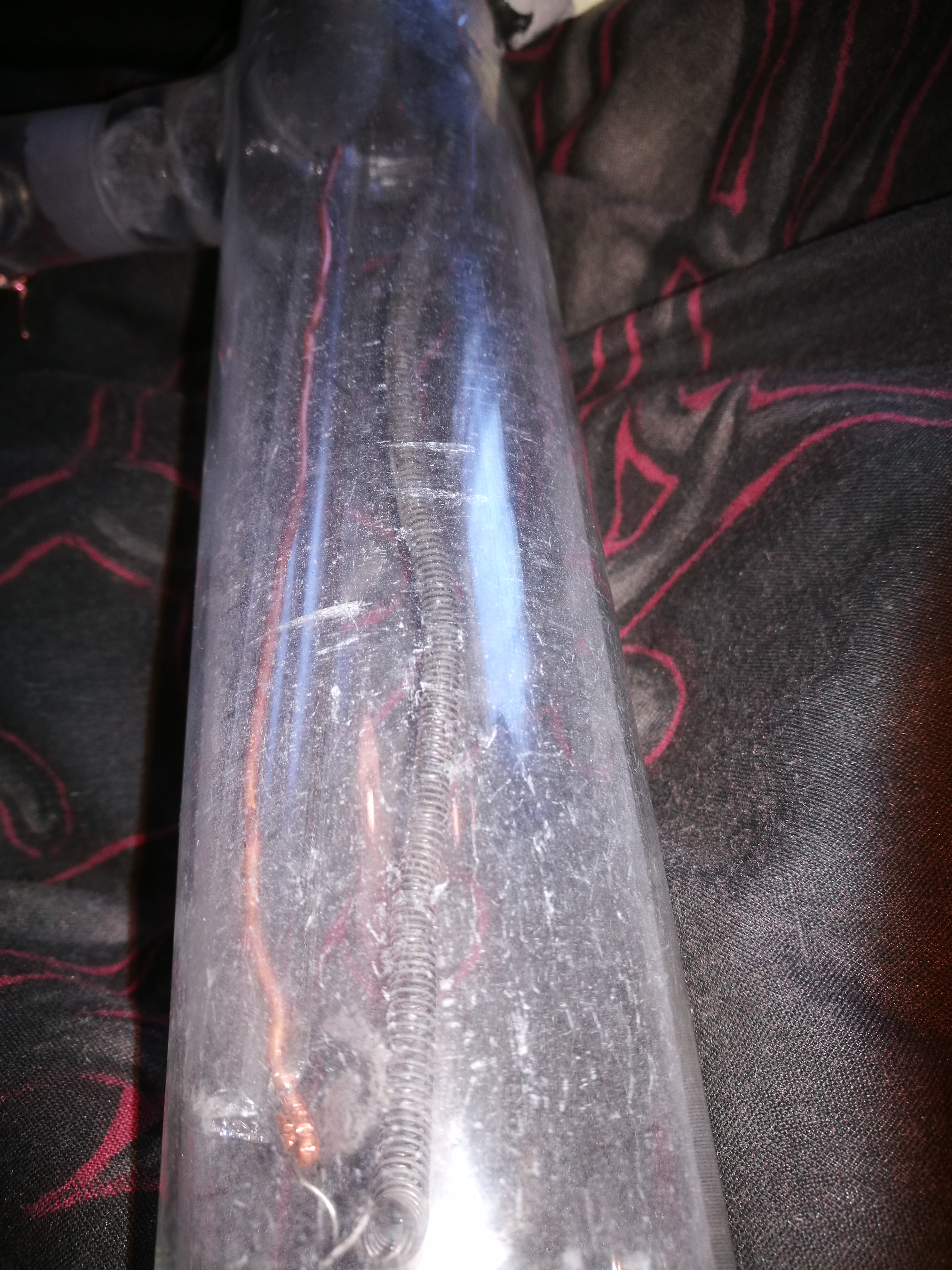

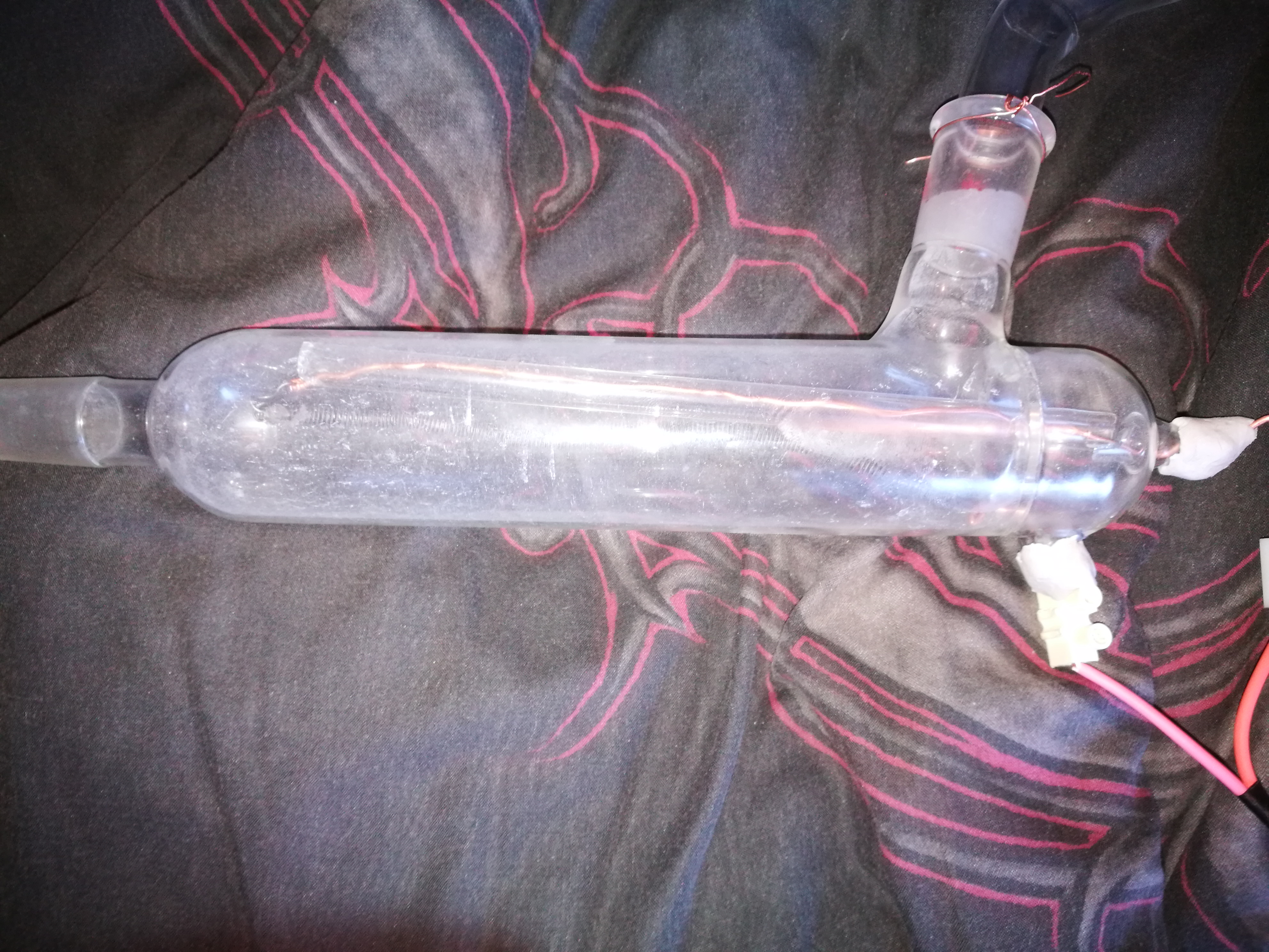

[*] posted on 27-10-2017 at 06:17
Can anyone tell me what to do if I was to be using a ketene lamp setup identical to Praxichys video on youtube and finding it hard to get the sweet spot between no ketene being made and white smoke filling the rbf trap for byproducts etc and going through to the gaa absorbtion tube. I assume this smoke is not good but cant seem to find a voltage setting that will produce enough bubbles to do anything but not create this white smoke.
Any ideas? I had it running for 3 hours the other day and only ended up with approx 10 mls of product after fractionating.
NZniceguy
Posts: 48
Registered: 16-9-2017
[*] posted on 1-11-2017 at 17:23
New lamp
Well I went to fire it up again and have noticed a crack starting at the bottom of the chratography reservoir.......the wire element was too close to the glass and thermal expansion etc.....so I was stuck until another arrives in a week or two until I looked over at a friedrichs condenser that arrived with the inner finger broken off by customs (arseholes!).....I figured if I could hollow out all the inner workings then I could feed the two wires for the coil down the old water nipples and epoxy the holes shut.....can always pick it out if need be. I'll attach some pics but unfortunately you cant see through the glass very well as it got etched as I hollowed out the inner workings. What do you think?
[Edited on 2-11-2017 by NZniceguy]
IMG_20171102_140952.jpg - 3.8MBIMG_20171102_141004.jpg - 3.8MB

[*] posted on 2-11-2017 at 03:11
Looks promising. What about a glass wool lining to protect the tube from the hot filament?
Glass certainly has it's problems dealing with high temperatures. I've been thinking about constructing an all-metal reactor lately to avoid such problems entirely. The thought of ketene and acetone vapor in the case of a failure isn't all that inviting.
One thing confuses me though. In a document I found (564 Schmidlin Ketene Synthesis, can't remember from where) they claim "this reaction cannot be conducted through a metal tube, either a copper tube or an iron pipe because carbon may form via dehydrogenation in the presence of some metal oxides." Yet the standard ketene lamp uses hot metal wire. Or is this avoidable by careful temperature control?
Except for the hot zone most metals should be compatible, right?

NZniceguy.....you've got far too much wire coiled up in there...odds are that you are over cooking everything...you want a dull red heat, that is, in a dimly lit room you can barely just see a deep red glow coming off that wire...have you got a infra red type thermometer ? I'm not sure how accurate those are, but it might help you get the temp dialed in. I had a similar problem to this in another pyrolytic process, and I was getting this white mist condensate..long story short too high on the temp....You might want to rip out that coil and try using only like a quarter of that amount of wire, the whole thing is just over kill...trust me on this...my fellow kiwi...
[*] posted on 28-12-2017 at 20:48
Be careful...if you take out wire without lowering the voltage you will actually increase the temperature. For a wonderful ketene lamp see Doug's Lab YouTube video.

[*] posted on 2-1-2018 at 20:01
Thanks for that info, that lamp ended up cracking after the 2nd use so I went back to the 250ml chromatography reservoir ala the Dougs Lab video but maybe I still have too much heat as its still not dialed in quite right...I also tried putting the acetone/byproducts trap in an icebath to try stop any acetone coming over into the G.A.A. I havnt tried it in a week or so but must try again sometime soon..........the voltage doesnt matter as im running it on a motor speed controller and just crank it up till I get bubbles coming through the g.a.a. but it does seem like the element is redder than in the video and as you describe but any lower and i lose the bubbles/ketene (checked for leaks also).......Ive tried an infra red thermometer but it doesnt seem to work through the glass damnit!

[*] posted on 24-8-2018 at 05:41
The colour and brightness of glowing elements tends to be incorrect on images and video. I suggest you use the eye ball method suggested by the previous poster. But if you lower the temperature and get no bubbles I guess you must have it about correct or you have an other problem.
