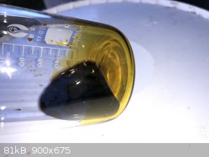

Maybe they ran out of Mo powder and switched it up. Late last year I bought the exact same thing from this selller and it checked out to be Molybdenum. The powder was a dark grey nearly black and slowly dissolved into 31% HCl leaving a dark yellow greenish solution. Adding NaOH to that gave a black precipitation. Pretty sure I got the real deal. I had also bought Co, Cu, Ti and B powders from them with no problems. I probably won’t try my luck at eBay Ir powder though. Seems like others here have been ripped off with that. I guess it’s a roulette game.
As a check, for both of us you could try dissolving excess Mo in H2O2 to see if it eventually turns blue. If the reaction is very vigorous with powder you may have to cool the reaction tube to avoid thermal decomposition the H2O2.
I’ll try this this afternoon and post the results. I have some 35% H2O2 I recently acquired that will work fine. As for the HCl dissolving I did, only a very small amount of the powder I put in there dissolved and it took quite some time to do it. Here’s a picture I took at the time.

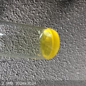

Here’s the test I did on the supposed Mo powder. I added a small amount of 35% H2O2 to a test tube and added some of the metal to it. Immediately there was a very exothermic reaction which turned the solution a dirty green first then into yellow. Slowly I added more metal and after a short while the colour did turn to a brilliant blue much like Prussian blue.

Thanks NeonPulse. That test confirms my observations about the reaction between H2O2 and Mo to produce the yellow MoO3 which can then be partially reduced by excess Mo to the intensely blue coloured mixed valencE oxide called blue Mo.
Is your blue Mo reoxidised back to MoO3 by air or H2O2?
I don’t have any W powder to check if W reacts so readily as Mo and produces the equivalent blue W. If that is the case we need a simple method to discriminate between Mo and W. Perhaps say Cu metal or an organic compound can reduce one of the trioxides to a blue but not the other.
Thinking about it I have some small filament bulbs I could extract the W filament from one to try to make blue W. I also wonder if a mixed Mo/W blue can be synthesised and if it has any novel properties.

W is very slow to react with H2O2. i digest thoriated W electrodes in H2O2 and it takes ages. you get a pale yellow solution

MoO3 is not yellow. Pure MoO3 is white (or very pale grey). The yellow color of hexavalent molybdenum in solution usually is due to some complex (e.g. with phosphate).
W slowly dissolves in aqueous H2O2. No acid needed, nor any other compounds, just H2O2 in water. The solution is nearly colorless.
