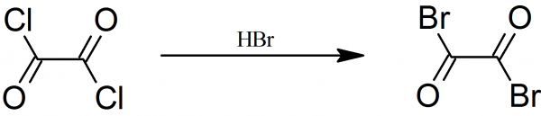

if this reaction is reversible, first oxalic acid could be treated with bromine (which can be made from pool sanitizer sodium bromide), getting oxalyl bromide. Then it could be treated with hydrogen chloride gas, yielding oxalyl chloride.
[Edited on 8-6-2021 by BauArf56]

Liquid bromine and Oxalic acid react to form hypobromic acid, carbon monoxide and carbon dioxide. Hypobromic acid reacts with oxalic acid to form hydrogen bromide, water, and CO2

[*] posted on 8-6-2021 at 02:32
forgot that bromine is an oxidiser! How about using hydrogen bromide instead of bromine? HBr could be made in situ with sulfuric acid and sodium bromide

This thread doesn't need more random guesses from people who didn't bother to study the problem at all. HBr will not brominate any carboxylic acid, much less oxalic.
