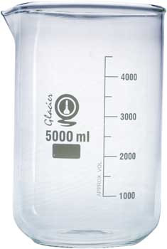

[*] posted on 25-5-2018 at 13:02
The beaker was like this one, but ofc not the same brand
https://www.wiltronics.com.au/wp-content/uploads/images/scie...
It actually clearly cracked at the bottom all around separating the bottom from the beaker becoming hollow like a pipe. Hopefully i was doing it outside and i din ton use any electric source :o. It had never before fall down or anything. I thing it was my 1st time doing it with this beaker and i don't remember to have used it again on heat, i bought it for that specific reason. It was almost full, like 3L of liquid inside. I was thinking if clay beaker would be better.
[Edited on 25-5-2018 by underground]

The usual recommedation for a flask is to heat atleast up to the top of the liquid.
Yea but it cracket at the bottom, not at the middle or smthing like that, it cracked exactly at the point where it was heated, at the very bottom

Yes because you did not heat the sides.
