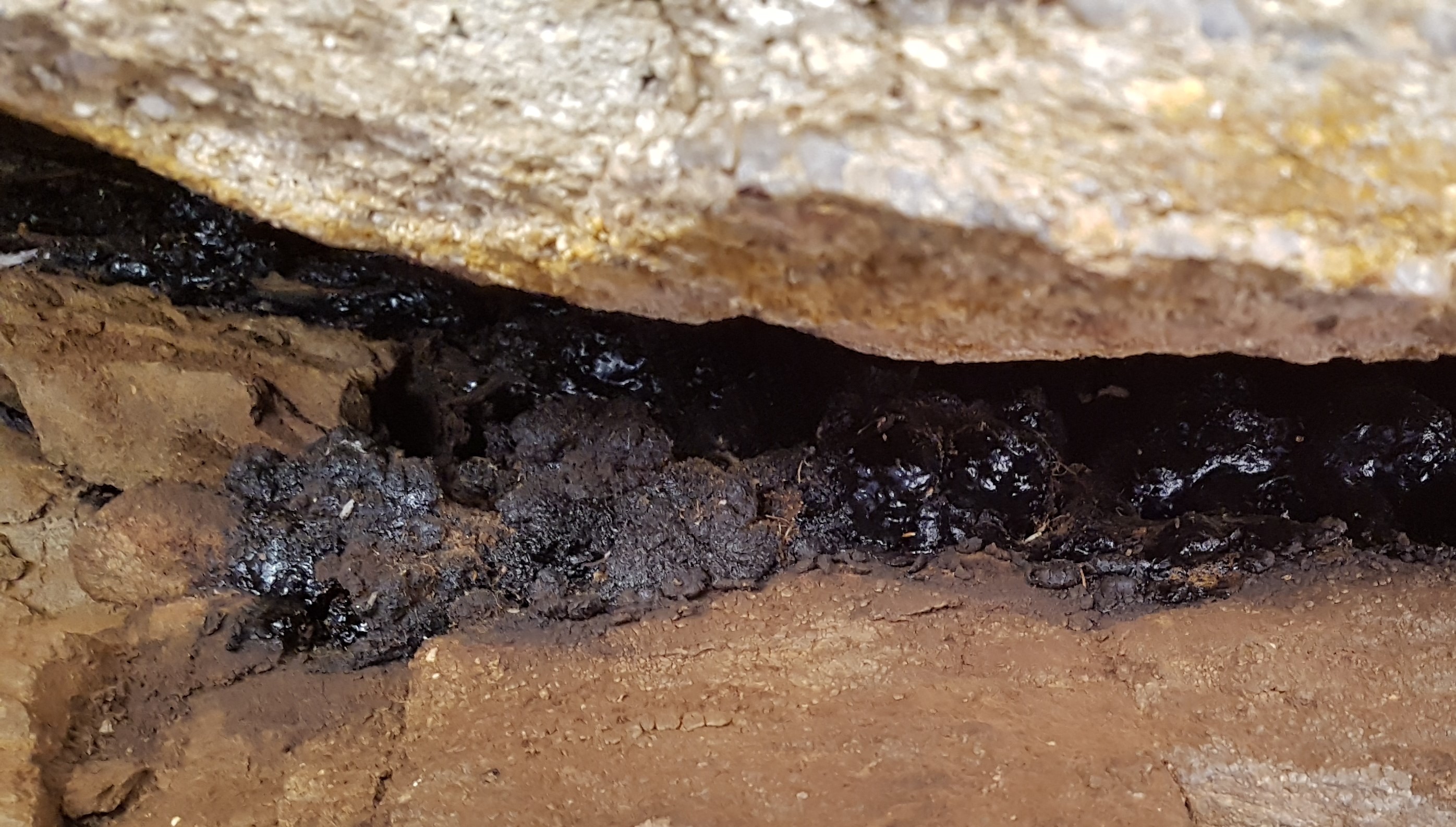

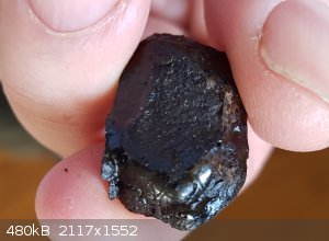

One observation that I think is interesting and likely a biochemical oddity is the presence of a black, bituminous, hard often lustrous material that occurs on the roofs of shallow caves that occur in weathering granite escarpments that we locally call "break-aways". The material has a sharp tarry-like "animal" smell, not unlike under the grated floor of a woolshed (sheep), but different…
There is not a lot written on this material (I can find), but it has been called "dung bitumen" or "psedubitumen". It likely forms as a result of water percolating through bat and other animal dung and due to dry conditions accumulates as a solid mass over time rather than washing away (sort of dung flavoured stalactites).

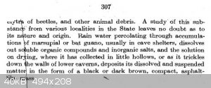

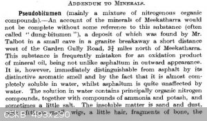

The substance is discussed in a few old West Australian Mining reports with a 1905 Western Australia Department of Mines report presenting a single chemical analysis (see attached). Briefly it contained 44% organics and was quite soluble in water. It quotes a lowish nitrogen percent, but I think this of the residue left after a LOI. The high Fe and SiO2 likely associated with the Fe-rich country rock. This report is downloadable below:
http://www.dmp.wa.gov.au/Documents/About-Us-Careers/AnnualRe...
Some of the compounds it may contain include: oxalates ammonium oxalate and calcium oxalate (mineral names; oximite and weddalite respectively), uric acid (mineral name: uricite) and guanine. see pp 123 in: https://library.dbca.wa.gov.au/static/FullTextFiles/071896.p...

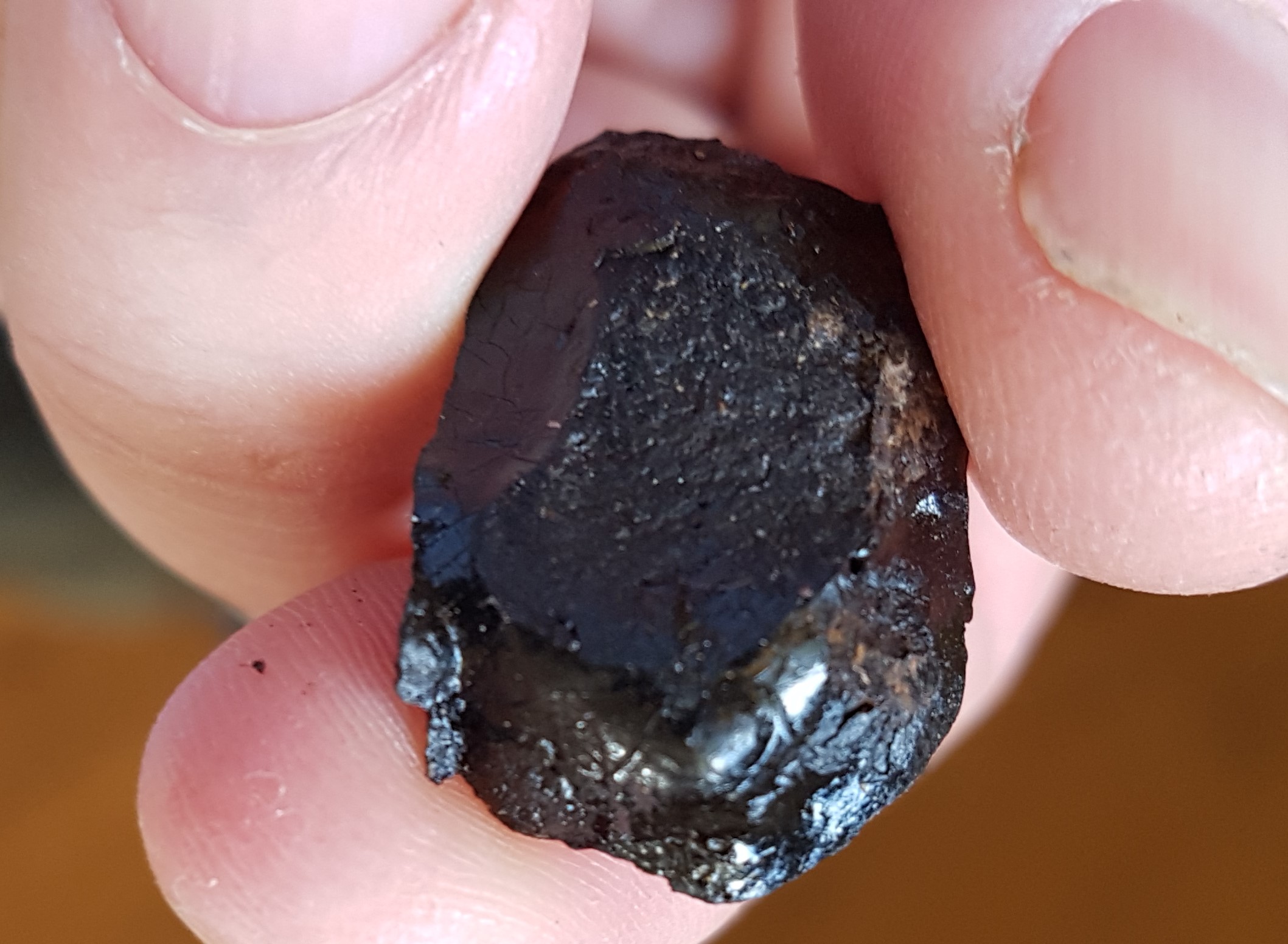

I have collected some and plan to carry out a few basic tests: I can report the following:
• It is reasonably soluble, though had to head back to work before I could see what type of crystals form (very dark brown clear liquid)
• It did not burn/melt
• Paper soaked in the solution and dried did not act like it contained nitrate when touch with flame.
Ran out of time to try other tests, though I presently have minimal reagents or glassware.
Need to research tests for guanine. Guessing a precipatate with solule iron compound will test for oxalates.
I am not presuming that this a great source of any particular reagent, but I’m able to collect a fair amount, so you never know…

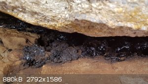

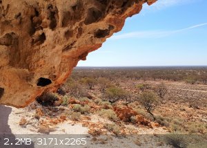

One photo is of a crack in the roof of "cave" in a breakaway showing how it likely forms in response to percolation of fluids. Alternately animals may have used the cracks to live in. The landscape photo is from the mouth of the breakaway, more for Harristotle's benefit :). Its a bit north of Meeka.

Well it does look like the same material. Trouble is, the photo you linked to looks like a horizontal platform, where the rodent could obviously sit, chew and poo, the picture I showed is of a narrow vertical crack well off the ground.
