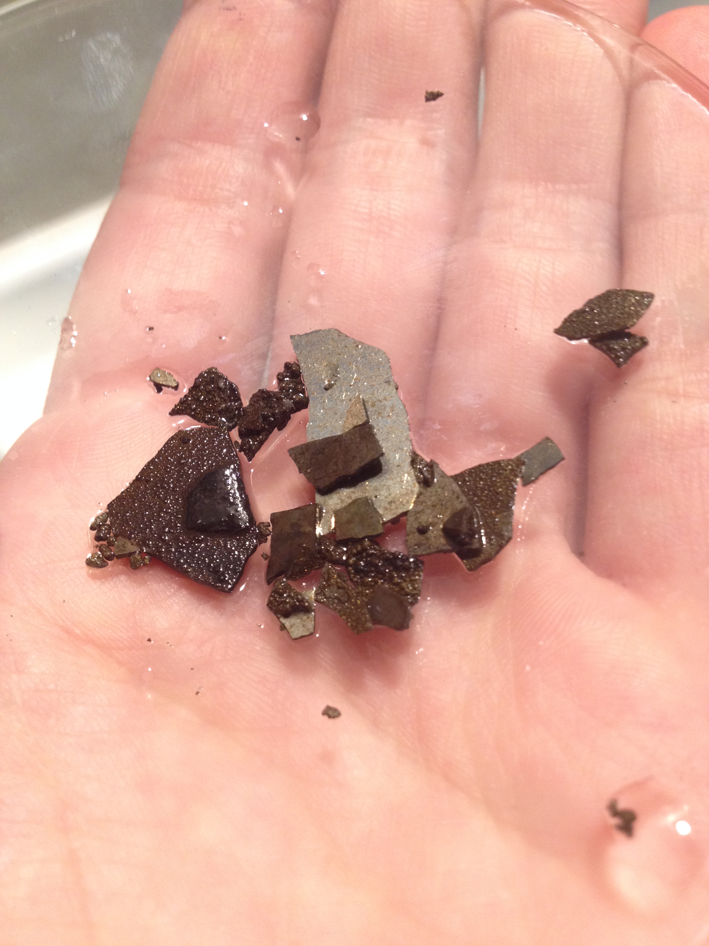

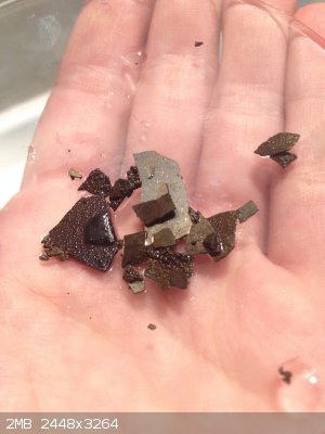

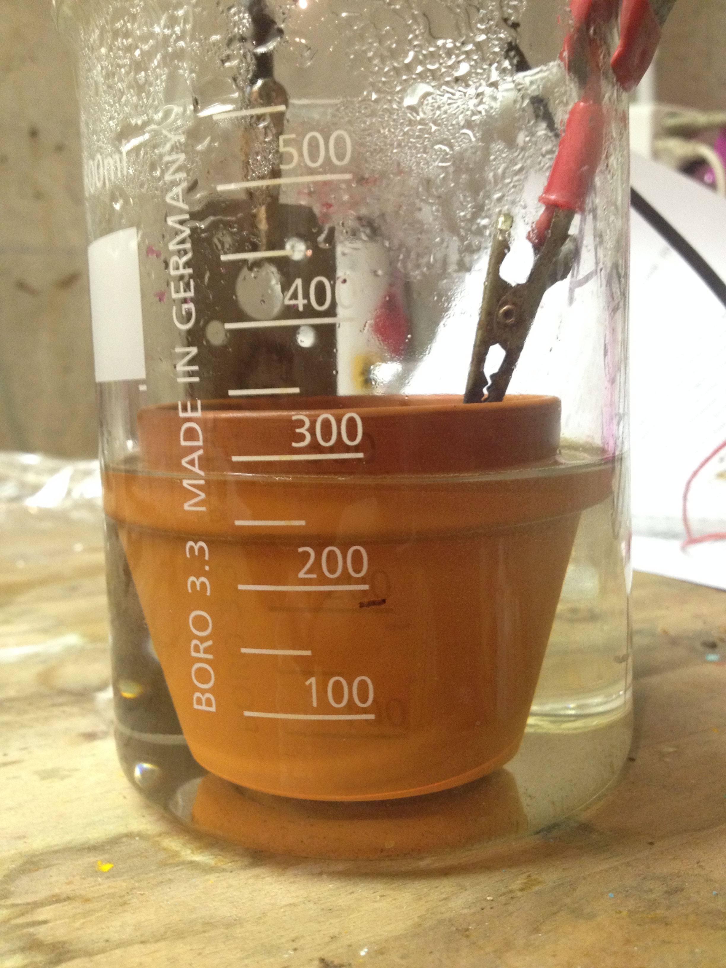

KMnO4 from manganese metal electrodes: A paper and my results.
While looking for a method to prepare permanganates, I came across a paper from 1921 titled "The Electrolytic Production of Sodium and Potassium Permanganates from Ferromanganese", by Wilson et al.. I could get the full-text access with my uni library account and found very interesting information.
I'll just give the main points of the paper and technical details that are relevant for those who want to try it. And then I'll outline my two runs with a similar setup and the results I got.
The paper
On the electrolytic cell the authors say:
"The electrolyses were carried
out in a cell which consisted of a cylindrical glass jar (12.5
cm. in diameter by 15 cm. high), containing within it a
porous porcelain cup (5 em. in diameter by 12.5 em. high)
which served as a diaphragm. In this cell were placed the
two electrodes, the cathode (of 16-gage sheet iron, 3 em. by
15 em.) being within the cup, and the ferromanganese anode
standing in the jar outside, and about 3 em. away from
the cup. The freshly cast anodes had the dimensions 2.5
em. square by 15 em. in height. Electrical contact with the
anode was made by clamping a strip of brass, carrying a
binding post, against a freshly ground surface near the top."
On the anolyte and catholyte they used:
"It was found that the carbonate electrolyte (as compared
with the hydroxide) gives the purest product-uncon-
taminated with manganate-at the best efficiencies and for
the least expenditure of power. Hence, this electrolyte is
recommended for technical operation."
"The anolyte was 12 per cent sodium carbonate solution
(previously found to give about the optimum results), and
the catholyte was 8 per cent sodium hydroxide solution."
On anode composition:
"An experiment with spiegel iron (about 40
per cent Mn) showed practically zero yield of per-
manganate."
They state the cathode was simply iron and the current density was around 5 to 10 A/sq. dm.
In total they did 180 runs with varying conditons so this paper is just pure gold. If some of you want more of it I can paste the whole of it here (7 pages) or upload it somewhere (where?)
My two test-runs
My setup consists of a 600 ml beaker with a terracotta flower pot (acts as a porous membrane) in it. The hole of the flower pot was plugged with rubber stopper so that the flower pot can hold the anolyte without leaks
The beaker contains the catholyte. The levels of the electrolytes were adjusted to be at the same height to prevent the electrolytes from mixing.
The anode was a pile of 99.9% manganese metal flakes (ordered on OnyxMet.com. Btw they sell Mn flakes for 16 bucks/kg and ferromanganese 86% for 8 bucks/kg) that I put in the terracotta pot. Electrical contact was made with a long manganese flake touching the pile of Mn and connected to a power supply (+). I didn't use ferromanganese because I didn't have it, but it appears to work fine with pure Mn.
The cathode was a stainless steel plate.
1) The first run was done with 1M KOH in both cathode and anode compartment. A voltage of about 3V with a current of 100 to 200 mA was applied to the cell for a few hours. The catholyte stayed crystal clear with bubbles of gas being evolved at the cathode (oxygen I guess). The anolyte turned a purple color at first but within a few minutes turned instead a deep green/brownish color which indicates that potassium manganate was produced. I didn't process this batch and insted changed the composition of the anolyte:
2) The second run was done in the same conditions except:
- The anolyte used was about 10-15% Na2CO3. Catholyte was still KOH soln. because I didn't want to throw it away and thought it should have no influence on the run.
- The current supplied was about 500 mA and the voltage 5V, because I wanted to produce NaMnO4 in high enough conc. to be able to precipitate KMnO4 upon adding KCl and I don't have time to wait a week for the run to "complete". The temperature of the anolyte was about 25°C for the whole run (room temp 16°C). Total run time was about 50 hours.
The anolyte turned very dark purple and a fine mist of permanganate is produced so I used plastic wrap to contain it.
Results
Concentration: I titrated a sample of the anolyte with Mohr's salt (a stable source of Fe2+ ions) solution by dripping the anolyte into acidified mohr's salt solution until the purple colors stays. The anolyte was found to be about 0.4M in conentration with an error of say 5 or 10 % because I don't have very precise titration instruments (such as a burette).
Extraction of the permanganate
I filtered the anolyte on a GLASS filter funnel (no paper) and added conc. KCl solution to the filtrate. the undissolved solids appear to be MnO2 but I'll have to check that. The filtrate is currently evaporating at about 80°C on a hotplate with a fan blowing over it. Dark needle-like crystals appear to be forming upon cooling. I'll report back when I have separated the crystals.
I plan to do a more carefully controlled test on a 1 liter anolyte scale but I cannot go ahead right now because I don't have enough manganese left (the pieces are too small to work with) so I'll have to order some more Mn. I might try to cast a manganese metal plate.
First picture: The cell. Second picture: Mn flakes I used piled up in the flower pot.
The cell.jpg - 2.2MB Mn flakes.jpg - 2MB
Update: The crystals that formed from the evaporated anolyte are highly impure as evidenced by the presence of white crystals and brown crud among the needles of KMnO4. The crystals were dissolved in a small amount of water and the solution was heated up to boiling. It was filtered while hot on a preheated filter funnel (to remove MnO2, again). The filtrate yielded 0.37 g of small (and pure) needles of KMnO4 upon cooling.
(More KMnO4 could be extracted from the anolyte, but this run was just to prove that the method works and I didn't try to be particularly efficient in the extraction.)
The product was tested by adding a few drops of conc. H2SO4 to a crystal to form Mn2O7 and the reaction with ethanol was as expected: it ignited!
[Edited on 1-9-2016 by Romain]
