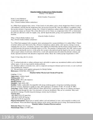

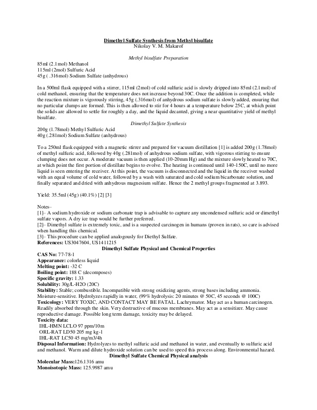

[*] posted on 8-9-2018 at 09:47
Calcium carbonate should work.
Here they do it without either calcium or barium.
https://www.slideshare.net/mobile/NikolayMasin/dimethyl-sulf...
dimethyl-sulfate-synthesis-1-638.jpg - 133kB
That's really interesting. I can't seem to download the presentation, but that procedure looks really easy. I am curious about why the reported yield is so low... but the reagents are cheap. The references given in the presentation don't seem to relate directly to the procedure. Does it work? I will say that I've found that the high yields of US 3047604 are hard to reproduce, but it does work to some extent....
