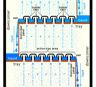

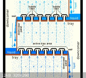

[*] posted on 28-9-2018 at 08:49
Why would the plate spacing need to be a minimum of one inch? For some reason, I highly doubt that physical plates would work out to theoretical plates exactly. I thought a plate column was more like a Snyder column...
Edit: Yes, this is a plate column. It's somewhat more complicated than a metal box with a bunch of simple baffles:

macckone
Posts: 2143
Registered: 1-3-2013
Location: Over a mile high
Mood: Electrical
[*] posted on 28-9-2018 at 09:22
Plate spacing is one inch for proper flow. cutting that in half yields a multiple for the resistance.
If you look at a chemical engineering handbook it should have the formula for resistance.
If you have a resistance of .01 atm for each plate, you will have a net pressure difference of 14.7 psi
from bottom to top with 100 plates. In commercial towers they actually make use of the pressure difference
and it is higher, but in a home environment that is a lot of pressure. You probably want less than .01 psi
pressure per plate. That would give 1 psi with 100 plates.
The theoretical plate is actually if you achieved 100% mixing of vapor and liquid at each stage with no heat loss.
The wiki article has a good explanation. But you are correct it will be less than one theoretical plate per plate.
https://en.wikipedia.org/wiki/Theoretical_plate
The bubble-cap plate as illustrated in the article provides close to the maximum theoretical. In that article they have a plate spacing 60 CM (24 in). That is for very high throughput. In the bubble-cap design the retention depth of the weir and the submersion of the bubble-caps determine the spacing and the pressure. One inch of submerssion on the bubble cap is about .03 psi which is 1.5 psi for a 50 plate tower which would exceed 100 ft.
In practice the bubble caps have more submerssion on industrial columns.
For a home rig you might consider off the shelf. This stuff exists.
https://moonshine-still.co/products/4-bubble-plate1?gclid=Cj...
Obviously you can make your own cheaper.
Honestly a three foot x 1" column with ring packing and 10x reflux
will separate azeotropic alcohol from 50%. The only complaint is backpressure is high.
a 2" column would be better.
