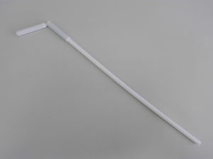

A PTFE stir bar retriever with a cylindrical stir bar
A stir bar retriever or simply stir retriever is a rod-shaped lab item used to recover stir bars from flasks or reaction solution, without contaminating the latter.
General
A stir bar retriever consists of a PTFE long rod about 20-30 cm or longer, which has a thicker end, where a magnet exists, also covered in PTFE. Some models may have a small ring at the other end, which allows the retriever to be hung on a nail or a wire.
