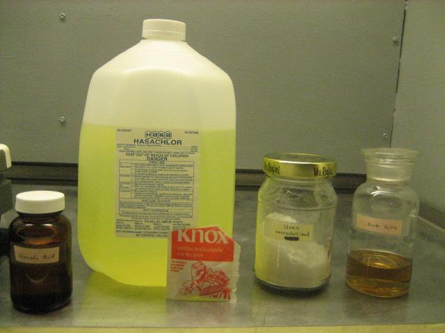

This is a scaled down (18.7%) version of the improved procedure posted by Mr Anonymous (Rosco Bodine) on SM on 6/7/03. Some improvements by garage chemist (SM post on 5/19/07) were also incorporated.
A. Reagents
355 mL of 10wt% NaOCl solution (0.55 mole)
47.8g of NaOH (1.20 mole)
34.1g of urea (0.57 mole)
0.47g gelatine
122 mL of 31% HCl (1.18 mole)
37.5mL of conc (92%) H2SO4 (0.64 mole)
30mL of 70% isopropyl alcohol
15mL of anhydrous isopropyl alcohol
water

reagents for hydrazine.JPG - 39kB hydrazine rx near endpoint.JPG - 36kB neutralization using HCl.JPG - 35kB

I have resurrected my numbers and now see where I got them. I basically just used the numbers that GC had for his reduced scale batch as he posted in his "Improvement" on 5/19/07 in the "Hydrazine" thread, p.8, since he said he had "great success." Here his basis is 0.45 mole of NaOCl and 34.1g of urea,
I used nominal 12.5% NaOCl, HASACLOR, which is sold for use in swimming pools. HASA's MSDS states a density of 1.20, so for 0.45mole:
(V, mL)(1.20g/mL)(0.125)/(74.44g/g-mole) = 0.45 g-mole
V = 220mL
The rest of the numbers are straight out of GC's post.
Before I did the preparation I titrated the HASACHLOR with standardized thiosulfate and found the actual concentration to be 12.2%. So, in practice, I compensate the volume used to get the full 0.45 mole.
So, if you feel that 0.45 mole of NaOCl is not quite enough for this synthesis, please suggest a corrected amount. This is true for any of the other reagents. They all can be tweaked if you think they should be. Just let me know.

as the optimized result from variations on 6 experiments.
I don't still have the worksheets showing the plots to the
optimum conditions......so you will just have to trust me :D
GC's numbers, temps, ect. are GC's and not mine.
Use the straight multiplier .187 right down the line for
mole equivalents and disregard the H2O difference.
You don't want excess urea leftover unreacted for a deficiency of hypochlorite because it will further react
with the hydrazine that has been formed. I tuned and
tweaked those numbers right and double checked it,
and what I got is exactly what I wrote.

garage chemist
chemical wizard
Posts: 1803
Registered: 16-8-2004
Location: Germany
[*] posted on 19-12-2010 at 13:50
Nice work. The gas that produces the foam is N2 due to a side reaction. CO2 cannot be generated since the mixture is highly alkaline during the reaction. The CO2 stays bound as carbonate in the solution and is released during the acidification.
Chemoleo, in my first few tries with this reaction I also got very little or zero yield, and massive foaming, instantly overflowing the flask and making a huge mess. I then found that my NaOCl solution was significantly stronger than the required 12,5%. NaOCl instantly oxidises hydrazine to N2, accounting for the extreme foaming, and any excess of NaOCl has to be strictly avoided. Since aqueous NaOCl slowly decomposes during storage, and you never know the exact concentration, I started making my own 10% NaOCl from chilled, excess aqueous NaOH and chlorine from a gas generator charged with a carefully calculated, weighed and powdered amount of TCCA.
The NaOCl could not easily be made stronger than 10% since otherwise NaCl would precipitate (its solubility in aqueous NaOH is low) and coat the chlorine bubbles as a gelatinous film, severely slowing down absorption.
Using fresh selfmade NaOCl of known concentration, I consistently got good yields.
I also changed the stochiometry of reactants according to my own ideas about the reaction (excess of urea and further excess of NaOH, and not using Roscos amounts), which further improved yields.
Magpie, can you link to my post in which I described an improvement? I can't find the one you're meaning.

[*] posted on 19-12-2010 at 14:43
Yes, you make your own NaOCl. The "Improvement" is in the 3rd post from the bottom of the page. Here:
The yields of the chlorourea batches were terrible, totally useless. First one gave ca. 15g, second one maybe 5g. I abandoned the chlorourea method for me, primarily because the chlorourea is unstable and a huge excess of urea over chlorine has to be used, among other reasons. ------------------------------- Today I have prepared the first batch of hydrazine sulfate using 70% Calcium hypochlorite (HTH pool chlorine) as the hypochlorite source. I used 51,1g HTH, which I reacted with 37,8g Na2CO3, both as solutions, in the way I described in this thread: http://www.sciencemadness.org/talk/viewthread.php?tid=8504 190ml of 15% NaOCl were obtained, corresponding to 0,45mol of NaOCl, a 90% yield in regard to HTH. The rest of the synthesis was analogous to Mr. Anonymous' method for hydrazine sulfate, with some changes implemented by me. I noticed that the solid NaOH dissolved extremely slowly in the 15% NaOCl when it was cold, and only started to dissolve with any noticeable speed as the temperature went above 10°C. But then the temperature did not rise above 20°C after the portion of NaOH had dissolved, so there was no problem. I added the NaOH in two portions of 22,5g each (with cooling between additions to 8°C), for a total of 45g NaOH with the 0,45 mol NaOCl. The Improvement: The 15% NaOCl was not chilled in the freezer, the fridge with 8°C did perfectly fine. With the NaOH added in two portions, the temperature will not go above 20°C. The same goes for the original HS synthesis when 10% NaOCl pool chlorinator is used! If the NaOCl is chilled in the freezer instead of the fridge, the NaOCl will simply warm up by itself to 10°C before the NaOH starts to dissolve. So not cooling below 0°C makes the process both easier and faster. The NaOH stabilizes the NaOCl, so that 20°C can be tolerated for a short period of time if the NaOCl is chilled immediately after again. After all NaOH had been dissolved, the NaOCl was chilled in the freezer to below 0°C, urea (34,1g) and gelatin (0,56g) were dissolved together in 40ml warm water and the instructions of Mr. Anonymous were followed until the end. The foam rose to 1000ml from the ca. 250ml of solution. The reaction became extremely hot by itself after the foam was produced. It subsided again quickly after. Slowly heated to boiling until colorless, cooled, neutralized with 120ml 31% HCl and precipitated with 34ml conc H2SO4 (previously diluted with its own volume of water). The batch is currently cooling. A lot of HS was already precipitating after the H2SO4 had been added, despite the solution still being hot. I heated until all had been dissolved, and then slowly left it cool in order to produce larger crystals. This works extremely well, as I can already see. [Edited on 19-5-2007 by garage chemist]
Actually, I was happy with the use of the swimming pool NaOCl as I got 53% yield on the first batch. Over the summer the NaOCl concentration has dropped to 10.5% and then I forgot to ice cool the crystals just before filtering, so the second batch was not so good at 30.4%. It's also cold in my garage lab, even with the heater on.

@Rosco
You are right. I have revised the procedure. I changed the gelatine dissolution to be in line with you and Knox. Take a look and give me any comments you have.
Rosco Bodine
Banned
Posts: 6370
Registered: 29-9-2004
Mood: analytical
[*] posted on 19-12-2010 at 21:45
That looks better. Here's what should be recognized. It is a narrow window
and fickle reaction that is like a key matched to a lock using 10% hypochlorite.
Change to 12.5% could change other values that worked great for 10%, and
for 15% it could be yet a third set of optimum numbers. But the numbers probably won't vary a lot as molar ratios for the change in water content. What I would expect is for the induction temperature to drop for the more concentrated hypochlorite, and be higher for the more dilute, as a typical mass reaction effect.
I haven't scaled it up or down from what I was doing so I can't be certain what will change for scale. That was years ago that procedure was worked up, so it is a long way from fresh on my mind now. But I was definitely aware of the side reactions and watching the variables effect on the yield. The byproduct gases I didn't capture and analyze for clues about identifying reactions accounting for the missing 40% yield. There probably is some nitrogen in that gas from a known possible side reaction but I think most of it is probably CO2. It was my guess that the nascent CO2 was simply coming out at such a high rate as to overwhelm absorption by the NaOH. It would be easy enough to find out for sure. Test an aliquot for CO2 volume produced on neutralization. My focus was simply on getting the best yield of the hydrazine sulfate from the 10% pool hypochlorite, not mapping the involved reactions or byproduct reactions ....even though it is of course interesting what else is going on there.
Commercial 10% (trade per cent) when fresh should actually be 10.5% analysis
so the reality about the molar amount is closer to this range:
355 ml of 10% 1.163 = 412.865 g X .105 = 43.35 43.35 / 74.44 = 0.582 moles
on storage after bottling a decrease to actual 10% nominal gives 0.554 moles
for urea 34 g = 0.566 moles
muriatic 31.45% 20 deg. Baume d 1.1586 is ~10 moles / liter
100.06 ml = 1 mole HCl 122 ml = 1.22 moles
( excess is for manufacturers NaOH already in the NaOCl )
[Edited on 20-12-2010 by Rosco Bodine]
[*] posted on 5-1-2011 at 14:21
Today I made a batch (32.7g) of hydrazine sulfate using this scaled down procedure. My pool NaOCl solution which tested 12.2% NaOCl back in May now tested 6.9% due to storage outside in a shed since that time.
I compensated for this by using enough of the solution to get the 0.55 mole specified. It is interesting to note that even though the NaOCl content had dropped significantly, the sp gr stayed the same at 1.195 as measured with a 100mL volumetric flask.
