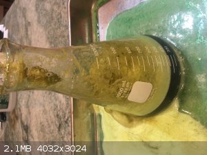

RELEASE THE ELEPHANT TOOTHPASTE!!
I already had a teflon stirbar at the bottom of the flask. I turned on both the hotplate and the magnetic stirring, and was excited to start witnessing further copper acetate production, as was the rest of the family.
About ten seconds after the stirring started, the intensely green-colored foam started, fast and furious. The foam started to steadily rise, and I sensed that it would quickly come out of the flask. Luckily I had a large pan nearby, and I was able to quickly take the flask off the hotplate-stirrer and place it into the pan before any of the foam left the flask. But the green foam kept coming, and coming - pouring out of the flask for god knows how long (more than 30 minutes). "COOL!" exclaimed the kids, as they quickly celebrated, saying they were so happy to see elephant toothpaste. "But, but" I tried to say, to no avail.
IMG_6144.JPG - 2.4MB
IMG_6147.JPG - 2.1MB
This green solution in the beaker is the solution from the flask, diluted with more water. The solution in the flask is darker and has a slightly more blue-ish green tinge than the pure green color in the beaker.
It took hours for the foam to go away. The solution that remained in the flash was a very dark colored. I poured some out into a beaker, and heavily diluted it. It was a beautiful green color, most easily seen from the top of bottom. When viewed from the side, it appeared to be dark green as there seems to be some fine particles suspended in the solution, that did not settle even after 12 hours.

That night (which was last night), I did copious amounts of *further* research on Copper acetate. I read about basic Copper acetate. I read about how an excess of acetic acid is recommended. I even found one post on SM where someone had a good amount of foam - but nothing like this. I looked up the color of both Copper (II) acetate and Copper (II) basic acetate, but neither matched the rich green color that I got.
FYI, there is still unreacted copper powder at the bottom of the flask. And I measured the pH of the liquid in the flask with my recently calibrated pH meter, which gave a reading of 4.8 Reaction of the solution in the flask with Ammonia gave a deeply colored blue-ish purple solution, and reaction with Sodium Carbonate gave a precipitate with the classic color of Copper Carbonate, along with copious bubbles of carbon dioxide. So no surprises with those reactions when testing for Cu+2.
So here are my questions for the SM community:
- What do you think the reaction was that produced the never-ending foam? I think it was most likely H2O2 producing oxygen but that doesn't explain everything.
- What do you think is causing the beautiful green color in the solution? Ok so it could just be Copper (II) Acetate but I've never seen it discussed as being so green in solution.
- What tests can I do on the solution to determine exactly what it is now? (I have some ideas but I want to get your thoughts)
- Who is John Galt?
Ok that's all for now! Please leave your thoughts in the comments below.
I suspect the simplest possibility is just that the solution is copper acetate, and it is just greener than normal, and that the foam was caused by the H2O2 reacting with impurities in the vinegar and releasing O2. But I'm not sure what impurities would cause the foam, some vinegars have yeast remnants but regular white vinegar is not supposed to have any active yeast in it.

I suspect the reason for the elephant toothpaste effect to be a Cu catalysed decomposition of H2O2. Finely powdered metals are known to decompose H2O2. And transition metal ions (Fe2+/Fe3+ in particular, but other ions as well) can also break down H2O2. So if you had both finely dispersed Cu metal and Cu2+ ions forming, this was a ripe environment for a catalytic decomposition of H2O2 to occur. What caused the foaming itself is another matter seperately. You say you used "Monks household vinegar". I'm not located in the US (or NA for that matter), so I'm not familiar with this brand, but apparently it's a brand of cleaning vinegar and not food grade vinegar. Perhaps it contains some detergent additives for aiding the cleaning process, and that's what gave rise to the intense foaming? That would be my guess.
The green colour is indeed puzzling. I've prepared copper acetate before by acting on fine electrical copper wire with acetic acid and H2O2 and at no point did the solution go green.
You said you have washed the filtered copper with distilled H2O, so chloride contamination can be ruled out. This is a stretch, but again going on the cleaning vinegar vs food grade vinegar trope, maybe some ingredients of the vinegar cleaning solution could interact with copper to give a green color. An even more implausible theory is that some of the formed copper was in the Cu(I) state, and the mix of Cu(I) adn Cu(II) can give a greenish color. But this is a big stretch, the presence H2O2 should fully oxidize all of the copper to Cu(II).

I re-did the experiment using the exact same bottles of H2O2 and vinegar. Stirring the solution rapidly before adding the copper powder did not produce any bubbles or foam, and neither did adding in small amounts of copper powder left over in excess from the previous attempt. The solutions I produced were a nice blue, the color of Copper Acetate that one would expect.
So at this point, I'm leaning towards either A) the large excess of copper powder somehow causes foaming and decomposition of the H2O2, or B) there was some other impurity in the original batch of copper powder that I hadn't rinsed out that caused the intense foaming. At some point I'd like to try to entire experiment again from the beginning, starting with the aluminum foil, to see if I can narrow it down to A or B.
