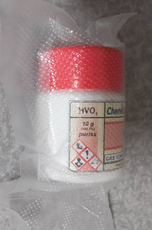

I'm not sure. Here is the picture from the auction site where I found this.
It's grainy and hard to read, but I think this is the manufacturer's website.
https://chemcraft.su/node/23382
I'm not familiar with vanadium chemistry, but can't I just add the stoichiometric amount, assuming that it's 100% HVO3?
@Bedlasky, @B(a)P
Interesting point. So, maybe it's just 1/2V2O5・1/2H2O.
Judging from it's color, this might be a leading theory.
@teodor
Thanks for the detailed procedure. Unfortunately, KMnO4 is very difficult for me to get. Oh well.
I actually want vanadium for oxidation catalyst, as well as to enjoy colorful vanadium compounds. Since V2O5 is restricted in my country, I have to buy something else, and found a website selling both NaVO3 and the said HVO3. At first I thought I'd buy the latter, because the former contained 250g for about 40$, and I don't need that much. But considering the unreliability of purity, I might buy NaVO3, then convert it into NH4VO3 and then V2O5.
HVO3_10g.png - 168kB HVO3_250g.png - 112kB

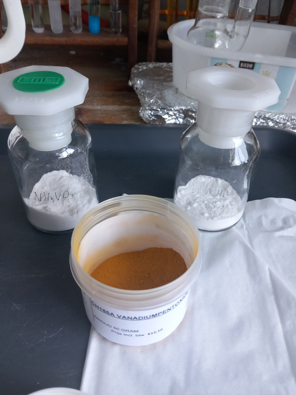

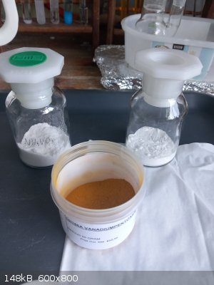

I can confirm that V2O5 from Keramikos is of relatively high purity.
It forms clear yellow solution with NaHCO3. On my experience Fe impurities becomes visible on prolonged standing. In this case I noticed some amount of Fe3+ oxide-like flakes after few weeks (but it could be from NaHCO3 also).
The conversion to NH4VO3 gives a bit pinkish powder, something I would expect from Mn presence. I would like to test it for Mn but didn't find a test yet which will definitely separate V and Mn ions in the case of low concentration of Mn.
20230523_064301.jpg - 147kB
The second crystallization (NH4VO3 -> NaVO3 -> NH4VO3) improves the purity.

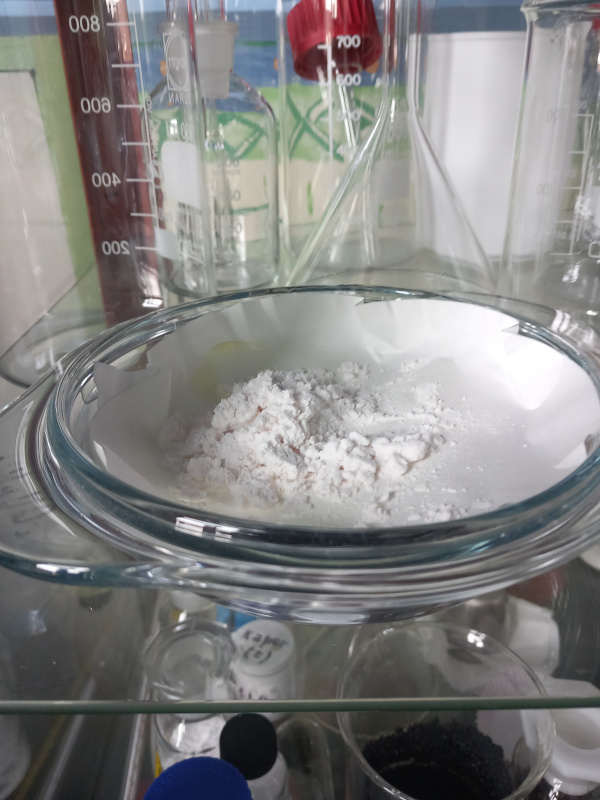

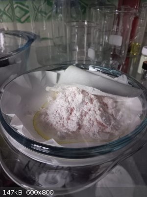

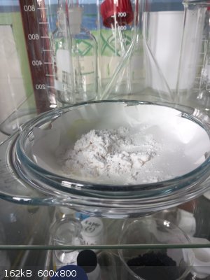

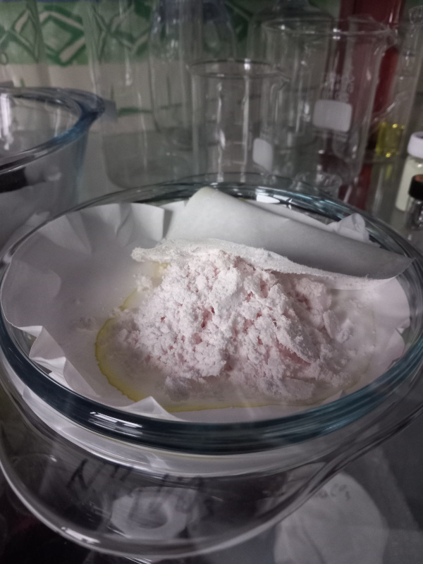

20230526_122649.jpg - 162kB
On this foto there is the starting material, the result of the first crystallization is on the left and the second crystallization is on the right.
20230526_123431.jpg - 148kB
Each crystallization cause 12-14% loss of the material, not so many, so it can be repeated multiple times.
