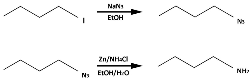

Hello
I have successfully prepared n-butylamine. At first i made n-butyl azide from n-butyl iodide (buy) and sodium azide in methanol (procedure from Organics Functional Group Preparations by Stanley r. Sandler instead bromide i used iodide also it's better leaving molecule). Second step is reduce azide to primary amine , i started search for easy and convinient method and found reduction with Zn/NH4Cl (Reduction of Azides to Amines or Amides With Zinc and Ammonium Chloride as Reducing Agent). So i started my last step according to this method i should get about 90% yield but i got +- 80% , this is fantastic because some product lost while i destill it to purify and this was my first attempt. This method is simple, very cheap (some method need Pt :o) and quick , high yielding ( i reflux for about 30 - 45 minutes to sure that reaction is complete). This reaction is basic for preparation of primary amines from azides but the reduce method is very good and not usual.
n-butylamine.JPG - 63kB

[*] posted on 28-5-2011 at 00:17
It is nice that it worked well for you, but you might consider sharing the experimental as well, so that other members interested can learn something from your experience. In it you should address the key issues of this preparation, namely the issues of product isolation and characterization. How did you separate n-butylamine from ethyl acetate? You give the yield, which leads us to believe that you already characterized the product. So how did you confirmed the identity and purity of the product? n-Butylamine is a liquid at standard conditions, so to characterize it in an amateur setting you would have to derivatize a sample and measure its m.p. (have you checked the m.p. of the hydrochloride?).
For amateur chemists, it is not so much the reaction itself that is an issue, but the isolation and characterization, so you would be most helpful if others could learn from your problem solving approach.

[*] posted on 28-5-2011 at 00:54
1. Adding all together in the same ratio of moles like in procedure reduction only multiply everything by x10
2. Heating under reflux at first 30 minutes but i heat just for 15 minutes to sure that reaction is done, so 45 minutes is just fine
3. I do NOT add ethyl acetate !!!! only dietyl ether , n-butylamine and EA have almost the same boiling point so i need something "lower" boiling --- i choose Et2O
4. I filter solution and wash with brine and dry over anh. MgSO4 (couple hours)
5. Evaporate solvent (steam bath) i don't need reduce pressure beacuse i use ether (earlier i smeel stinky dead fishy odor but now it's stronger plus irritating but not like ammonia)
6. Residue is destilling and collecting everything 75C - 79C
7. For sure me that is n-butylamine i made Hinsberg test , so i don't have gas chromatograph but i'm sure that is n-butylamine

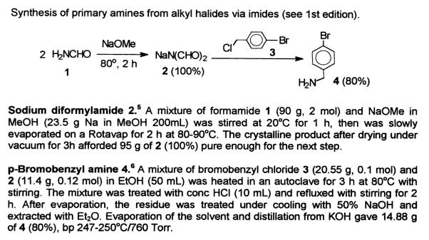

mario840
Posts: 229
Registered: 20-1-2010
[*] posted on 27-6-2011 at 01:02
Now i regred that i tried delepine reaction ,i should try gabriel, much shorter reaction time for longer chain carbons , it's done even with chloride (delephine reacts for months in room temperature with chlorides) iodide react of course much faster , reaction can be done in dimethylformamide or ethanol (delepine only in chloroform - the first step), there are couple substitutions for phtalimide in this reaction for example : sodium diformylamide is easily prepared from sodium, methanol, formamide (i got everything) but still phtalimide is better option (cheaper)
gabriel_sodium diformylamide.JPG - 54kB
