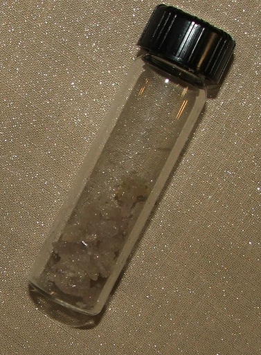

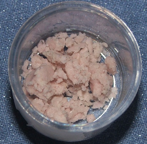

I dissolved manganese(IV) oxide in HCl once and it produced a liquid which was almost colorless after several filtrations. After concentration, it
appeared pale pink, so I dried it to produce pink crystals. After a few months, these crystals have absorbed water, making them slushy, and they also
seem to have lost their color. Now they are a very light tan-pink. Why would MnCl2 change colors? The lighting is the same although the background
changed.

I am surprised by the "light tan-pink" color you have, could it be that some of your MnCl<sub>2</sub> is slowly oxidizing, turning to
Oxide/Hydroxide/Carbonate? or could it be some iron impurities showing up?

It was pink initially but then changed color. I don't think that it is manganese(III) as an oxidation product because manganese(III) is very dark but
the second picture is almost colorless. I used hot air to dry off the MnCl2 instead of a dessicator and the result (Picture 1) was very similar to
your initial result on the left side. The result after a few months (Picture 2) looks like the right side, although it is quite slushy.
Does manganese(II) form any chloride coordination complexes that are more or less pink than the aqua ion? I'm not sure what else would explain the two
different colors of MnCl2 * x H2O and their seeming interchangeability.
