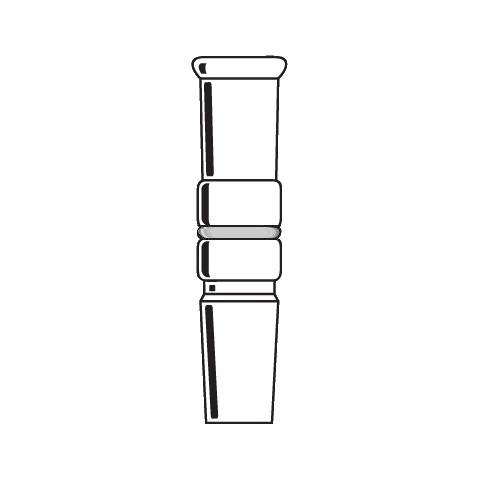

fractionating column help?
To make a lot of waffling less: I'm trying to fractionally distill a sample and my 'column' does not have the indentations/prongs at the bottom; what can I do to use the condenser as a fractionating column? I've considered using an adapter like this one http://www.ctechglass.com/images/AD-0057b.jpg but I'm fairly certain that the frit would flood at some point( the viscosity of the liquid would be a factor as well). .any ideas are greatly appreciated. If this has been asked please forgive me but in any event I thank you and wish you the best yields.

The frit would flood, no doubt about that. It would flood, and the vapor couldn't pass through it, leading to a sharp increase of pressure in the distilling flask. If the flask is strong enough, the joints would separate. Pressure would drop suddenly and the distilling liquid would turn to a blob of gas, shooting out. That would be a major hazard, even if it's not flammable or corrosive.
If the apparatus is tightly jointed, with the clamps and everything holding it very tight, and the flask is not strong enough, it would explode.
Either way, you're fucked, or the lab is. So don't even think about frits.
Organikum has s good point. If you're distilling something neutral, organic, fresh steel wool is a great way to make a column, but be careful not to stuff it. It can become saturated at the bottom, flooding and shooting liquid into your cooler.
