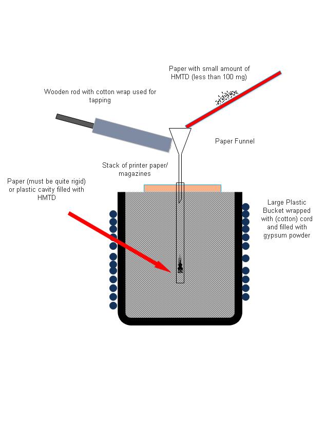

One takes several 5 - 10 l buckets, places them inside each another. The central one is filled with about 5 - 10 kg of fine inert powder like gypsum. Then a hole is made in the center and 1 cm by 15 cm long cavity is placed inside. 4 stacks of magazines are placed around the cavity, so as to cover the surface. A funnel made out of paper is inserted into said cavity. One takes 10 pre-bent papers, each one with less than 50 - 100 mg of primary explosive. Then he/she uses wooden stick wrapped in cloth/cotton wool to move the primary inside the cavity. The cavity is filled with ~ 1 g of said primary. Then a fuse or e-match is inserted. One uses a T-shaped stick to ram down a cotton wool plug that is about 10 cm long (made from multiple small pieces), this plug is slightly compressed. The end of the blasting cap is sealed with glue. Then, the only place where fingers will ever come into contact with the blasting cap is the end with glue (right next to the seal).
Do you like the idea? Of course, this process should work with compound blasting caps (SA.DS/ETN, dextrinated lead azide/PETN..) and with pressing and arbitrary amounts of said explosives.

I like the bucket idea which would pretty much reduce the risk of shrapnel to zero with <1gram of explosive.
It would need to be able to fit in a press and have a solid base to take weight because most caps have a secondary pressed in with a small amount of initiating primary on top. A press would be much much safer than ramming it (even lightly) with a wooden rod even if it is wrapped in soft material like pictured.
Keeping the hands off and away is important too (I am using lab tongs at the moment). I have a pair of kevlar gloves like you mention that I wear under leather welding gloves and kevlar forearm sleeves (as well as face shield, ear plugs and muffs).
I brought them as soon as I saw a test by Klapotke where 1g of primary in glass test tube is initiated 10cm from different material gloves filled with ballistic gel.
I think it was 40+ pieces of shrapnel dug out of the unprotected hand and just 2 or 3 in the kevlar cut resistant gloves. That sold them for me.
[Edited on 11-1-2018 by greenlight]

The bucket reduces the sound levels, too. Indeed, the ramming rod (the second one, not pictured) is a T, so that you don't have your hands above the small 1 cm hole in the paper shield/cover. The first rod is just for tapping the paper funnel.

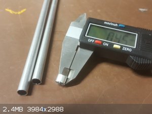

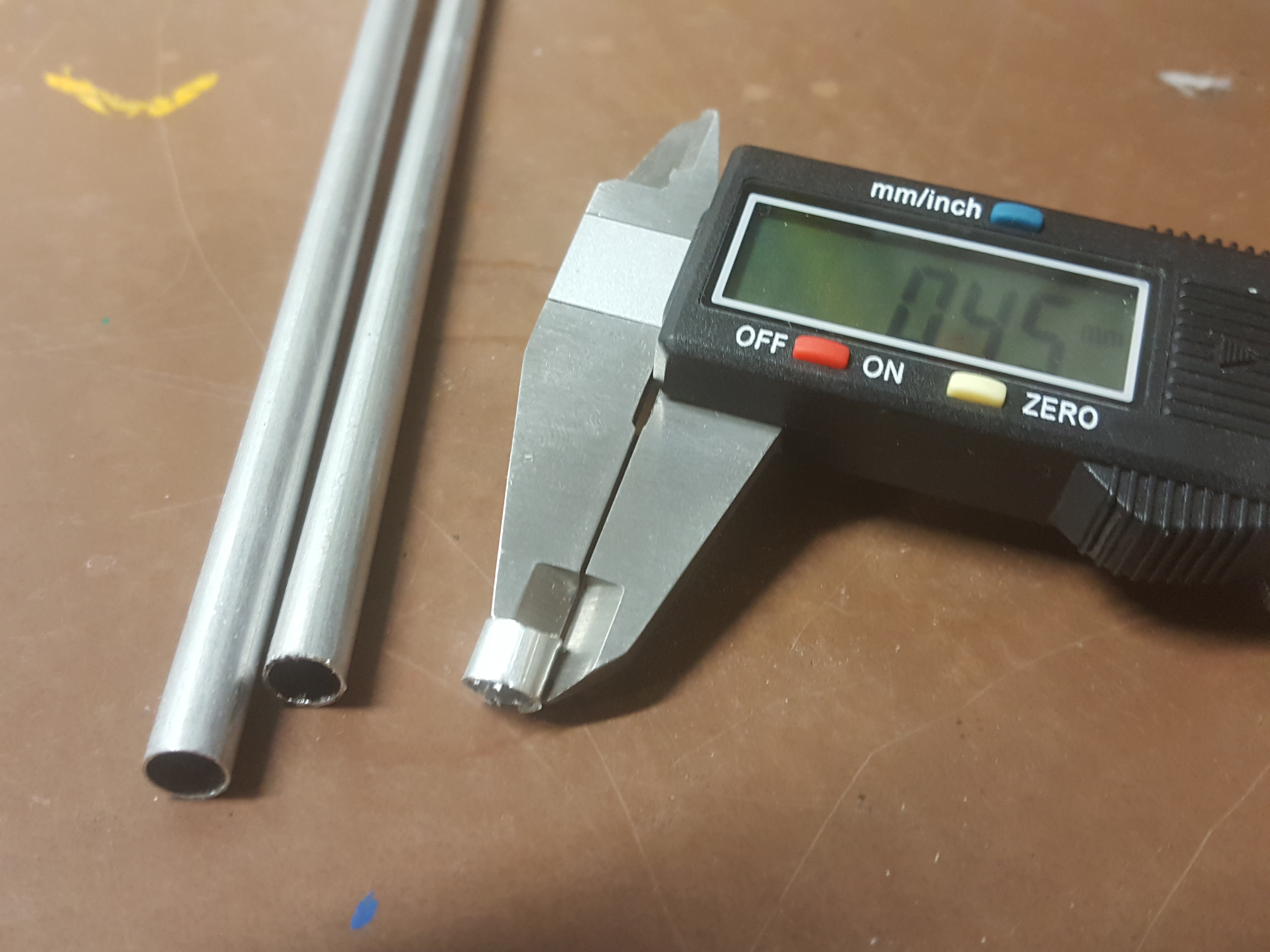

I use Al tubing from a hobby shop, I think it is used for model aeroplanes to support the wings because it is in the planes section. I have uploaded a photo with thickness included. They are thicker than what you describe but work excellently, I believe the shock of the casing fragmenting improves initiating efficiency. Commercial caps are thick walled like these.
I have done a test with these exact tubes used as detonators (700mg PETN base/200mg Lead azide too) detonating them in close proximity to a small block of ballistic gel. I found that with these explosives in them the fragments are small and very light and do not penetrate very far into the gel.

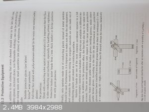

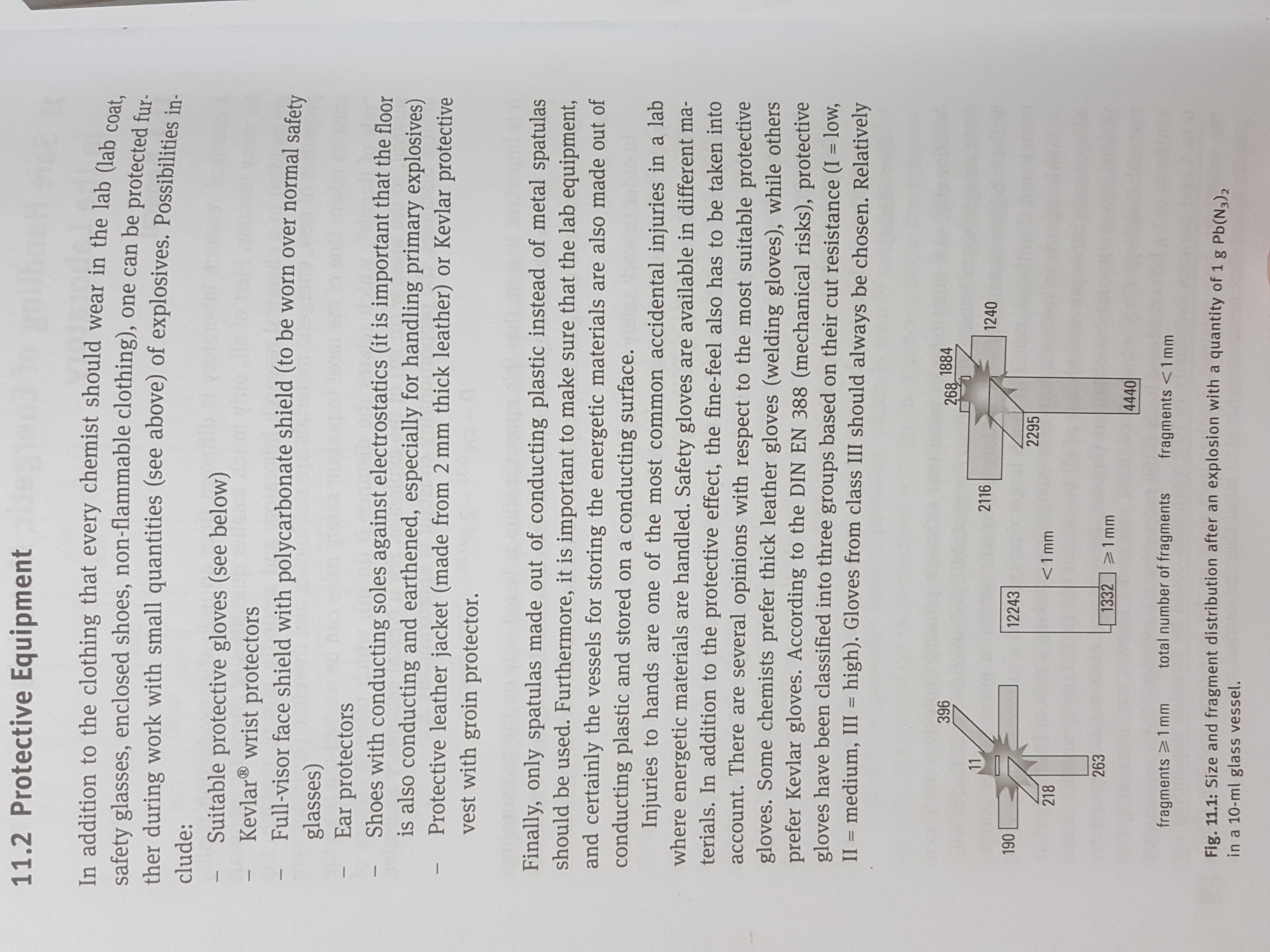

Here is pictures of the article, should be able to zoom on them. The test is using glass container as the fragmebts, these would be heavier and nastier than Aluminium. They are from Thomas Klapotke's newest textbook Chemistry of high energy materials:

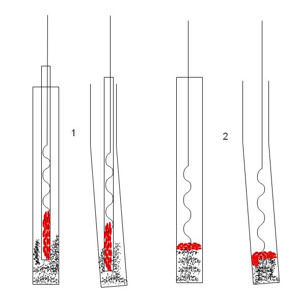

Assuming that we have powdered primary, I'm talking about these two cases.
In case one, there is slight bending of the outer tube (enlarged), there is friction between the two walls and ETN/PETN, but the primary is isolated from any of that.
In case 2, there is presumably much less friction due to absence of multiple walls, but the boundary layer of primary and secondary is pressing against itself (between the crystals) and the wire + there might be microcracks in the wall with primary, primary/ETN mixture inside them that compress due to the bending.
So, which one is safer? (Likely) larger forces on the ETN or smaller forces on ETN/PETN/azide/SA.DS mixture? How would you granulate SA.DS (quite unstable compound) and would it affect DDT? Has anyone tried this?
Furthemore, I think that case one is better isolated against shock (fall to the ground), since the ETN can act as a cushion in this case. Or.... not?

I see what you mean with the two tubes method. If the inner tube is secured in its outer tube with out any play it would be safe. In the end there is still the same chance it will go off if accidentally dropped as the second design I think, more chance if the inner tube is loose in any way.
Detonators (commercial and homemade) I have seen haven't been able to be bent accidentally, the casing tube is quite strong.
I use the design in the diagram at bottom of my post. The PETN is recrystallized from acetone and like soft sand and the lead azide is powder obviously. Once they are pressed and sealed, the whole design is compact and sturdy and I am sure they could survive getting dropped without initiation.
I use a small amount of granulated black powder as the ignition charge and have the igniter wires and igniter head in this layer so it cannot create friction with the primary explosive layer.
I honestly would not try and mess with recrystallizing or granulating any sensitive primarys especially the salts of silver, mercury or lead or peroxides. This would mean increasing crystal sizes would it not.
I think it is not possible to do for most of them. The tests I have read on crystallizing the primaries that allow larger crystal formation alway results in spontaneous detonation from internal stresses while drying, precipitating, filtering, or my favorite, just sitting there:D.
Large crystals of lead azide are one of the more "exciting" ones to precipitate that I have read about..

The tubes are open ended and quite long, I cut them to size for use. I used to use foil as the end cap, as long as the cap is pressed and sealed well, there will be no movement to allow friction.
For the last batch of caps, I have been using metal epoxy to make a sturdy thin plug on the ends.
