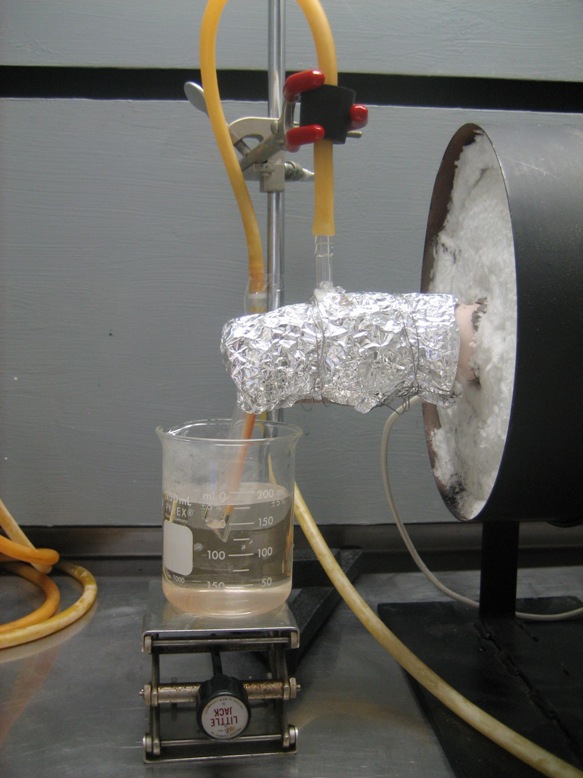

Apparatus Set-Up
The retort was inserted into the tube furnace and the open areas at each end of the furnace tube were plugged with Kaowool. A 12” x 1/8” type K thermocouple was inserted alongside the retort from the back end. The opening of the tailpipe was submerged about ½” below the water surface in the product receiver beaker. A clamp-on ammeter was used to monitor the current to the 220VAC furnace.
IMG_1049 (2).JPG - 106kB
1. Apparatus in mid-run

t= 0 minutes: The furnace current was set at 6.7a, initiating heat-up. There was a steady issuance of large bubbles into the product receiver water as the air in the retort heated up. At furnace temperature T= 245C some water condensate could be seen in the tailpiece. More will be said about this water later.
t= 33 minutes: T = 351C and the bubble rate was a steady 1/s.
t=40 minutes: T=400C and the bubble rate was slowing. Turned up current to 7.5a. Turned on hood exhaust fan.
t= 51minutes: Started constant flow of argon (1-2 bubbles/s) as retort gas bubble rate had become very slow. T=516C.
t= 56minutes: T= 550C. Temperature was increasing fast. Suspect the P reduction reaction is taking place. A lot of burning phosphine was issuing at the tailpipe.
t=60 minutes: T=600C. A lot of white smoke was issuing at the tailpipe. Suspect this is P2O5.
t=73 minutes: T=696C. White P has dribbled down tailpiece to within ½” of end. Phosphine stopped 10 minutes or so ago. Keeping argon at 2 bubbles/s. The new luting compound is holding a seal and is only slightly penetrated by red tinted P!
t=85 minutes: T=766C. I = 7.5a.
t=92 minutes: T=800C. Turned off furnace.
t=150 minutes: T=538C. Cut off argon supply and removed product receiver beaker.
t=170 minutes: Removed retort from furnace to cool. Turned off hood fan.

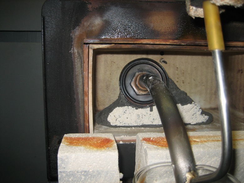

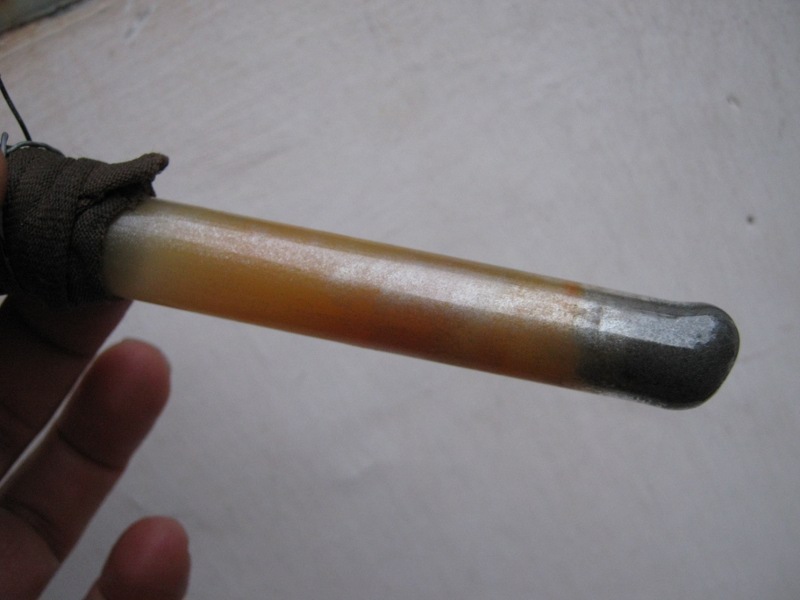

As can be seen in the picture below a film of red P sublimed onto the inside of the glass tailpiece.
The yield of white P in the water receiver was very small, ie, less than 1 g, and this had to be melted with a heat gun to get it to drain into the receiver.
IMG_1050 (2).JPG - 100kB
2. Apparatus at end of run

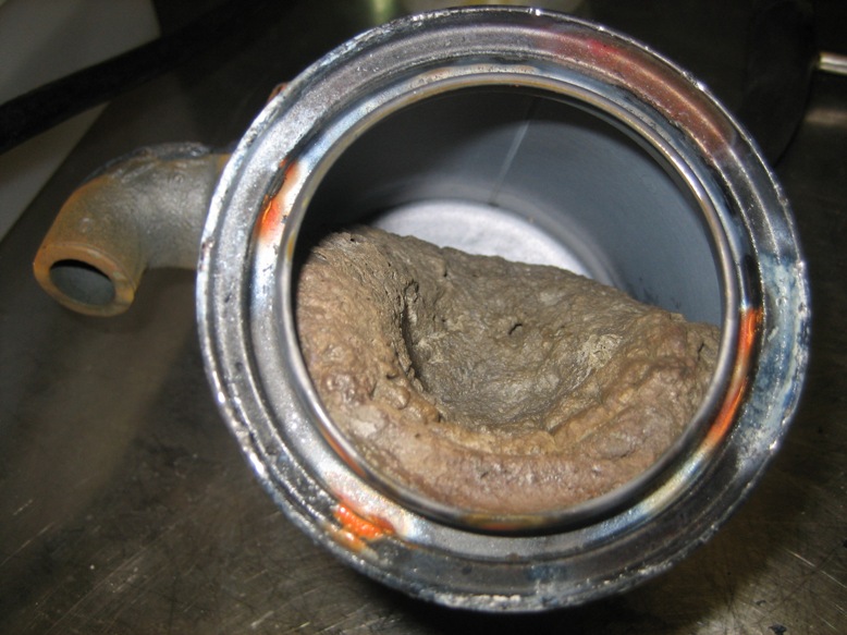

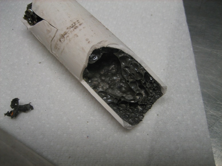

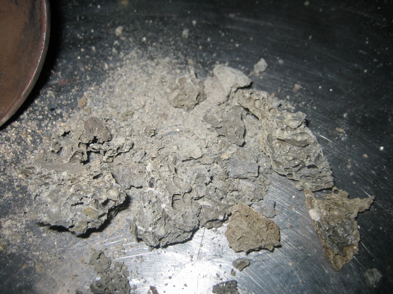

Examination of the Slag
After the ceramic tube had cooled to room temperature the ceramic tube was circumcised with a Dremel diamond cut-off wheel about ¾” from the tapered female end of the glass tailpiece. The ceramic tube was then crushed in two places using a pair of channel locks. This opened up the tube and allowed examination of the slag. The slag was a black, almost vitreous, vacuoled mass that had expanded to within 2” of the beginning of the taper of the ceramic tube. A small piece of slag was placed into a beaker of water to see if it contained any phosphide as indicated by the generation of phosphine bubbles. There were none generated. The slag floated easily as can be seen in the pictures below.
IMG_1051 (2).JPG - 98kB
3. Slag in retort
IMG_1052.JPG - 95kB
4. Close-up of slag
There was a small amount of sublimed red P in the closed end of the ceramic tube.

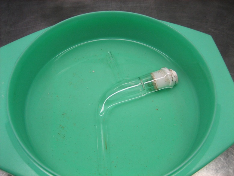

Recovery of the Glass Tailpiece
During my screening tests for a suitable luting cement I had found that the cement could be destroyed by soaking in 10% aqueous NaOH overnight. Therefore I placed the tailpiece with ceramic stub in a bath of this solution as shown in the picture below.
IMG_1053.JPG - 84kB
5. Tailpiece cleaning in 10% NaOH
However, after soaking for 40 hours the stub was still cemented tightly to the glass. However, this soaking did remove and dissolve nearly all of the film of sublimed red P as can be seen in the photo. No evidence of phosphine bubbles was noted.
This solution was then discarded and a fresh solution of 10% NaOH was prepared and heated to near boiling. The stub was immersed in this solution and within an hour it had destroyed the cement, and the stub was removed as shown below.
IMG_1054.JPG - 84kB
6. Recovered tailpiece
During the soak in the fresh, hot 10% NaOH many tiny bubbles were being released for 5-10 minutes as the solution penetrated the cement. Suspecting that this might well be phosphine the hood fan was tuned on. The following equation may have been occurring.
3NaOH + P4 + 3H2O ---> PH3 + 3NaH2PO2 (ref 4)

It was clear from the run log that the reaction initiates at about T = 550C as indicated by a fast rise in temperature and the sudden presence of burning phosphine and smoky vapors. Therefore, this confirms that when using the above reactants only a moderately high temperature is required.
The 2 new equipment design features have been proven effective by this experiment. The argon purge allowed for an easy shutdown without worrying about a possible catastrophic suckback of water into the retort. The successful glass/ceramic seal and the recovery of the tailpiece are important to safety as well as economic viability.
Although a mass balance was not possible it seems likely that complete or nearly complete conversion of the NaPO3 to phosphorus was achieved. The slag had no apparent white P as would be evidenced by smoking in air. The slag also did not appear to contain phosphide as would be evidenced by its bubbling in water. (Grinding some before water immersion would have been a better test.) However, very little P was actually captured as the desired product, white P: at best 20%.

Yes, I tried a lot of formulations before finding one that works. Here's the formula:
*10g pottery grade ZrSiO4
*17 drops "as received" pottery grade waterglass
*add just enough water to get good fluidity
I make mine in a small beaker using a stirring rod.
The bond can then be destroyed with near boiling 10% NaOH.
I have used it twice now, both times with good results.

Success!!
experiment :
I mixed 1.7g sodium hexametaphosphate, 0.7g Al and 0.5g of something that is sold as "quartz". All three substances where already 'fine' powders when I bought them. I didn't grind anything. The powdered Al is not pyrotechnic grade as far as I can tell - I'm assuming pyrotechnic Al is black? This one would make your fingers silvery if you touched it.
I put half of the mix (~1.5g) in a 15cm test tube, plugged it with that yellow stuff which is supposed to be glass wool (but yellow? why?) and wrapped a bit of wet cloth at the top.
Heated the stuff for something like 10-15 seconds. The mixture started to glow red and expanded somehwat. It took 3 or 4 more seconds for the reaction to complete and the test tube to almost melt, as can be seen in the picture.
I put the test tube in a dark room and could see it faintly glow. Now a few hours have passed and the glow is almost invisible.
Not sure what to do next...

Congratulations learningChem. What to do next? Try heating the bottom of the test tube and forcing the free P toward the cooler end where it should condense if the wet cloth is kept cool. The P which accumulates at the open end can be removed with a flat spatula and stored under water. Since you are not using an inert atmosphere but a plug of glass wool, oxygen will diffuse through and consume your hard-won product!
Words of caution: this is not an experiment which should be done indoors without proper ventilation (preferably with an efficient fume hood). Also, you are handling the test tube after the experiment without appropriate protection for your hands--be advised that white/yellow phorphous burns are particularly nasty and painful.

Here's the results of my testing yesterday using a retort made from 3/4" EMT (steel electrical conduit). The retort is shown below.
IMG_0921.JPG - 79kB
EMT retort
The closed end is about 14" long and the remainder is about 7" long. I first soaked the conduit in 6N HCl in an attempt to remove the zinc coating. I don't think it all came off. I'm not sure why. The tube was bent to a 90 degree angle using a tubing bender. The long end was closed in a vice then welded shut. A piece of 1/4" ss tubing was then welded to the short end.
Stoichiometric quantities of NaPO3, Al, and SiO2 were then ground together in a mortar. Basis was 6.4g of P. This powder was poured into the retort. The retort was then placed in a tube furnace. The receiver beaker contained water which was maintained at a temperature of 50-60C using a hotplate. Submergence of the retort outlet was 1.5". Argon was led to the retort using the 1/4" ss tube, as shown below.
IMG_0922.JPG - 79kB
EMT retort in furnace
Run log:
t=0 min: Set furnace current I= 6.5a.
t= 32 min: Steady bubble generation due to heatup.
t= 51 min: Turned on argon bubbler. T= 419C. Turned on hood fan. Set I = 7a.
t= 67 min: T=539C.
t= 72 min: Smoke coming off receiver now. T=572C.
t=74 min: T= 597C. Smoke and phosphorus vapor burning at receiver water surface. No pops heard.
t= 75 min: phosphorus drops falling into receiver now. Only about 7 drops came over, basically all at once.
t=102 min: Still just smoky puffs. T= 772C. I=8a.
t= 142 min: T= 1055C. Managed to tease a few more drops out by introducing the argon very slowly.
t= 147 min: Turned off furnace.
The drops of white phosphorus can be seen in the picture below.
IMG_0923.JPG - 68kB
P in water receiver.
Today the receiver was heated to 45C, melting the drops of P. They were easily consolidated by pushing them together with the end of a thermometer. The product weight was 1.2g for a yield = (1.2/6.4)100 = 19%.

I took four pictures following this run. The first shows the system in the operating configuration.
P retort in operatin.JPG - 103kB
P retort in operation
The second picture shows the furnace with the firebrick door removed. The white material on the slag is a thin layer of de-laminated firebrick. You can see smears of red P on the top of the firebrick.
P retort with inuslating brick removed.JPG - 127kB
P retort with insulating brick removed
The 3rd picture shows the retort with slag, removed from the furnace.
P retort following run.JPG - 91kB
The final picture shows the slag on the furnace floor. This was removed fairly easily by scraping with a large screwdriver.
P slag on furnace floor.JPG - 117kB
Disscussion
I admit that I should not have loaded the retort so full on the first run for this new retort design. But greed overcame better judgement.
Unfortunately this slag foam is a serious drawback for this formulation of reactants and significantly cuts into yield potential.
I am pleased with the paint can/EMT tube retort design, which incorporates compression seals, allowing reuse of the expensive tube. Perhaps it can be improved to allow for a larger yield.
Although I don't think it had anything to do with causing too much foam I note that I did grind my NaPO3 in a coffee grinder prior to mixing it with the other ingredients. This is the first time I have done this. This grinder does a fine job of pulverizing the NaPO3 to a fine powder.
As always, comments, suggestions, and questions are welcomed.

watson.fawkes - 6-9-2012 at 16:13
The fine grind might have contributed. The reaction mixture, partly liquid, had some characteristic viscosity. Gaseous products (e.g. phosphorus) would have some characteristic bubble-up time to reach the surface and escape. If the rate of gas production exceeded the time for a bubble to escape, you'd expect to see volumetric expansion and creation of a foam. Finely ground reactants could well have played into this by increasing the gas production rate beyond some threshold.
Suggestions. (1) (Not too helpful) Use a tall, thin reaction chamber and expect foam. That would mean a new oven and chamber, but it would allow the foam to form without much consequence. (2) Use an inert viscosity modifier to thin the reaction mixture. CaF is what immediately comes to mind, but I don't know if it would apply here. You could test multiple compositions in one furnace run with 1 g batches and little reaction thimbles, packed into your reaction can. I'd suggest a simple rack also, with holes for the thimbles and a couple of bent sides for legs.

I have added a snorkel to my condenser design. This will allow a greater fill and thus a greater yield. It is being "burnt-in" as I write.
condenser with snorkle.JPG - 71kB
[Edited on 12-9-2012 by Magpie]

Yesterday I made a full scale production run using the basic (stoichiometric) NaPO3/Al/SiO2 formulation. Ingredients were thoroughly ground together in a mortar then dried for an hour in an oven. The charge, which weighed 54.4g, was placed in the retort and the condenser installed, the whole system having been backfilled with argon. The assembly was weighed at 368.8g. The retort void cavity had been measured at 225mL. The assembly was placed in the oven and the thermostat set for 700C.
At ~500C some smoke, burning phosphine, and drops of white P (very clean and white) were emitted from the condenser. Some white smoke was emitted from the crack above the furnace door indicating a small breach of containment of the retort. Heating was continued until the furnace temperature reached 700C. A picture of the P in the receiver is shown below:
base formulation P (54.4g charge).JPG - 109kB
When cooled the retort was removed from the furnace. Some white powder, P2O5 I presume, could be seen at the can rim in 2 places, and red P in 4 places. Upon opening the can the slag formation was observed as shown below:
base formulation slag (54.4g charge).JPG - 125kB
Weight of the fired retort assembly was 367.6g indicating a loss in weight of 368.8-367.6 = 1.2g. The volume of slag was measured by backfilling with sand to be 166mL. Therefore the slag volume/g of charge = 166mL/54.4g = 3.1mL/g, which exactly matched that of the 1g test tube measurement!
The P produced was a disappointing 0.9g for a %yield of only 9.5%. I expected 19-20%. This weight was close to that shown in the assembly weight loss of 1.2g computed above, however. Therefore, it seems that the overwhelming contribution to poor yield is just the nature of the reaction itself.
Comments, questions, recommendations?

Magpie - 20-9-2012 at 12:43
I concur with watson's assesment that the P is most likely chemically bound as one or more oxides. Just where the oxygen originates is a bit of a mystery as the retort was backfilled with argon and kept under a slight argon overpressure.
When the slag is cracked open there is no smoking, which would be evidence of free white P. Also there is not much evidence of free red P except some obvious spots here and there. The beige coloration may be due to finely divided red P, however.
Shown below are two pictures that I just took of the slag from Run#4:
Run#4 slag in retort.JPG - 125kB Run#4 slag dug out.JPG - 175kB

Magpie - 20-9-2012 at 13:51
Quote: Originally posted by learningChem
Does that mean that the reaction doesn't work as advertised?
It obviously works: white P is produced. It's just not produced in high yield.
Or that (most of) the P is first liberated from the phosphate and then it reacts again and forms a new P compound?
These mechanics are not elucidated by our experiments so far. I think it is possible that much of the NaPO3 is left unreacted, probably dissolved in the glassy silicate.

Magpie - 24-9-2012 at 14:54
I just finished cleaning up after my phosphorus run (#5) with boria substituted for silica according to the following assumed reaction:
10Al + 6NaPO3 + 6B2O3 ---> 3Na2B2O7 + 5Al2O3 + 6P
The charge was 50g.
I had noted that the charge had picked up 3.2g during grinding and handling due apparently to the aggressively hygroscopic nature of B2O3. I felt that this water had to be driven off before firing because of the potential for a yield killing reaction below:
16P + 15H2O ---> 3P2O5 + 10PH3
Therefore I heated it for 2 hours at 350C. This did drive off the water but also melted the boria forming the charge into a hard monolithic disk 3" in dia and 1/2" thick. Wrongly or rightly I felt this disk had to be pulverized so pounded it with a hammer in a plastic bag then ground it up quickly in the coffee grinder.
I backfilled the retort ass'y with argon, started the argon bubbler, and turned on the furnace. When the temperature reached 700C nothing yet had happened. So I set the thermostat to 800C. When the temperature reached 750C that's when the fun started.
The reaction took off. Some few drops of red and black P fell into the receiver as shown below:
first P discharged.JPG - 100kB
first P discharged
(The weight P in the receiver is 0.5g.)
Then a large fire in the furnace occurred, indicating a breach of containment of the retort. I pulled the plug on the furnace and took a few steps back. The generation of P2O5 smoke was voluminous, challenging my powerful fume hood.
After about a half hour I ran out of argon. Now a big goober of burning phosphorus dropped into the receiver. Oh well, all the exposed P in the furnace had to burn off at some time.
You can perhaps see the added goober in the picture below:
after 2nd P discharge.JPG - 102kB
After cooling overnight I open the furnace for inspection. Here's what was left of the retort:
run#5 (boria) retort.JPG - 109kB
run #5 (boria) retort
You can see the glassy slag in the bottom of the retort and around the inlet of the snorkel. A second picture shows the snorkel in more detail. The inlet is about 1/2 closed off with glass.
run#5 (boria) snorkel.JPG - 118kB
run #5 (boria) snorkel
Discussion
My current retort is clearly not adequate for containing this reaction. However, I think the reaction has potential for producing a good yield of P. All three reactants are liquid at the apparent firing temperature of 750C. And the slag has a very low volume: maybe 25% of the retort, and likely has a low viscosity as there are very few vacuoles. There was much burning of P in the furnace indicating a potentially good yield.
Questions, comments, and recommendations are welcomed.
[Edited on 25-9-2012 by Magpie]
Strepta - 24-9-2012 at 15:38
Excellent! As soon as you "harden" your retort, we should see some nice results. I never used a charge larger than 4 g, so I can only imagine the magnitude of that conflagration. It will be interesting to see your yield and, then, whether further improvement can be made.
watson.fawkes - 24-9-2012 at 16:53
One thing I immediately noticed is how much higher the initiation point was for this reaction, particularly since everything is liquid and the earlier mixture was powder. The answer, it seems to me, is that there's a gaseous intermediary in all the powder reactions that's able to set off a chain reaction. A little digging, a candidate popped up: P4O6, with boiling point 173 &deg;C. I'd guess it reacts with Al, reducing to P4. In any case, since gas molecule are more mobile that liquid ones, it could explain why the mixture ignites later.
I would have to guess that you've got phase separation at 700 &deg;C, with a puddle of molten Al at the bottom, covered by a boron-phosphorus flux on top. That would mean that at the time the reaction starts you've got a planar interface layer where the reaction occurs, at least before it gets violent.
It's suspicious that the ignition temperature you report is just a few degrees above the melting point of borax, one of the putative products. It looks like the aluminum, whether solid or liquid, might be passivated by borax, kinetically limiting the reaction below its liquid threshold.
What's the enthalpy of this reaction? I know aluminum burns hot, but that crucible is just totally wrecked. Notice how the very bottom of the can is the one part that stayed partly attached. My guess would be that you can see the height of the molten Al in the secant across the arc of metal that's left.
Any reaction that involve combustion of liquid Al is going to need something heavier than sheet metal to contain the heat. I guess it's more obvious when you state it that way. From the photograph, it seems that the lid of the retort stayed on, and that the wall of the retort failed first. Confirm? As a more engineering-oriented comment, there's a hot spot. You need adequate thermal mass in the wall of the container so that it doesn't rise above its melting point at the surface level of the Al (where the reaction is happening) before the heat can dissipate outward.
You mention that the slag has volume about 25% of the retort. How did you measure that?
My one suggestion is to use carbon as part of the initial charge. I don't know that it ought to be the entirety of the reducer, but because its oxidation product is a gas you might see a lowering of the ignition temperature (see first comment). If it lowers below the melting point of Al, then the hot-spot problem will be alleviated. With liquid Al as a reagent, you've got the melting enthalpy of Al to dissipate as heat. I'd guess that the Al powder might still settle at the bottom, but it would be an improvement over a puddle. The carbothermic industrial reaction I reported on is at much higher temperature, but it's also reducing a Ca compound, not an Na one. It might be useful to run a small carbon-only reduction just to estimate its ignition temperature. Also, with liquid salts as the other reagents, porous chunk charcoal might work better than fines that can settle more easily.
Magpie - 24-9-2012 at 17:42
Thanks. Yes, it's back to the drawing board for a more robust retort. The beauty of the paint can is that it is a highly engineered item yet is mass produced. So it is cheap and therefore, expendable.

Magpie - 24-9-2012 at 18:17
Sorry I can't easily confirm that as that can has been disposed. With some dumpster diving it would be retrievable, however.
The lid and bottom retained integrity. The lid did stay on. The sidewall was trashed, however, as you can see.
It's just an estimate by eye. It might be even less than 25%.
The only experience I have with carbon is an attempt to run the industrial reaction with Ca3(PO4)2, C, and SiO2. This was in a ceramic tube in a tube furnace. There was no reaction. Maximum temperature was likely 1300C. I apparently did not record this experiment as I can't find it in my notebooks.
Magpie - 24-9-2012 at 18:29
I have used a beefy retort made from black iron pipe parts that should hold up.
Yes, I will probably have to go to some metal pipe for the boria reaction. That may be practical as the product is pretty much water soluble and should allow for recovery of the retort with a reasonable amount of effort/risk.
If you can weld, sealing the bottom off properly (I did have some seepage out of the threads) would help.
I can't weld (don' have the equipment) but know a SCWIM who can for a reasonable price.

Magpie - 27-9-2012 at 14:24
... I will be visiting my SCWIM tomorrow to get these pieces fabricated into a new, much more beefy, retort. ;)
I have put a hold on fabrication of a new, ss retort. It's design was predicated on being reuseable. Because of the hardness and insolubility of some slag that hardened on the floor of my furnace during the previous run with boria that assumption may not be valid.
It is a dark, glassy slag. Dark because of unreacted aluminum I believe. The slag forms small bubbles in both HCl and NaOH but is otherwise unaffected. It is difficult to chip using a chisel and hammer. It will grind difficultly under attack with a file. My Dremel with diamond wheel even has trouble cutting it.
So, I have retrieved the slag mass from the dumpster. If I can't find a way to dissolve or otherwise break up this slag I will be forced to revert to an expendable retort body for the boria formulation.
Any suggestions on how to deal with that slag will be appreciated.
watson.fawkes - 27-9-2012 at 16:18
Vycor glass starts life as a kind of alkali-borosilicate glass. It's heat-treated to cause a phase separation into a high-silica (96%) phase and everything else. Then it's leached in acid, which dissolves out the non-silica phase. According to this document, it's hot sulfuric acid 90 &deg;C, concentration not specified. The result glass is micron-sized porous, and it either used porous or heated again to shrink and seal the pores. So my guess is that the heat is a necessary driver to get the acid reagent into the reaction zone by using thermal motion. You don't have a silica phase, but an alumina one. If you're lucky, your slag will leach out similarly.
Magpie - 27-9-2012 at 17:27
Thanks watson for the document. I will do some experimenting with the boria slag in hot sulfuric acid.
Another approach to this problem, which I like even better, is to cheaply harden the paint can. I have had some ideas on how to do this:
1. Using a removable mandrel cast a layer of plaster-of-paris internal to the can. Idea thrown out because water would be driven off during the firing from CaSO4*2H2O.
2. Cast the internal surface with a clay based ceramic. Idea thrown out because of the 10-14% shrinkage expected.
3. Line with furnace cement.
4. Line with kaowool using waterglass as adhesive.
Other suggestions are welcomed.
