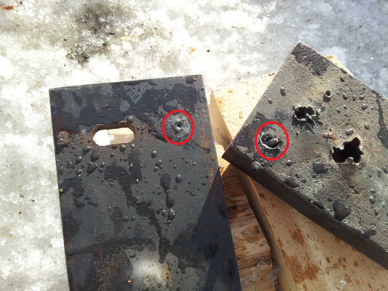

Well....that was not really what can be called a success, although comparative effects are quite obvious...
"Charge II" with the waveshaper at 2,4CD standoff (30mm):
WP_20150320_015.jpg - 1.3MB WP_20150320_017.jpg - 1.4MB
The crater closer to the edge is the one with the waveshaper, the one further from the block edge is the control without any waveshaper in the design. Both were 7g capacity and at the same 2,4CD standoff. Both performed very unsatisfactory in terms of penetration depth.
WP_20150320_018.jpg - 1.4MB
Cut open the "charge II" channel and measured the depth...only a meager 17mm:
WP_20150320_019.jpg - 1.3MB WP_20150320_020.jpg - 1.3MB
I did not grind open the "charge I" crater but mesured the depth with a thin wire and it was more or less the same 15-17mm....
I've had 15mm with exactly half the charge capacity under similar conditions and clean entry channels at 40mm standoff.
Bad cones? they were from the same batch that I've used for all of my experiments so far. Unfortunate misalignment of both cones? Very possible scenario. Tougher steel target? Perhaps, although it seemed pretty mild when touched with a file. Lower detonation speed due to using castor oil insted of methyl riccinoleate as plasticiser? Possible, but not very likely...
The charges portrayed here were pressed under arbor style press, all the others before I've compacted by hand.
I'm at a bit of a loss here to be honest...
Ok...all that aside, when we look at the entry points it is pretty much clear that the waveshaper design has much better focus in terms of jet formation. It shows a lot of promise if the kinks are worked out :) The control charge on the other hand is utterly out of focus and the whole crater is a total mess...this is THE most unsuccesful shot of my entire SC career :D

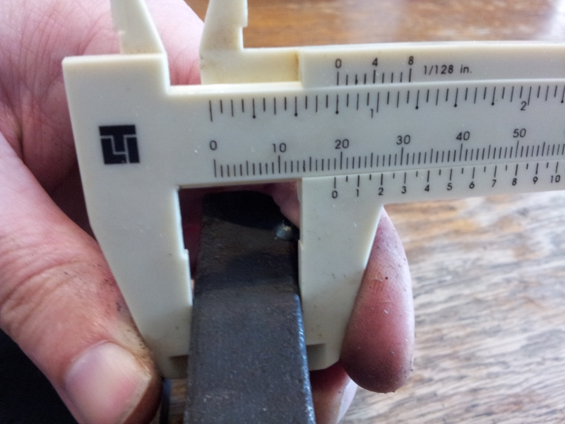

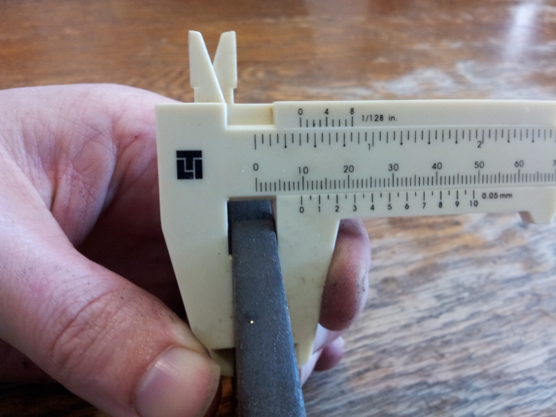

Just performed a very successful test with one of these little 1/2" steel cones. The picture below shows 4g of plastique but with additional casing room left another gram was added for a total of 5g. The plastic explosive used was from the same batch as was used in the last test (80% ETN). The target was one 3/4" plate and one 3/8" plate, one stacked on top of the other. Standoff used was 2.5CD. The liner was not secured but simply held in place once again by the adhesive forces between it and the plastic explosive.
The jet did completely penetrate both pieces of steel, but just barely. A little flap of steel was still left attached on the bottom piece of steel though a hole was blown clean through on one side of it. The hole was so small by the bottom of the last piece that the diameter was even smaller than a pin. The carrot was once again driven into the top plate plugging the entry hole. The tops of the plates are shown in the first picture and the bottoms in the second. Another picture shows the bottom of the bottom plate where it can be seen that the jet escaped but left a little flap of steel still attached.
Explosive: 5g of 80% ETN Plastique
Penetration: 1.125 inches or ca. 2.86cm (28.6mm)

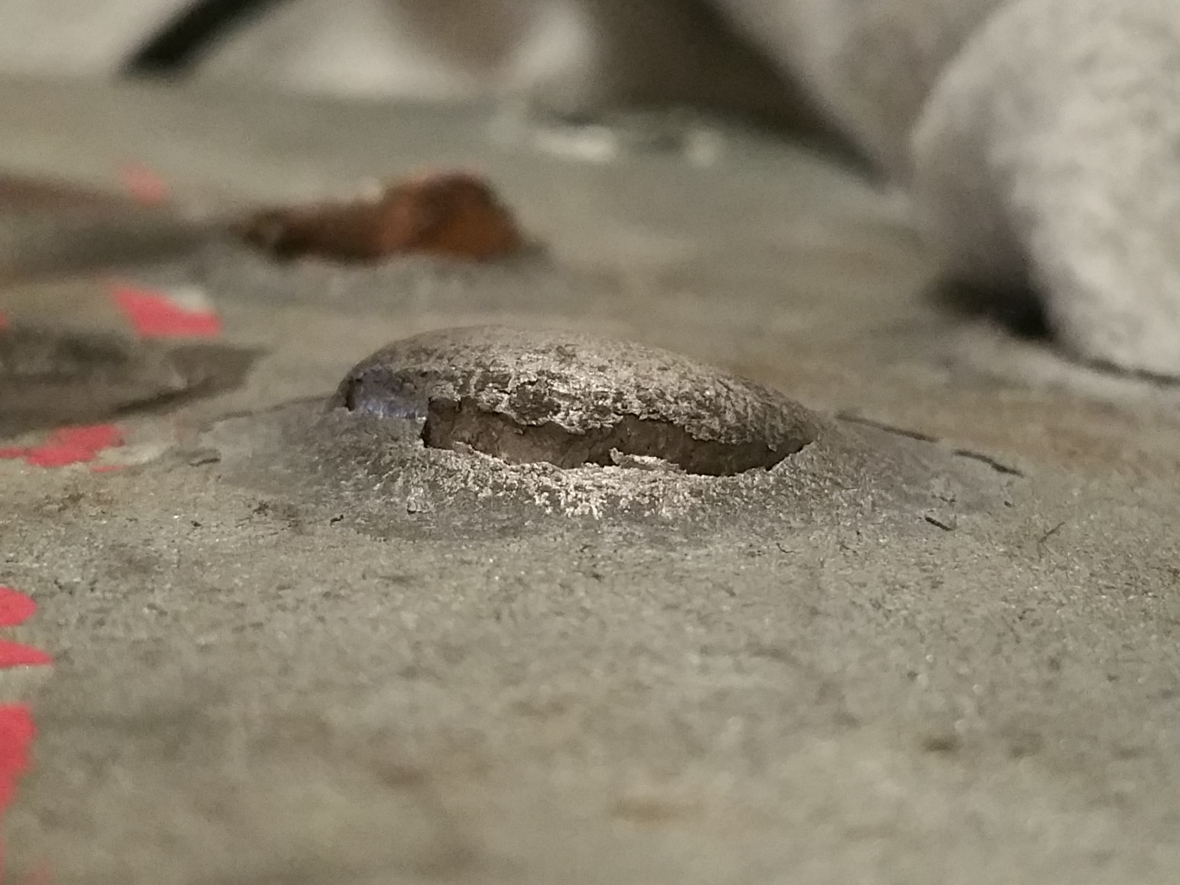

I think that thick carrot slamming into the top of the target may be at least partly because the cone wasn't anchored, but I have only done two tests with an unanchored cone so I am not completely sure. It is interesting that even at a 2.5CD standoff the result was about the same as with 1.5CD standoff with regards to the large carrot being fused to the top of the steel target and plugging the entry hole.
markx - 22-3-2015 at 08:22
The scene with the carrot is really interesting...I've had similar, but not quite that epic appearances. And these happened with really small charges below 3g capacity with the carrot mostly splattered into the target like an efp, yet the jet itself passed on strong. Over 5g charges have always managed to disintegrate the liner or fuse it to such a degree that it is no longer distinguishable from the target. I did manage to catch one tough, on the 15mm target test. It was a really well formed specimen that I preserved with great care...a literal carrot and it stuck by a thread on the exiting verge of the crater. I could remove it from the target with just my bare fingers :D
