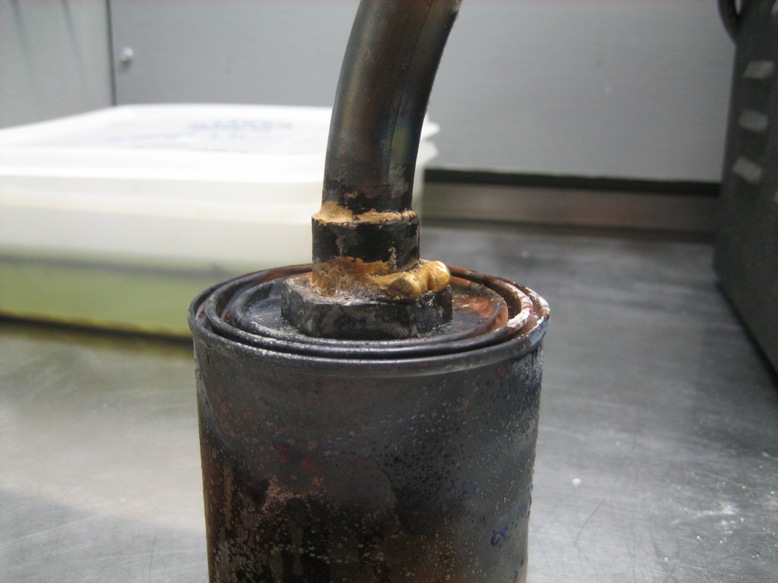

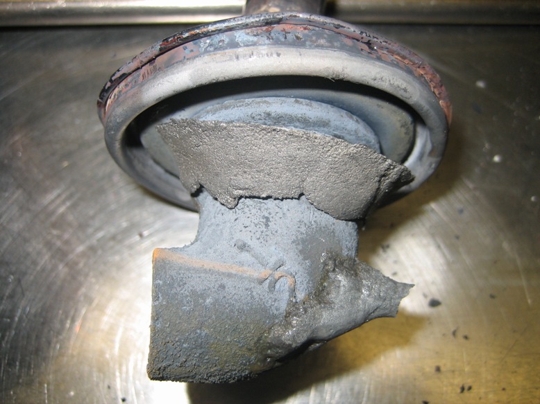

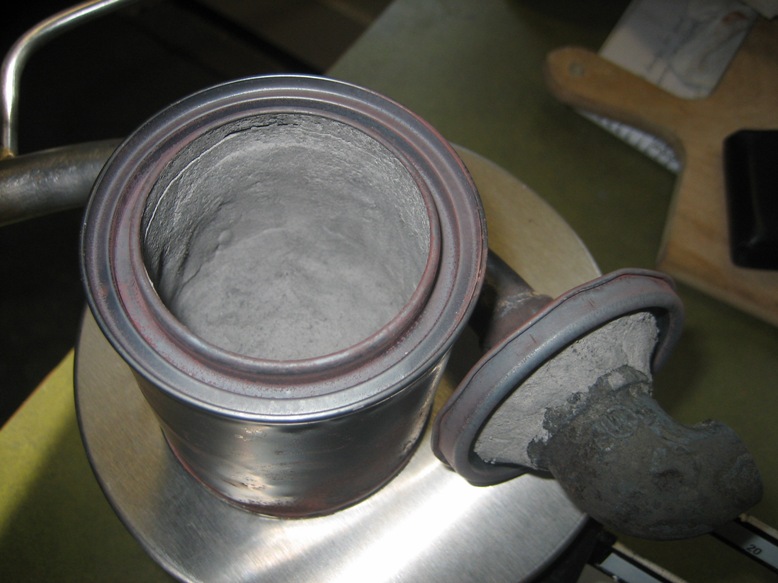

A 25g charge using boria was run yesterday (run#6). The paint can retort was lined with 1cm of Rutland’s “Chimney Sweep” furnace cement. After ramming the cement in place the retort assembly was heated slowly to 260C per Rutland’s instructions to cure the cement. The assembly was then heated to 750C to burn off the tin plating on the can and to drive off remaining water from the cement. The finished pieces are shown below:
retort with furnace cement.JPG - 105kB
Retort with furnace cement
Ground Boria was mixed with the aluminum and ground NaPO3 by mixing in a capped bottle to keep out moisture. The mix was placed in the retort, previously back-filled with argon. The assembly was placed in the furnace, the thermostat set for 750C, and heating was begun. When 750C was reached there was as yet no reaction so the temperature was held there for 15 minutes. The thermostat was then set for 800C. Shortly thereafter the reaction began and a steady, slow production of P, burning PH3, and white smoke occurred. The P was of very good quality, ie, white and uncontaminated. The weight of P was 1.0g for a yield of 27.8%. The P is shown in the picture below:

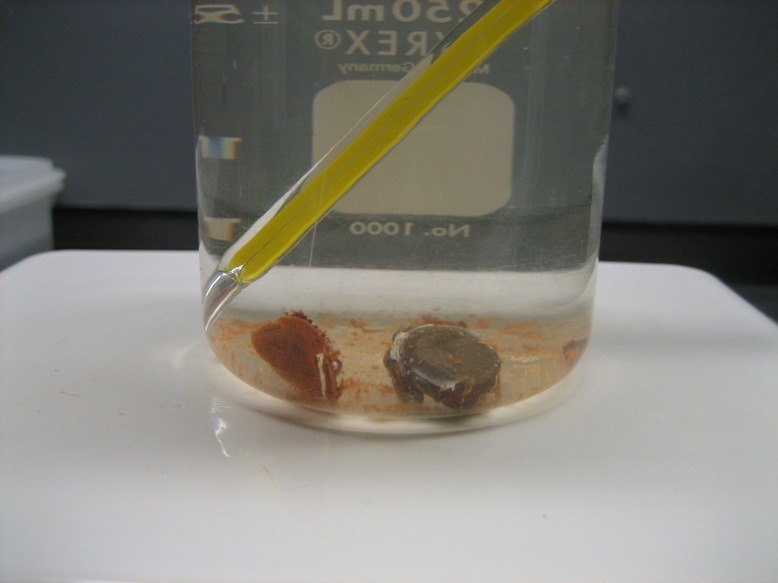

run#6 phosphorus.JPG - 72kB
Run#6 phosphorus
Today the retort was removed from the furnace. It was covered with velvet colored rust as shown here:
run#6 fired can with rust.JPG - 69kB
Run#6 fired can with rust
The fired weight of the assembly was 2.9g heavier than the unfired weight. This could be due in part to the formation of that rust. Also, the ~530g weight of the assembly is at the upper limit of my scale’s capability, which may be introducing some inaccuracy.

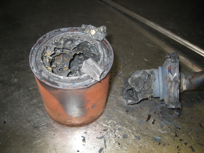

The assembly was then opened. This was done with difficulty as the lid was stuck to the can. You can see that the slag vacuoles are very large. The inlet to the snorkel was again about 50% plugged with slag. The opened assembly is shown here:
run#6 retort assembly opened.JPG - 131kB
Run#6 retort assembly opened

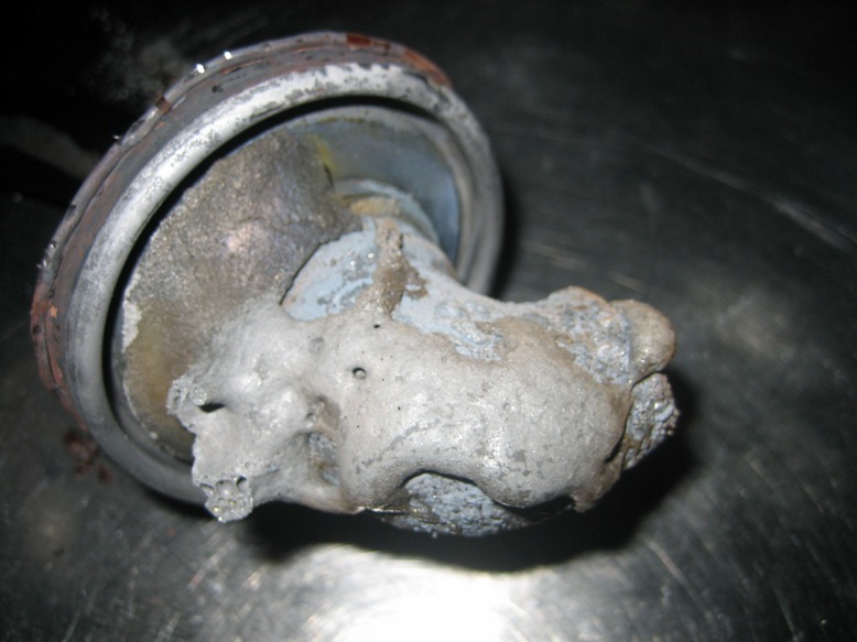

The final picture shows the snorkel and lid being removed from the condenser. The technique shown here is now routine:
removal of snorkel & lid from condenser.JPG - 136kB
Removal of snorkel & lid from condenser

I decided to cut the charge in half from the previous run because the furnace cement lining had consumed nearly half of the can’s available volume. I believe this lining width (1cm) could be cut at least in half for future runs. The cement is a very tough material and was completely undamaged by the firing.
The 27.8% yield is the best I have achieved with any of my phosphorus making runs. It is also noteworthy that the production was slower and steadier than that of any of my previous runs.

Phosphorus run #7 was made yesterday using a charge of 35g based on the following stoichiometry:
6NaPO3 + 10Al + 3B2O3 ---> 6NaBO2 + 5Al2O3 + 6P
This is ½ the boria used in the previous run #6. To this was added 1.3g of Al for a 15% excess. This formulation is based on a report of success by Strepta (p.14, this thread).
This run was unusual in that at first glance it seemed to be a failure. That is, only a couple of small drops of white P fell into the receiver upon initiation of the reaction, which was quickly over. Then I noticed that the outlet of the condenser was nearly plugged. Digging with a steel rod with a hooked end I pulled this plug out. It can be seen as the dark object on the right in the picture below:
contaminated P plug.JPG - 70kB
Contaminated P plug
At first I wasn’t sure what this plug was composed of as it was so dark. However, upon warming to above 40C in the receiver it liquified, as would be expected for white P. It weighed 2.5g for a yield of 41.7%! Although some of this weight is due to contamination, based on its melting and solidifying behavior, I think it is a minor amount.

The yield was 3.2g for a %yield of 42.0%. That for run #7 was 41.7%.
Although the outlet of the condenser was at all times heated to around 55-60C by the water in the receiver there was some P deposits found in the end of the condenser. They would catch fire as I pulled them out with a spatula.
The retort was difficult to open and was found to be full of slag. The disassembled retort is shown in the photo below:
Attachment: phpqQu8nV (129kB)
This file has been downloaded 1101 times
Disassembled retort ass’y for run #8
The snorkel and condenser inlets are plugged solid. This is shown in more detail in the photo below. The condenser inlet is shown at the top; the snorkel inlet is shown at the bottom.
plugged snorkel & condenser inlet run#8.JPG - 126kB
plugged snorkel and condenser inlets for run #8
This is due in part to a charge that is apparently too large. A 2nd factor is the inadvertent use of too much furnace cement lining. The lining weighed 189.3g vs 57.9g for the last run. Also, this lining had bulged out in several places thereby decreasing working volume. This is thought to be due to the addition of too much water to the cement, which was added to improve workability. Actually the cement can be rammed into place without the addition of water.

The charged retort assembly was placed in the furnace and the thermostat set at 750C. Just before reaching this temperature the reactants ignited. There was some burning phosphine and smoke and then chocolate colored P came rapidly into the receiver, which was heated to 47C. The weight of this dirty P was 3.7g, for a %yield of 62.9%.
Weight loss of the reactor assembly was 412.9 – 409.5 = 3.4g.
The opened assembly is shown in the pictures below:
opened retort run #9.JPG - 137kB
Opened retort for run #9
snorkel, run #9.JPG - 131kB
snorkel, run #9
I was ready to stop this series of testing, then mirabile dictu, on opening the retort I found that there was hardly any slag! The can was mostly empty! So, it seems that at least one more test should be run, ie, that with a much larger ball milled charge.
Discussion
I’m not sure what is responsible for the contamination of the P that is giving it a chocolate color. Most likely it is just finely divided reactants and/or slag carryover blown out with the rush of P vapor. This coloration first started back on run #7, which was the first successful boria run using the larger (35g) charge. Hopefully the P can be cleaned up to remove this contaminant. I will try the cleaning methods using chromic acid and HNO3 used by Endimion17.
The 62.9% yield is significantly higher than my previous best at 42.0% for run #8. So apparently the improved mixing and possibly finer particle size provide significant advantage. Since all reactants should be liquid at 750C it seems that improved mixing would be the main factor responsible for the increased yield.

I finished cleaning the crude phosphorus of run #9. I first used a chromic acid wash (K2Cr2O7/H2SO4) on a magnetic stirrer. Improved but still a bit crusty, I heated the P to 65C then centrifuged it for 1 minute. This gave no separation. Finally, I heated the P in 6M HNO3 with agitation on a magnetic stirrer/hotplate. This further cleaned it to where, although still off color, it now looks like phosphorus. This is shown below:
P from run #9, cleaned.JPG - 77kB
phosphorus from run #9, cleaned
Loss of weight due to cleaning was from 3.7g to 2.8g. %yield then decreased from 62.9% to 47.6%. This is still my best yield so far.
Magpie - 27-10-2012 at 16:00
The P from runs #7 and #8 was also quite dirty so I decided to clean it also. My plan was to use a chromic acid wash followed by a 6M HNO3 wash, as I did with the P from run #9. To my surprise the P was clean enough after just one wash with the chromic acid as can be seen below.
P from runs #7 & 8, cleaned.JPG - 70kB
The reagent consisted of 20mL water + 20mL con H2SO4 + 2.25g K2Cr2O7. This was heated and stirred on a magnetic stirrer/hotplate, and the dirty P added to it. This reagent turned from orange to a murky green/brown during the cleaning process.

Phosphorus run #10 was completed today. The charge was 52.7 g, with boria as slag former, and aluminum in 15% excess. The purpose of this run was to evaluate the effect of running a larger ball milled charge vs the 36.3g ball milled charge of run #9.
The NaPO3 was first ground in a coffee grinder for 2 minutes. This was then mixed with boria and Al in a capped bottle. This mix was then ball milled with ½” steel balls for 6.45 hours.
The paint can retort was lined with 87.1g of furnace cement. The liner was slowly cured up to 500F then the assembly was heated to 750C to burn off the tin plating on the can and remove liner water. There was no bulging of the liner.
The loaded retort assembly was placed in the furnace and the thermostat set at 750C. At about 710C the reactants ignited. This resulted in an explosive reaction – a scary event. The products shot out of the condenser, causing some water and bits of burning phosphorus to get knocked out of the receiver. There was also the usual burning phosphine, and quite a lot of smoke. The silver solder rebuild on the condenser was virtually ruined, apparently due to the intense heat developed. This can be seen in the picture below:
fired retort 2, run #10.JPG - 90kB
Fired retort, run #10
As on run #9, on opening the retort I found that there was hardly any slag. This confirms the much reduced volume of slag that occurs with the ball milled charge.
retort slag, run #10.JPG - 137kB
Retort slag, run #10
The slag, although sparse, did plug the snorkel, as shown below:
plugged snorkel, run #10.JPG - 146kB
Plugged snorkel, run #10
Additional slag deposited on the outside of the snorkel is shown here:
slag on snorkel, run #10.JPG - 98kB
Slag on snorkel, run #10

Weight loss of the reactor assembly was 445.4 – 442.3 = 3.1g.
Discussion
The results of run #9 showed that ball-milling increases the efficiency of the reaction. However, as shown by the results of run #10 the reaction of a larger charge size is too powerful to be conducted safely.
Additionally, the yield and %yield were decreased due to the explosive discharge of the reaction. Much of the P was apparently deposited in the condenser as I had to burn off a lot after the reaction during cleanup. I believe that much of the rust colored crud in the receiver is red P, further contributing to the loss of yield.
A further danger was noted in that examination of the snorkel showed that it was plugged, or very nearly so, for this larger run.
Comments, questions, and suggestions are welcomed.
