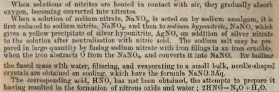

Taoiseach - 12-11-2009 at 02:45
Some interesting tidbits from "Chemistry - inorganic and organic" by Charles Loudon Bloxam (1883 lol :D):
-solutions of nitrites are readily oxidized back to nitrate by heating in contact with air.
-sodium nitrate is reduced by fusion with iron fillings, the main product being sodium hyponitrite which can be obtained as needle-shaped crystals
no.JPG - 26kB
roamingnome - 12-11-2009 at 22:03
I was reading about the iron filling bit a few days ago,
but just looking at wiki for basic information
about Hyponitrite one finds ...
can act as a reducing agent for example reducing iodine, I2,:[2] N2O22− + 3I2 + 3H2O = [NO3]− + [NO2]− + 6HI
that seems like a slick way to HI

niertap - 16-4-2012 at 18:41
Has anyone tried the nitrate to nitrite reduction using iron filings? I've heard heating nitrates with lead works well, but heating them with iron filings seems like a better and quicker method. Would it work? If not what would be formed?
[Edited on 4-17-2012 by Polverone]
chochu3 - 16-4-2012 at 21:07
There are no experimental details of using iron, hence asking if anyone has tried and not posted here about it. Any way tried the reduction with lead you do have to stir frequently and is superior because of lower mp than if you were to use iron. But if iron is all you have go for it. Post back whatever findings you have, would love to hear the outcome.
niertap - 16-4-2012 at 21:27
I saw a little bit about it in a thread about the creation of K2FeO4, but nothing concrete.
I've been thinking about that and from user experiences it seemed like K2ferrate, iron oxides, and or nitrates could form. I'm assuming higher heats cause two nitrites to react with an atom of iron to form the ferrate; lower heats possibly just causing the nitrate -> nitrite reduction, producing Fe2O3.
The completely thermal approach appears to the reaction seems unpredictable, so I am currently trying an aqueous approach. Transition metals seem to be very good at catalyzing oxido/reducto reactions.
