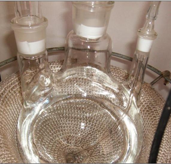

Jimmymajesty - 5-9-2009 at 08:15
The first picture is talking to itself... the tube were filled with copper foil peeled off from gauging rods ;)

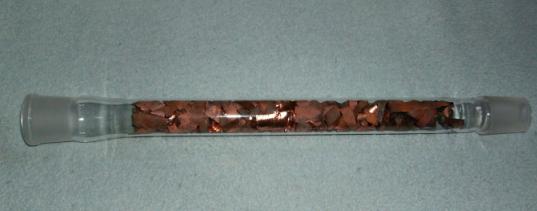

The second is destined to illustrate the small tube in the three necked RB flask. It is necessary for the continuous reflux of ethanol.

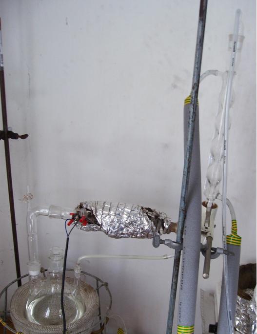

The setup is on the third picture...
The condensation front in the condenser was kept at the level of the second bubble IIRC.
I inserted two scrubbers opposed to each other to the end of the plastic tube so as to the starting point of the oxidation would be indicated, when the reaction started I sampled the generated gas once in a while in a test tube, smelled and lit it... it seemed to mainly consist of hydrogen because it was odourless and burned with a blue flame in dark.
I am gona buy a controller for the next run too to keep the reactor temperature below 300°C.
I saved the milk like product, which I think mainly consists of aldehydeammonia... I do not know what to do with it in this form... any idea?
picture 01.JPG - 14kB picture 03.JPG - 35kB
picture 02.JPG - 57kB
Klute - 5-9-2009 at 17:32
Beautifull setup! Unfortunate that the experiment wasn't very conclusive.. Please let us know of futur tries!
