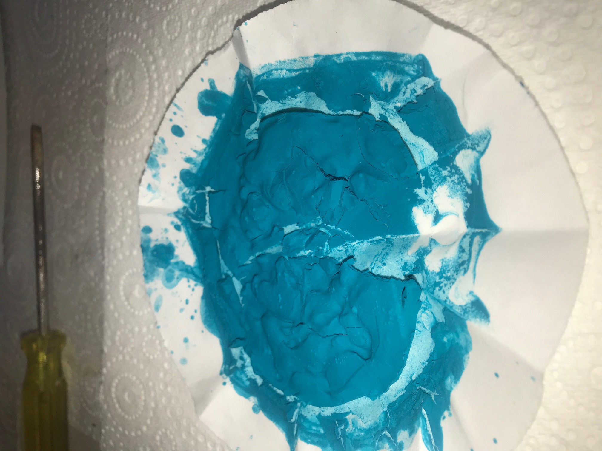

Muhammad - 22-2-2017 at 00:49
So I followed the steps for the synth of copper acetylsalicylate. I didn't get an immediate formation of precipitate, just a formation of a greenish blue solution. I checked an hour later and crystals were forming on the sides and the base. The crystals are insoluble in water, have and greenish bluish hue and And slightly remind me of tiny acetate crystals. Have I done it right?
Copper (II) acetylsalicylate precipitation
Muhammad - 10-9-2017 at 00:39
I did a precipitation with copper II sulfate and sodium acetylsalicylate and the product did not precipitate immediately. instead it crystallized on the walls of the container over some time. Was this precipitation? I do not understand what happened.
VSEPR_VOID - 10-9-2017 at 11:38
Try posting your entire procedure, sources, pictures, and how your prepared the reagents in your reactions. Your post is not detailed enough. IF you can read it in 30 seconds its most likely not worth posting.
DraconicAcid - 28-9-2017 at 11:53

- Vacuum filter and wash once with excess of cool water in the funnel. Photo below of the wet remainder. The filtrate had a very pale magenta color.
2 wet remainder.jpg - 490kB
