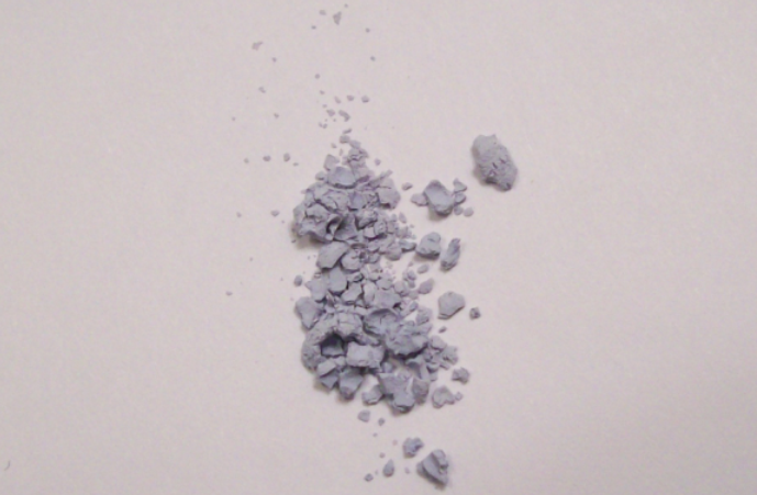

I retried the experiment of Taoiseach and now I had partial success. I took some copper sulfate and dissolved this in 12% ammonia, I added just enough ammonia to get all of the copper sulfate dissolved. This gives a deep blue solution. To this I added a few drops of highly concentrated solution of sodium azide. When this is done, the color remains deep blue.
Then I added 96% ethanol, approximately the same volume as the deep blue aqueous solution. Again, this results in formation of a purple/blue precipitate. This time, however, did not keep the precipitate, but the liquid. Once the precipitate had settled at the bottom, the liquid had a green/cyan color and it was fairly dark. This liquid was allowed to stand for many days. After several days, a crop of nice green glittering crystals was at the bottom of the test tube. These crystals were put on a piece of filter paper, in order to absorb most of the liquid and the crystals were allowed to dry in a warm place in a petri dish for a few hours.
The dry material consists of many small needle-shaped green crystals, some of them glittering very nicely. The material looks nice. Some of these crystals were put on the tip of a screw driver and this was put in a flame. The result is a soft crackling noise and many little sparks are created. Some larger crystals give a somewhat louder PENG sound, but not an impressive bang. Most beautiful, however, is the color which is given to the flame. When a crystal of the material crackles, it produced many fine particles, which give a beautiful green color to the flame of the alcohol burner. This is due to the copper content of the particles.
So, again, I did not get the heavy bang explosive, but the material I obtained was cute and had funny properties. My conclusion, however, is that making the ammonia/azide complex of copper(II) is not that easy, one easily ends up with other compounds.

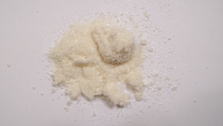

Yesterday I made a complex salt. On the forum it was previously mentioned, that this complex exist, but there was nothing else wrote from it. I found some information in: Encyclopedia of Explosives and Related Items - Fedoroff - Vol 7 of 10, but there was also just written, that this compound exist, but no other information.
The complex was prepared by the following way: a freshly prepared solution of copper perchlorate (from copper sulfate and sodium perchlorate) and hydrazine hydrate solution was reacted with each other and a brown precipitate formed. It was filtered and washed with water.
The brown precipitate when heated decomposes slowly and thus can be easily dried. It detonate when contact with flame. It can not be stored it decomposes to nitrogen, water and copper perchlorate. After 4 hour storing the compound, the copper-perchlorate-s blue color can be seen on the top of the complex.
Anyone got idea to a stable hydrazine-metal-perchlorate complex? The nickel salt detonates immediately. Maybe I will try the complex with Cd, Zn perchlorates.
