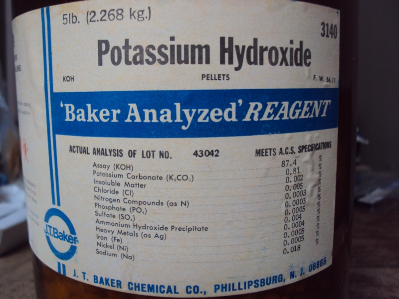

Is KOH really the limiting quantity with a 76% yield, if using a stoichiometric quantity? According to the same book as above, I could have gotten a yield of 86% KN3 or 90% NaN3 by this method.
I just went through the stochiometry, and there was about 5% excess of KOH used. I think there may have been some NaOH carry over from the freebasing too (slight excess used there as well). I was using my notes that I used before for the NaOH method, and just increased the amount to adjust for the heavier potassium cation, so I must have used an excess with the NaOH method as well. Now that I am actually looking at the bottle of KOH, it says Potassium Hydroxide Reagent, Assay (KOH) 87.4%, Potassium Carbonate (K2CO3) 0.81%, and a list of other trace contaminants all totaling 88.24%. The balance must be water. The container is well sealed.
I guess I could be off by a certain amount, but I don't think it is more than a couple percent. Thanks for pointing that out, I hadn't thought it all through actually.
I am very happy with this method. It isn't quite as quick or as easy on alcohol as your method, but it is simple and straight forward using only a flask as equipment (a stirrer helps a lot to dissolve the hydroxide in the alcohol though). Potassium Hydroxide might be a little harder to obtain than NaOH for some people.
KOH bottle.JPG - 356kB
BTW, we may need to add a couple more percent to the yield. I kept the reaction liquid after collecting the crop of potassium azide. I just looked now and there is another small amount which has precipitated in the last day or so. If I am going to keep saving it, I have got to stop keeping it in plastic bottles.
