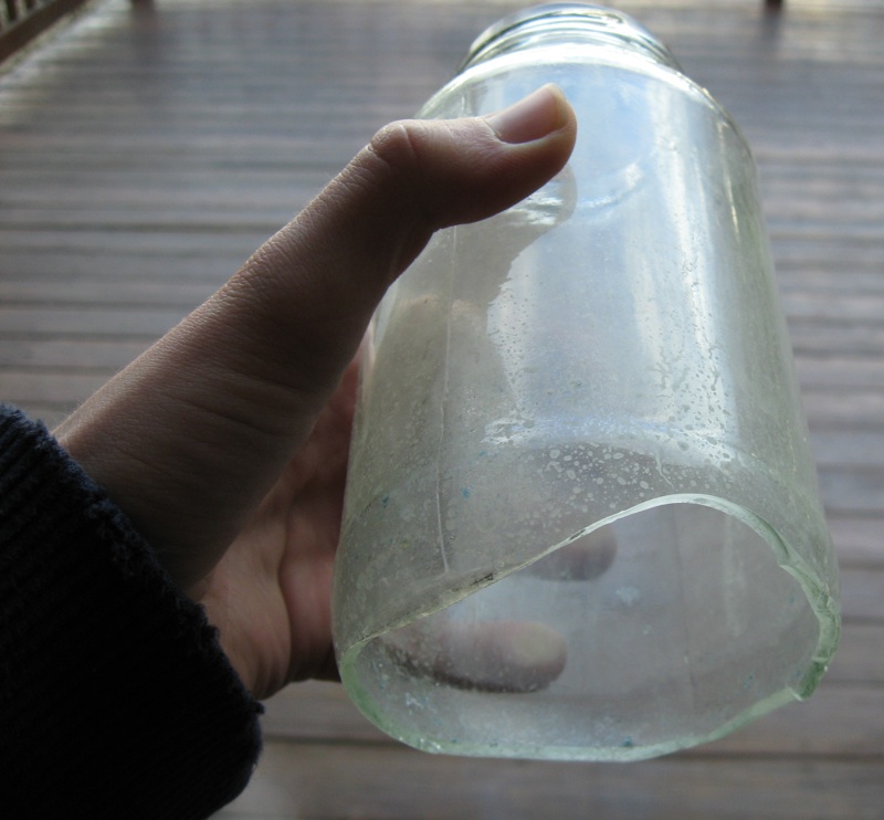

My first bad day was when I was concentrating sulfuric acid in the back yard in my first set of newly purchased glassware when I heard the door bell ring. I look into the house through the window to see that it was the pest control guy. I freaked out and blew out my bunsen burner, grabbed the flask with a towl, and then grabbed everything else I could see and ran inside the house with it. As I ran into the house I forgot to grab an empty flask that I had out there for some reason and my foot hit it. When it slid away it tipped over and a large portion of the lip broke off and sent a crack down the side. After laying down the stuff I was using inside the house I ran out and grabbed the broken flask and the chunk that broke off. Soon after I shut the door the guy comes around and sprays the house. My first sad moment in chemistry.
Ow, it always hurts when glass breaks. :( What kind of flask was it? A cheap erlenmeyer? Or a 3-neck 12 liter RBF?

lol! like I would have a RB 12 liter 3-neck F just sitting around! XD it was a 500ml erlenmeyer. I was so new that I actually believed that I could fix it with only a propane blow torch.

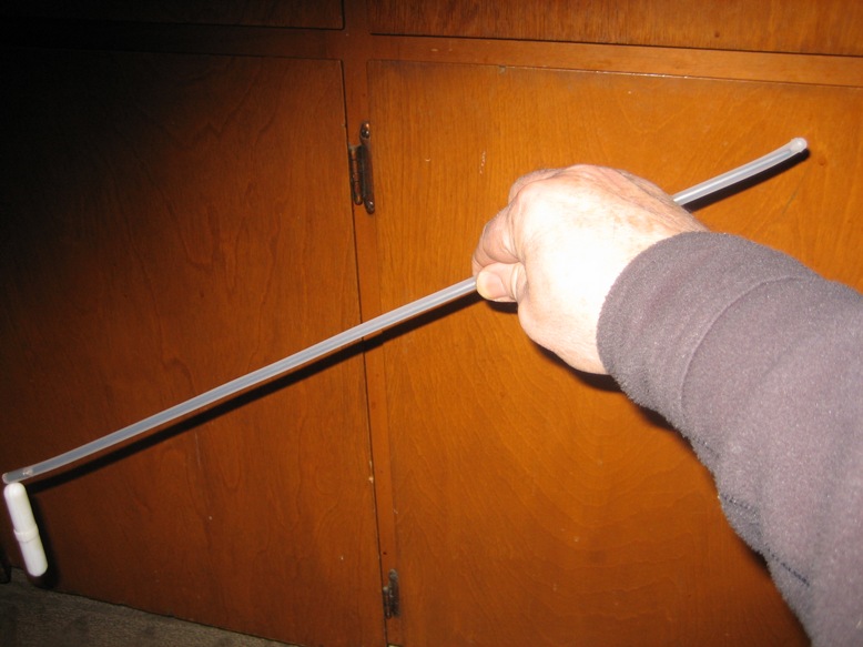

make yourself one of these:
http://www.sciencemadness.org/talk/viewthread.php?tid=13156&...

Finding that I often wish I had one of these but am not willing to pay the $20 + postage, I made one of my own. Here's how:
* Buy 2 feet of 0.17"ID polyethylene tubing ($0.34)
* Buy one 3 foot piece of 1/16" steel rod (~$2)
* Buy one 3/16"OD x 1/2" long cylindrical neodymium magnet ($0.27) (Note 1)
1.Heat about 3/4" of one end of an 18" piece of poly tubing in boiling water to soften it, then force fit the magnet into it, leaving about 1/4" of the end of the tube open.
2. Fuse this end of the poly tube by heating it on a stove, working the end to a seal. Try not to overly heat the magnet as it will lose its magnetism if heated to 80C. (Note 2.)
3. Cut the steel rod to fit in the poly tube leaving about 1/2" of the tube end open.
4. Fuse the open end of the poly tube as before.
Notes
1. The economics are hurt here if you have to pay postage on the magnet like I did. This came to about $5.
2. It might be better to buy an undersize magnet, say 1/8"OD instead. That way you could slide the magnet in later after fusing the end to a seal, and wouldn't have to risk heating the magnet. These Nd magnets are tremendously strong.
[Edited on 23-1-2010 by Magpie]

Speaking about bad days with glassware, I was messing around, minding my own business when this happened:
IMG_0391 downsize.jpg - 119kB
I know soda lime glass crack under the slightest temperatire changes, but I ramped up the heat extremely slowly, bringing the water to a boil in 40 minutes. The whole bottom usually doesn't blow out when I'm this careful, it's the first time.
I guess the glass had some internal stress to begin with, oh well bad luck I guess.
I gotta get me som'o those polarizers next time:)
That doesn't look like glassware. It looks like a pickle jar. They are not known for their heat resistance.
Indeed, I use plain old mason jars to store chemicals, mix them or react them if they are only mildly exothermic, but I have stopped using them to heat/boil/react stuff in them if it might be a bit too intense. I have had jars fracture simply because I have removed them off the hotplate or water bath.
It is safer to boil or heat stuff in a proper borosilicate vessel, using mason jars or mayonnaise pots to heat/boil/react stuff is at your own risk, and if the vessel breaks, you lose your chemical you've worked on and run the risk of ruining your heating device at the very least.
Yes, but believe it or not, I tested one of these out one time to find the limits of these jars, and I was able to bring water to a boil (quickly) and sustain a boil for more than 20 minutes without it breaking.
I suppose you can get lucky sometimes. For the record, I never boil anything of considerable value in jam jars. In this case, I was extracting urea from fertiliser. I was boiling about 100mL of water mixed with approximately the same volume of fertiliser and ramped up the heat really REALLY slowly. I've had some instances where the glass gave a warning, cracked but didn't break completely. I was hoping for that, but instead the whole bottom blew off without warning.
