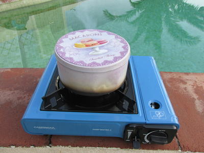

Bought a new Pyrolysis Rig today for 20 euros :
newrig.jpg - 38kB
[Edited on 20-2-2018 by aga]

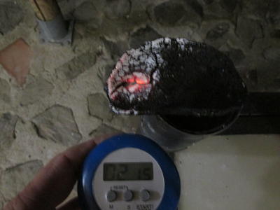

aga - 20-2-2018 at 11:29
Forgive me if it's been covered, but I couldn't find anything about it. Has anyone tested it's resistance to oxidation at prolonged heat?

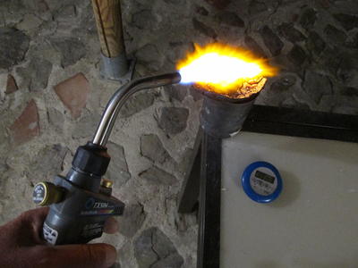

If you call 2 minutes 'prolonged' then yes, just now, due to your question.

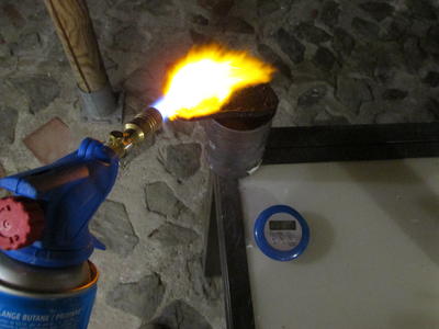

This slice of rye bread didn't come out too well with the new pyrolyser - it isn't conductive.
Here it is raw, subjected to 2 minutes under a 70% Butane/30% Propane flame, then the other side was subjected to 2 mins under a MAPP gas flame.
fresh.jpg - 29kB
buburn.jpg - 34kB
buresult.jpg - 32kB
mappburn.jpg - 35kB
mappresult.jpg - 33kB
This particular sample was a bit iffy to begin with, yet shows how durable it is under heat, even in air.
After this test the toast fell apart when it was picked up. Big chunks, but definitely in bits.

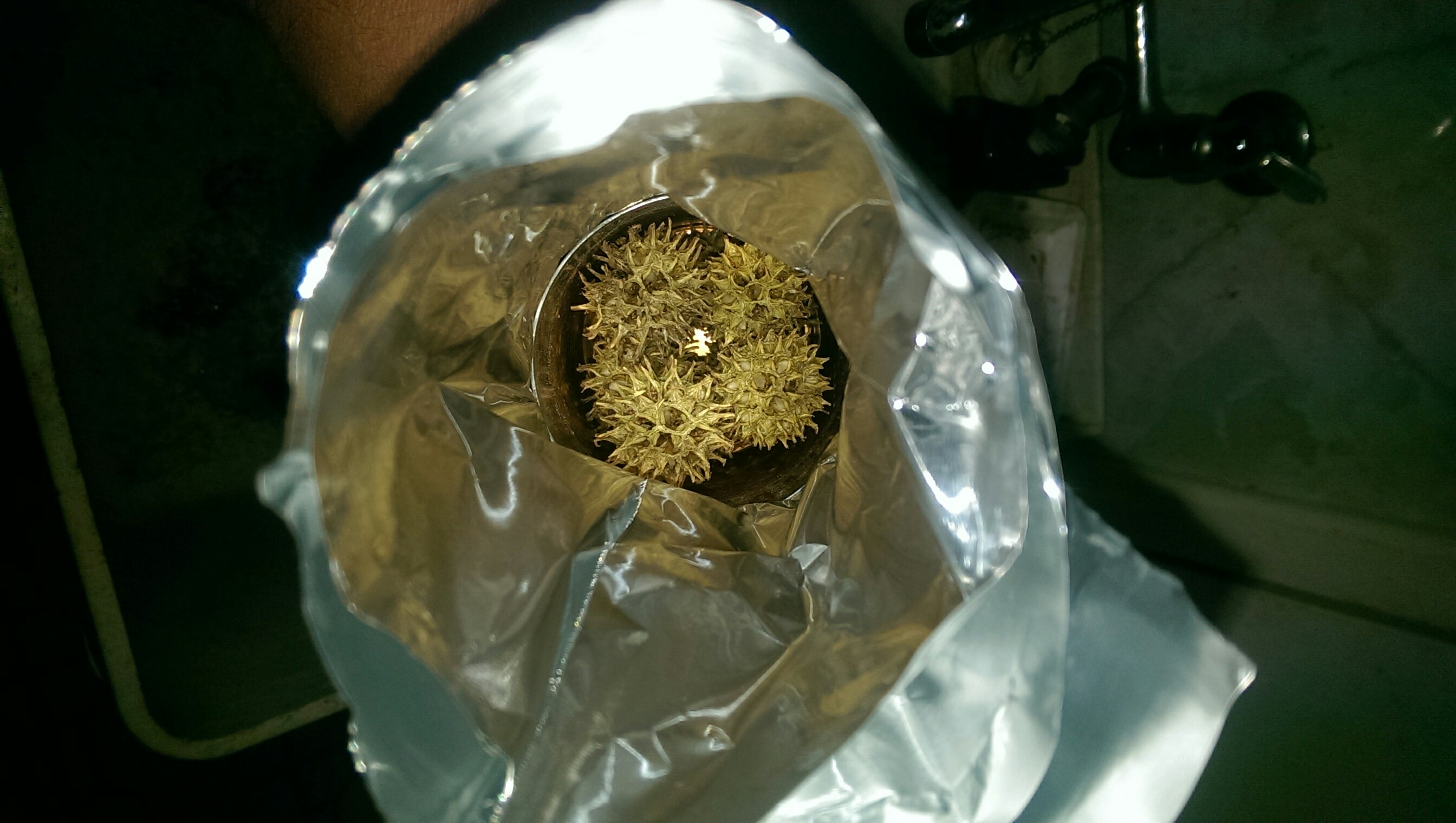

Latest attempt
- the bake my own bread option went out the window with roof repairs and family time. But bbq dinner offered a shoot from the hip opportunity. These are seed pods from a tree in my yard, a sweet gum.
Pre incineration,
IMAG5349.jpg - 405kB IMAG5351.jpg - 856kB
Post roast
IMAG5352.jpg - 796kB IMAG5353.jpg - 822kB
IMAG5354.jpg - 1.1MB IMAG5355.jpg - 1.1MB
I have a feeling that there may be more loss on further torment. The aluminum foil was as shiny as ever, and the cans label was faint though legible. But they are crispy/brittle. My plan to invest as little time as possible succeeded, family didn't miss me for long. Just closed the bbq vent 95% and walked away.
Every experiment leads to a wealth of ideas for next time on this one for me. Gratifying, cheap, full of room for insane detail if the free time arises.
Drive to work offers thinking time. Takeaway this morning : seed pods can retain geometry... Things like dry cereal such as Kix or cocopuffs could be great preforms... Rice crispy treats are moldable... Rice itself is fairly consistent... We can have compact or foamy preforms to use as ingredients.
So adulterated rice crispy treats and a crap-ton of sample compositions will eventually have to be tested.

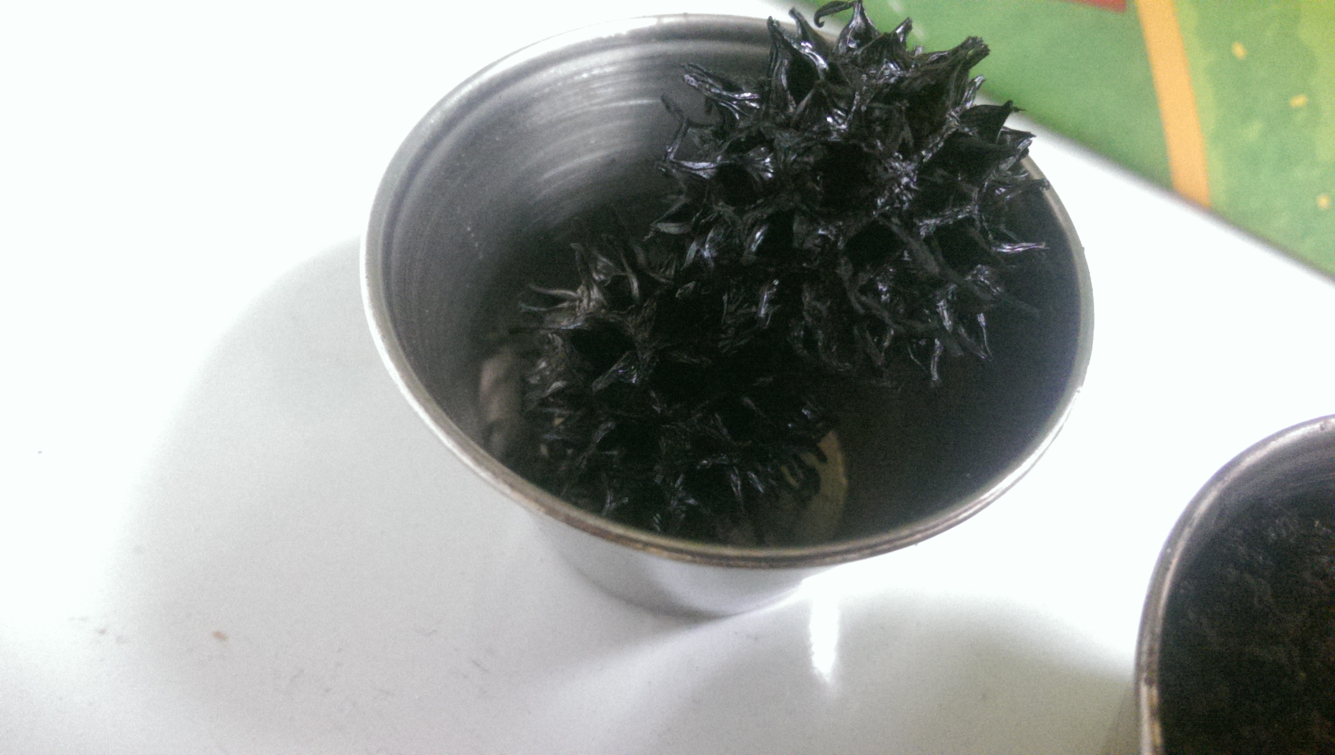

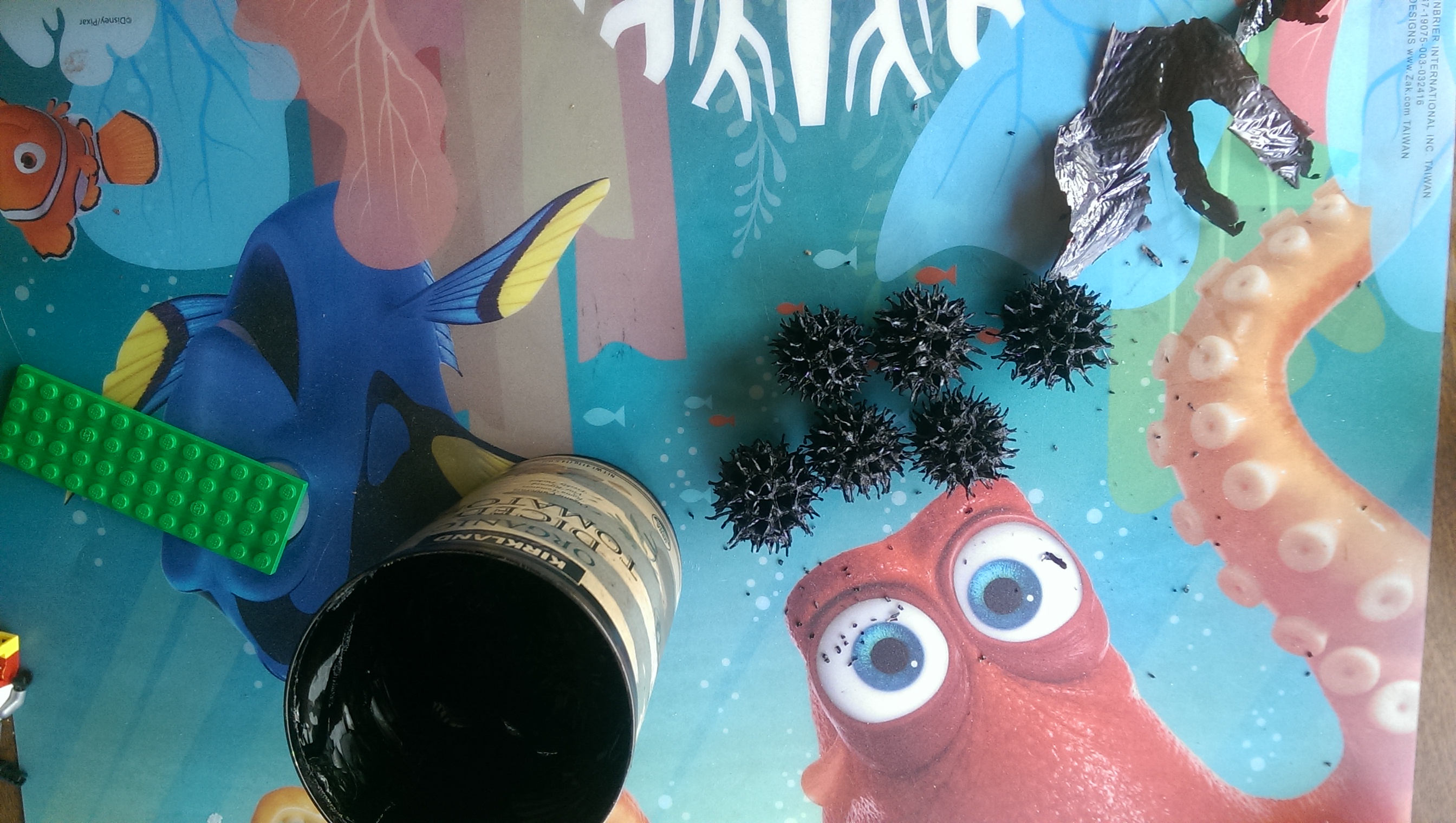

Tried a second firing on the sweet gum balls, not measured first time. One trial of two balls lost 5.26% more on second firing. Not a tremendous amount and the shape/size distortion was minimal. Though I did not get a caliper on them during any of this.
IMAG5392.jpg - 836kB ^ v IMAG5391.jpg - 980kB

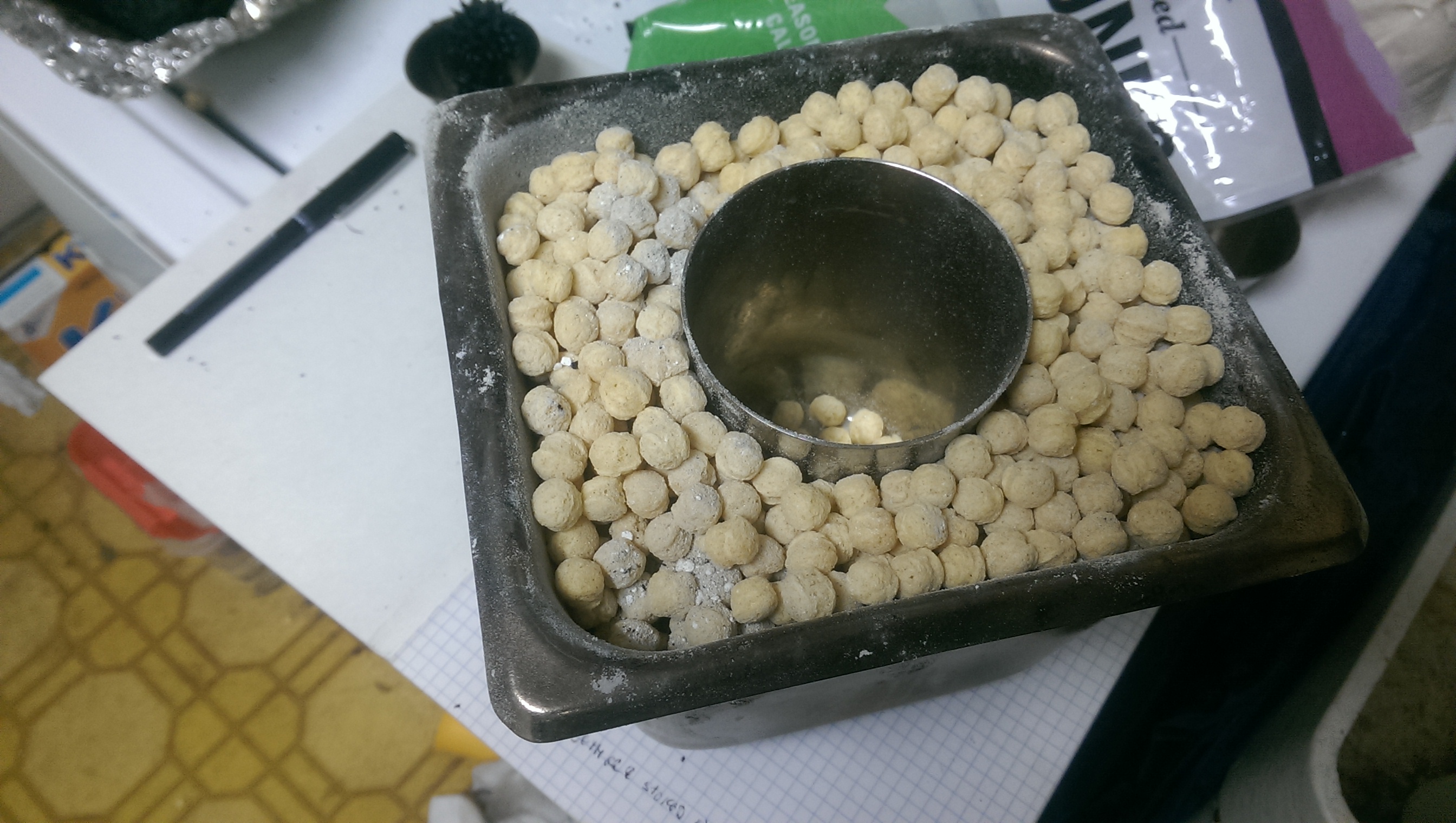

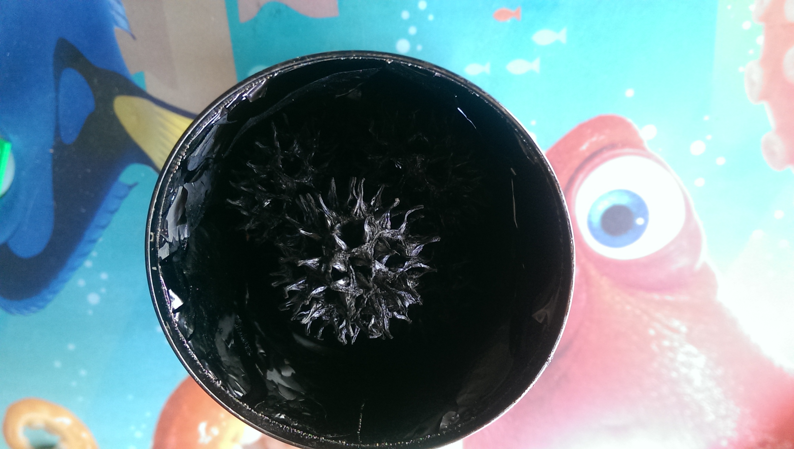

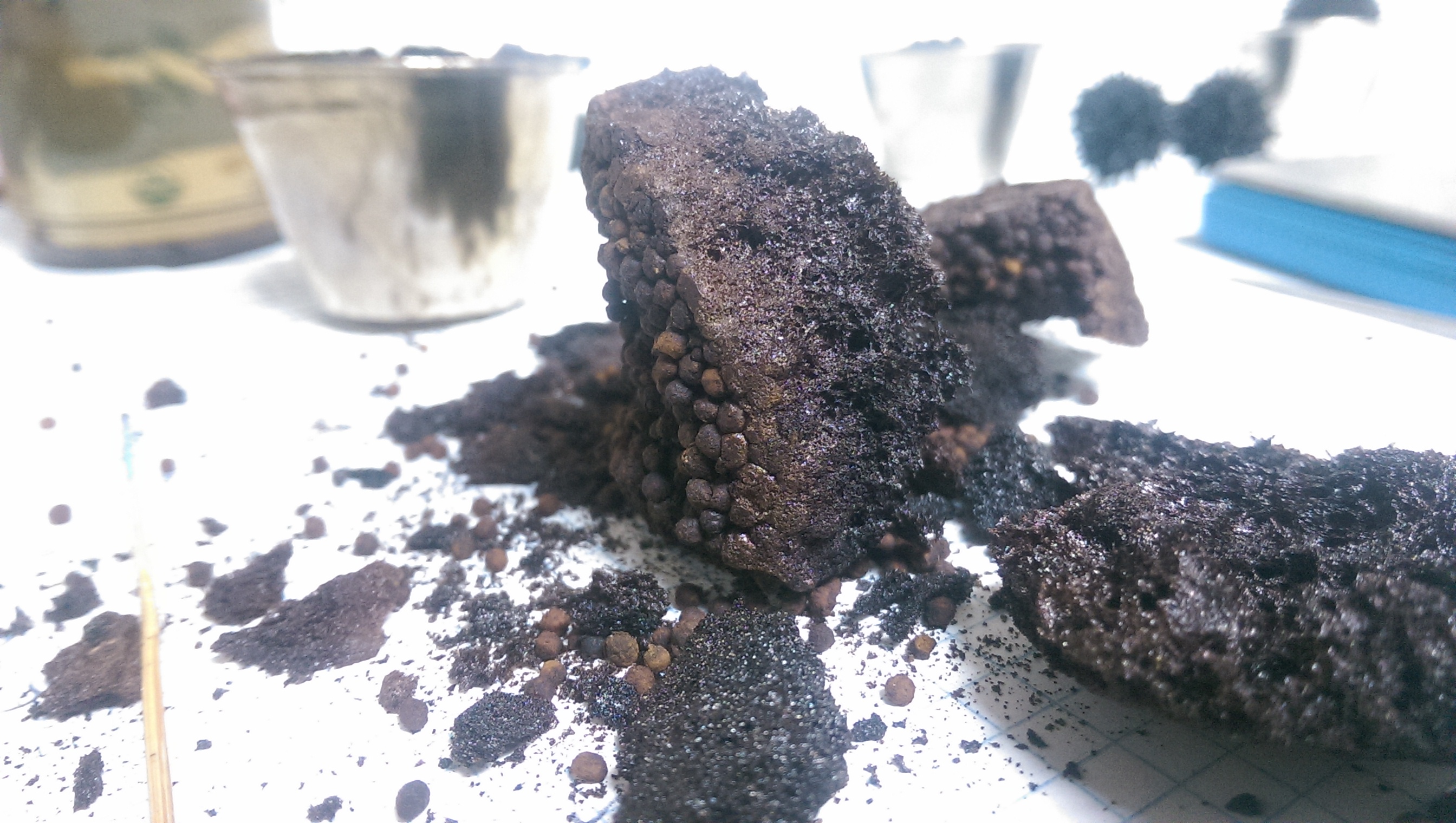

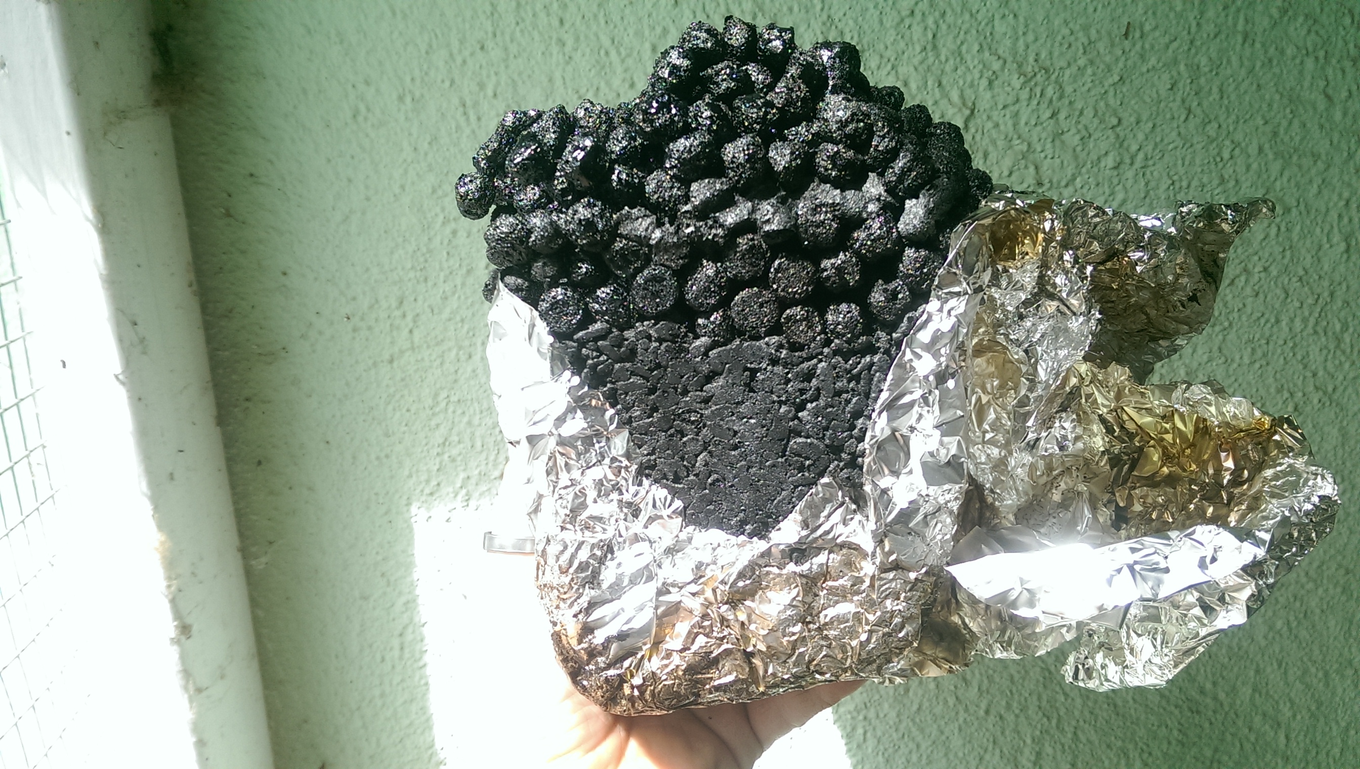

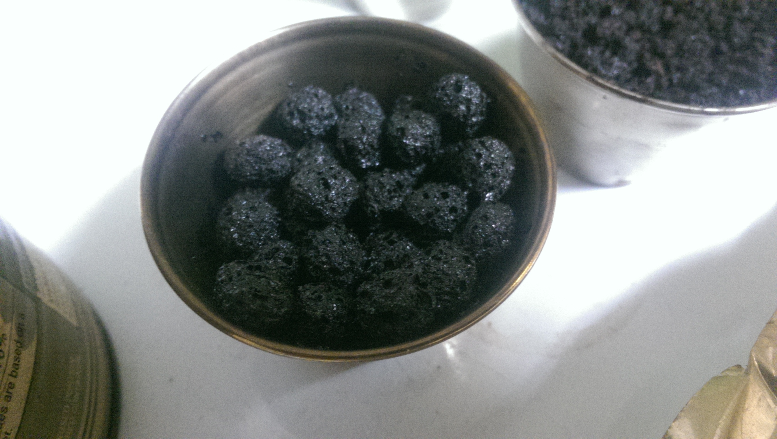

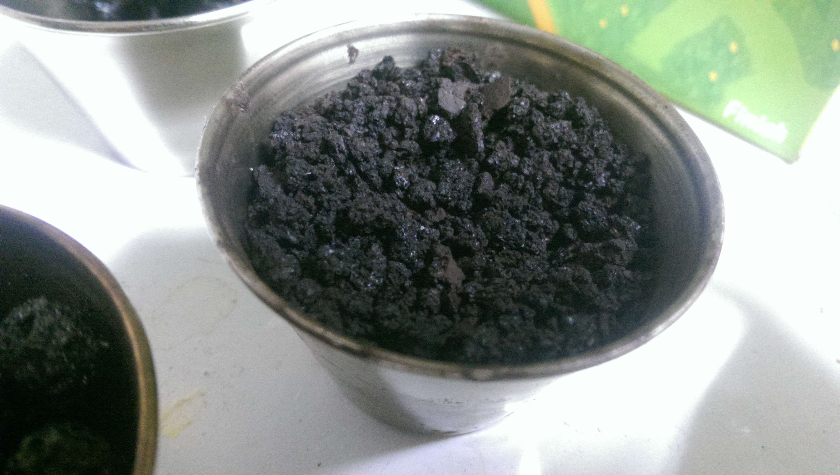

Newest test run, same steamer insert form and ss cup center form.

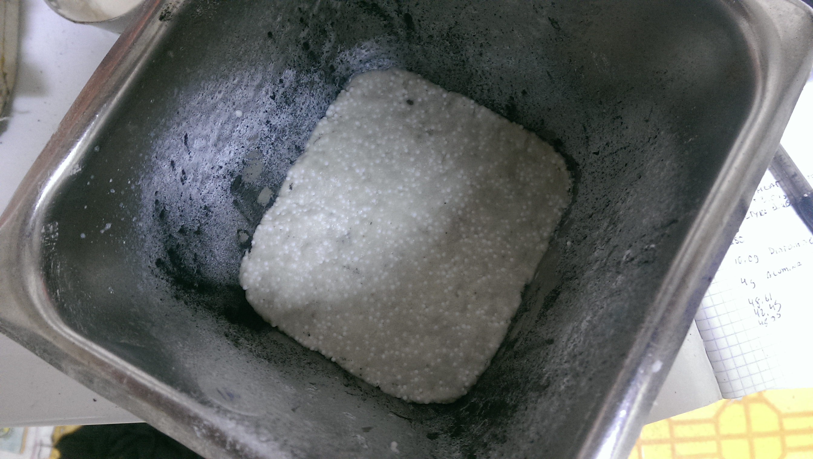

IMAG5518.jpg - 1.3MB IMAG5521.jpg - 1.3MB
-(Pic 1): New kind of frosted puff cereal cap and rice crispy (w/ starch/sugar binder) side shot
-(Pic 2): consequence of over fill was cooking on side = separation rift largely empty.

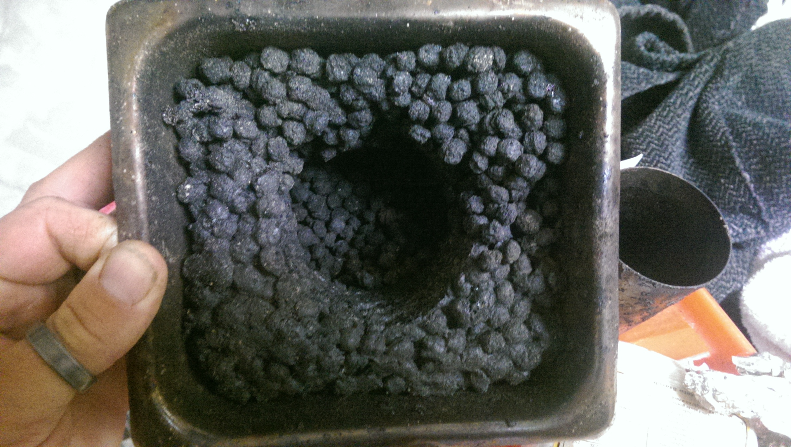

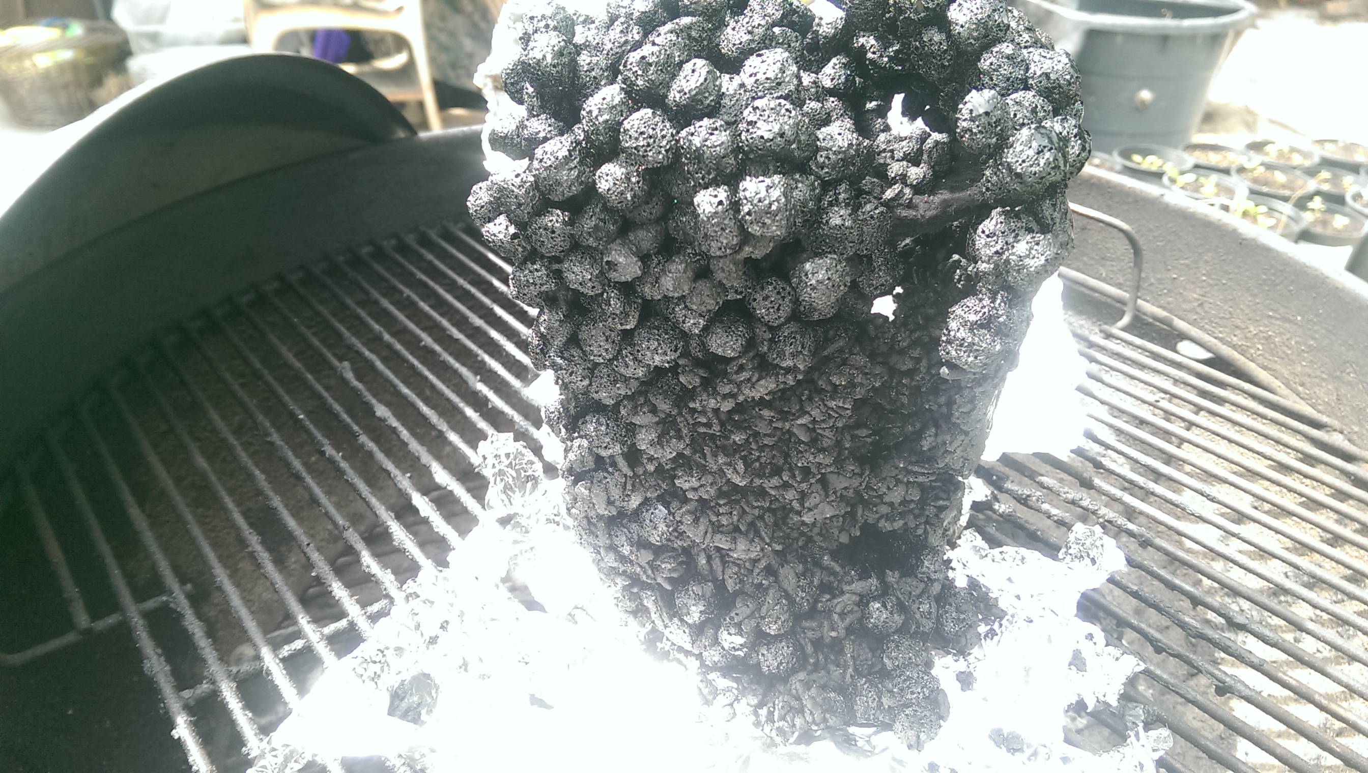

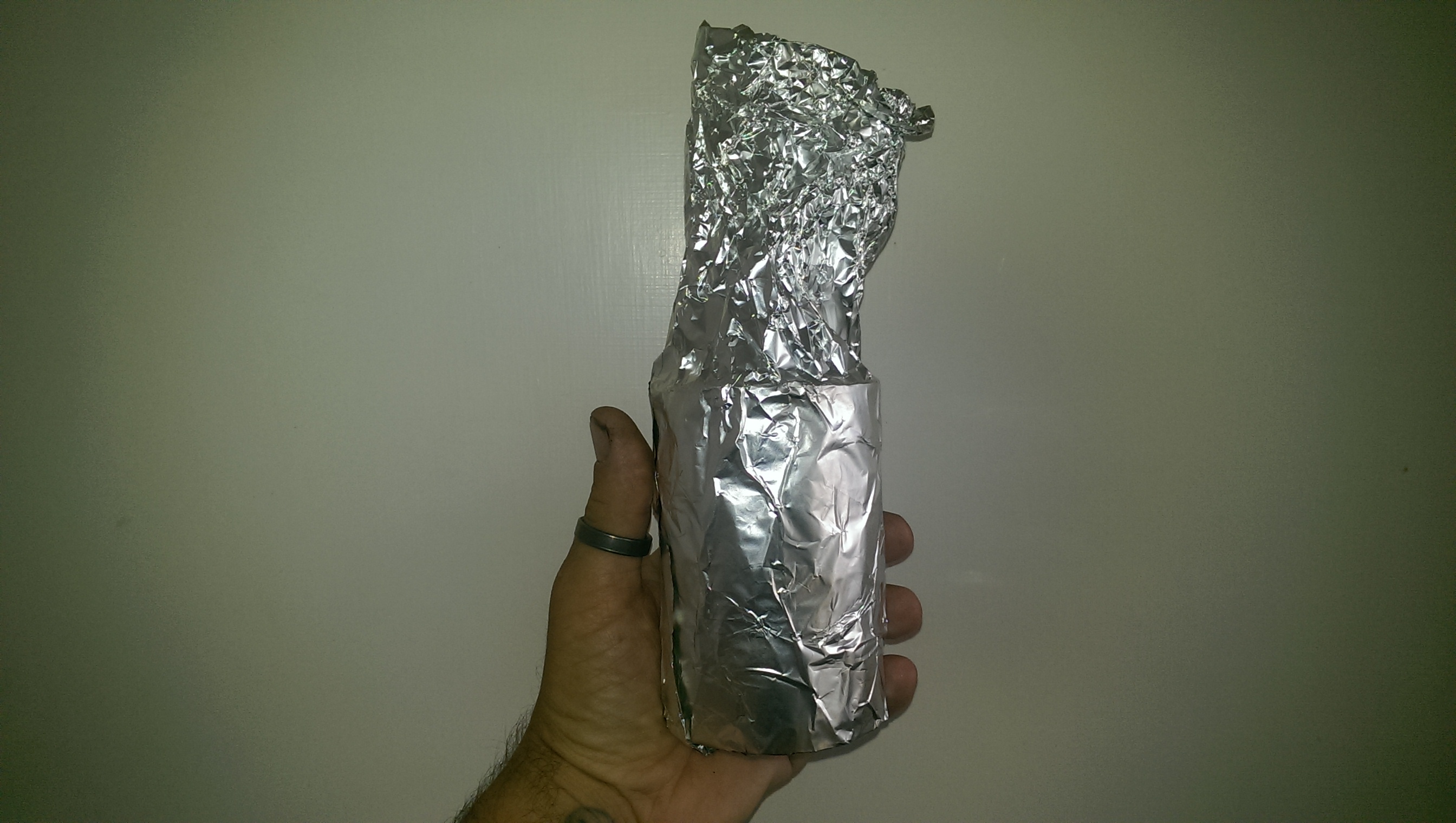

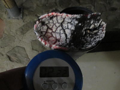

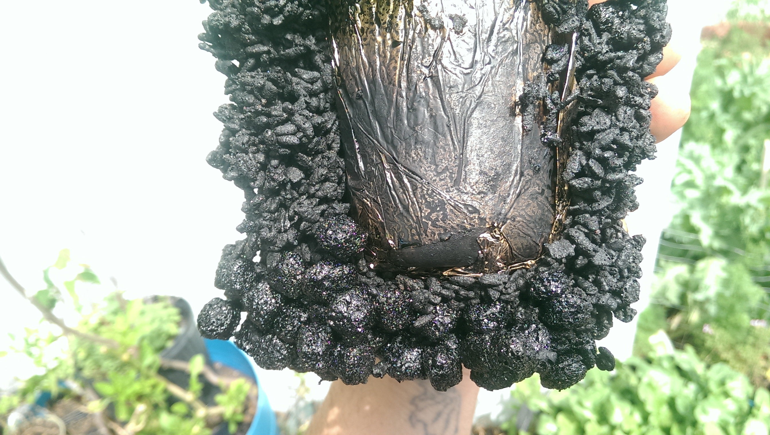

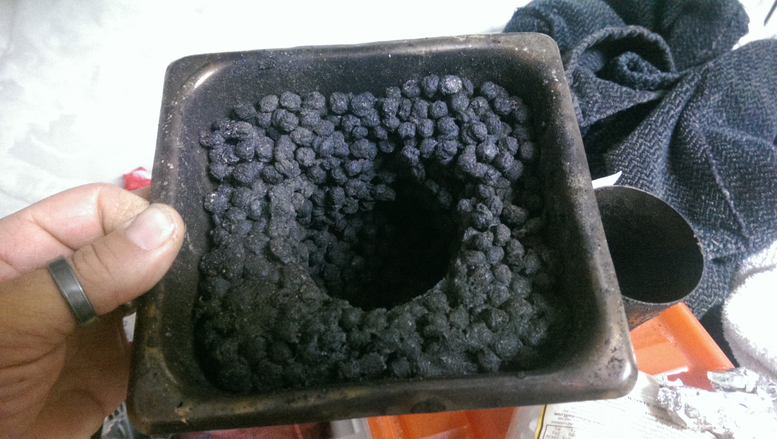

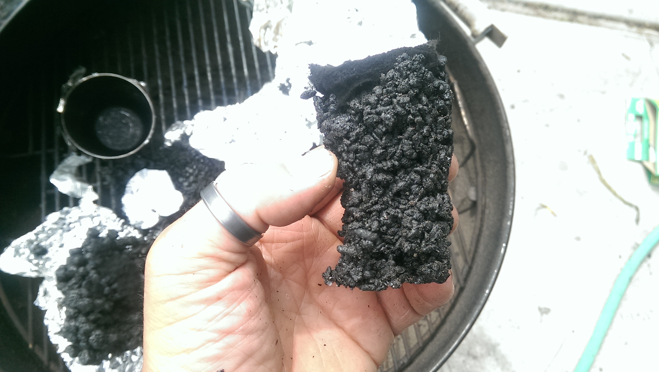

IMAG5527.jpg - 1.3MB IMAG5533.jpg - 1.4MB
-(Pic 3): Side shot of strata. Was surprisingly TENACIOUS grip on the center form cup,

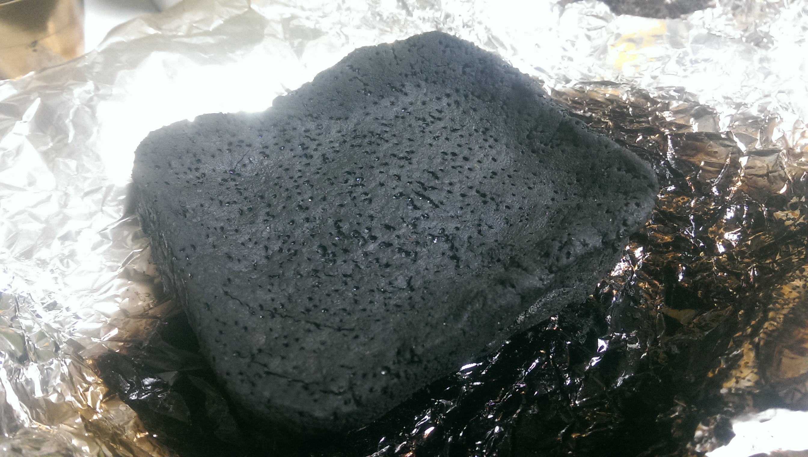

-(Pic 4): frosted chunks, sans adulterants, really hold shape with minimal contact.

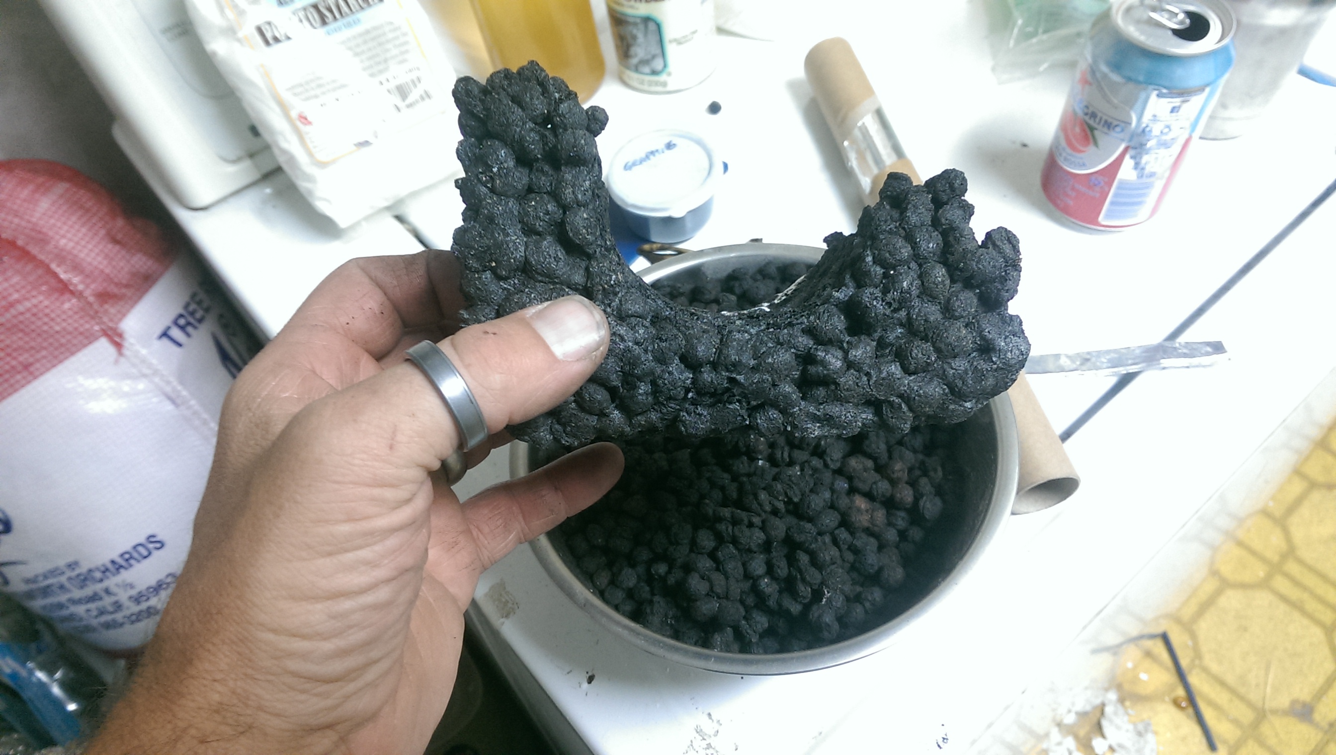

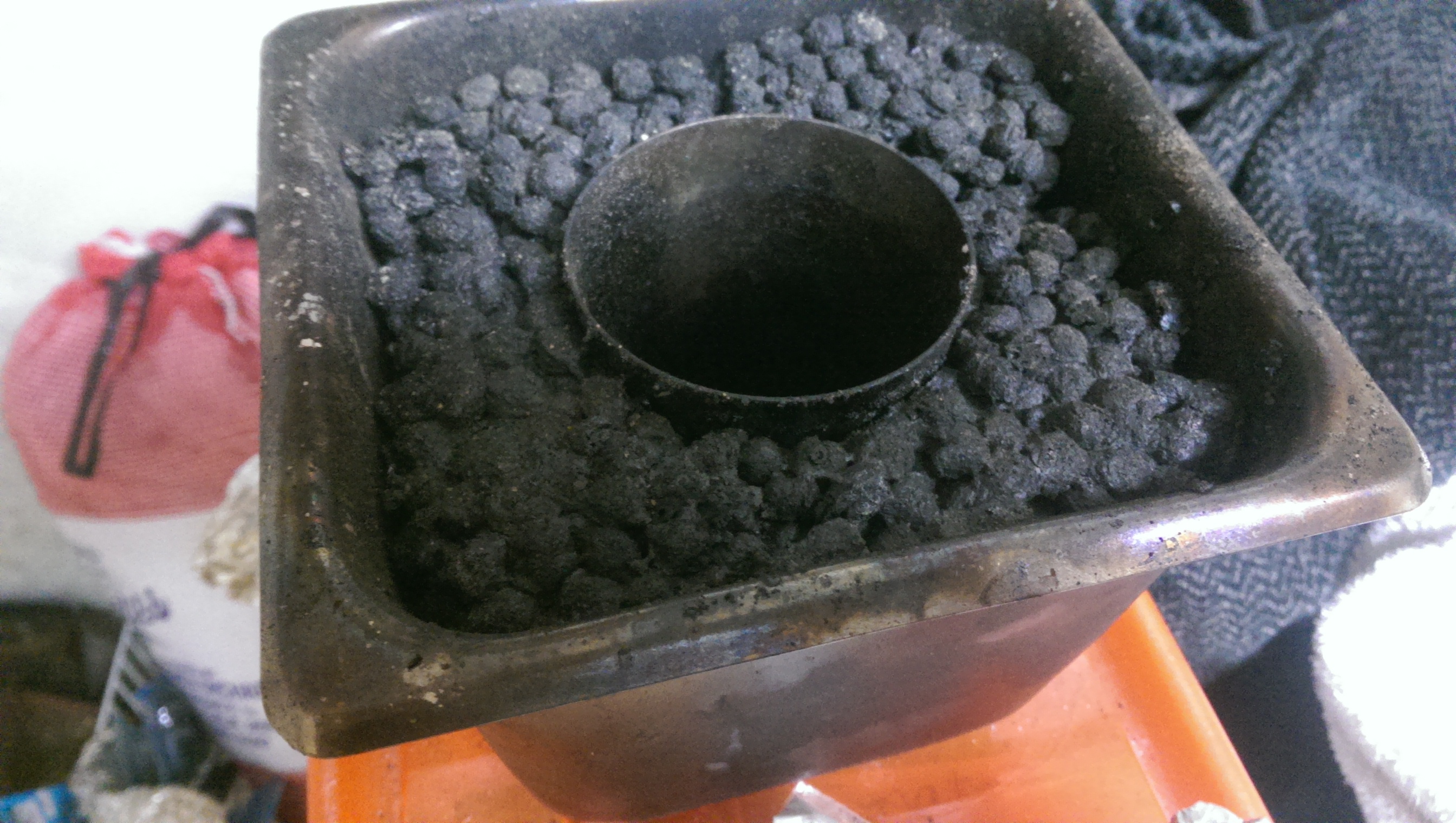

IMAG5540.jpg - 866kB IMAG5507.jpg - 882kB

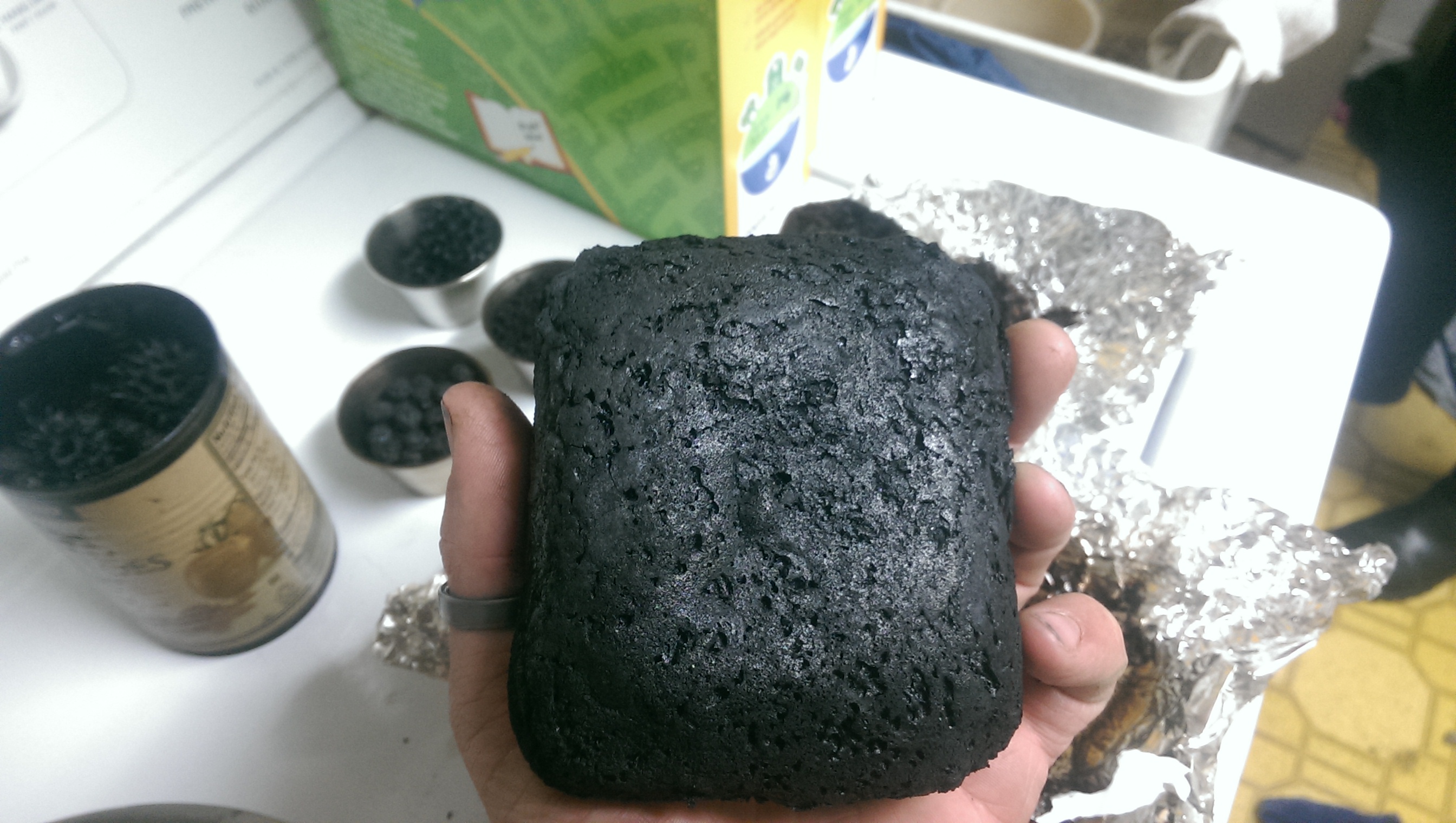

-(Pic 5): rice crispy preform from center cup, shrunk a lot, but I did add a fair amount of water to make moldable consistency.

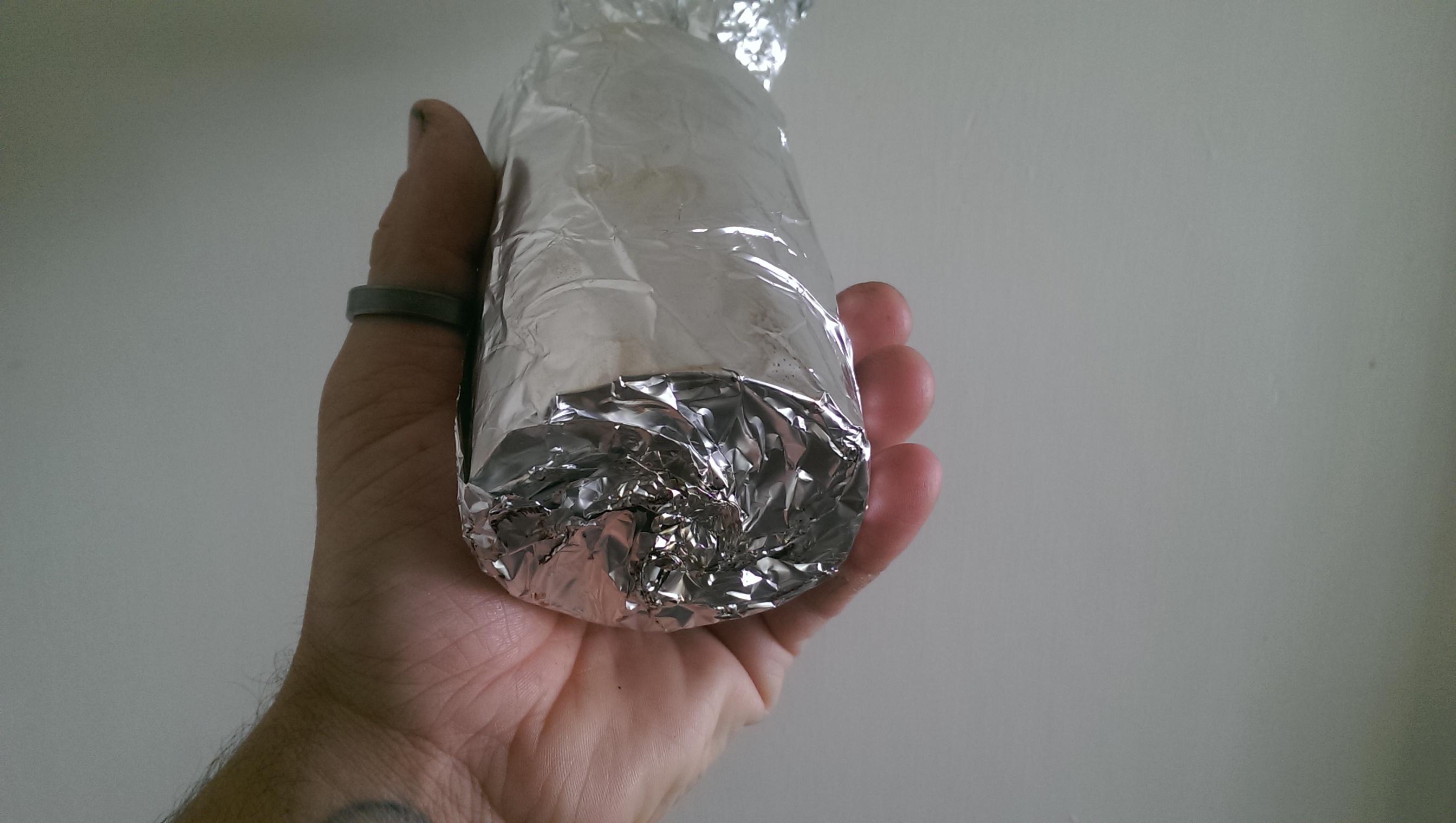

-(Pic 6): removed chunk of last experiment.

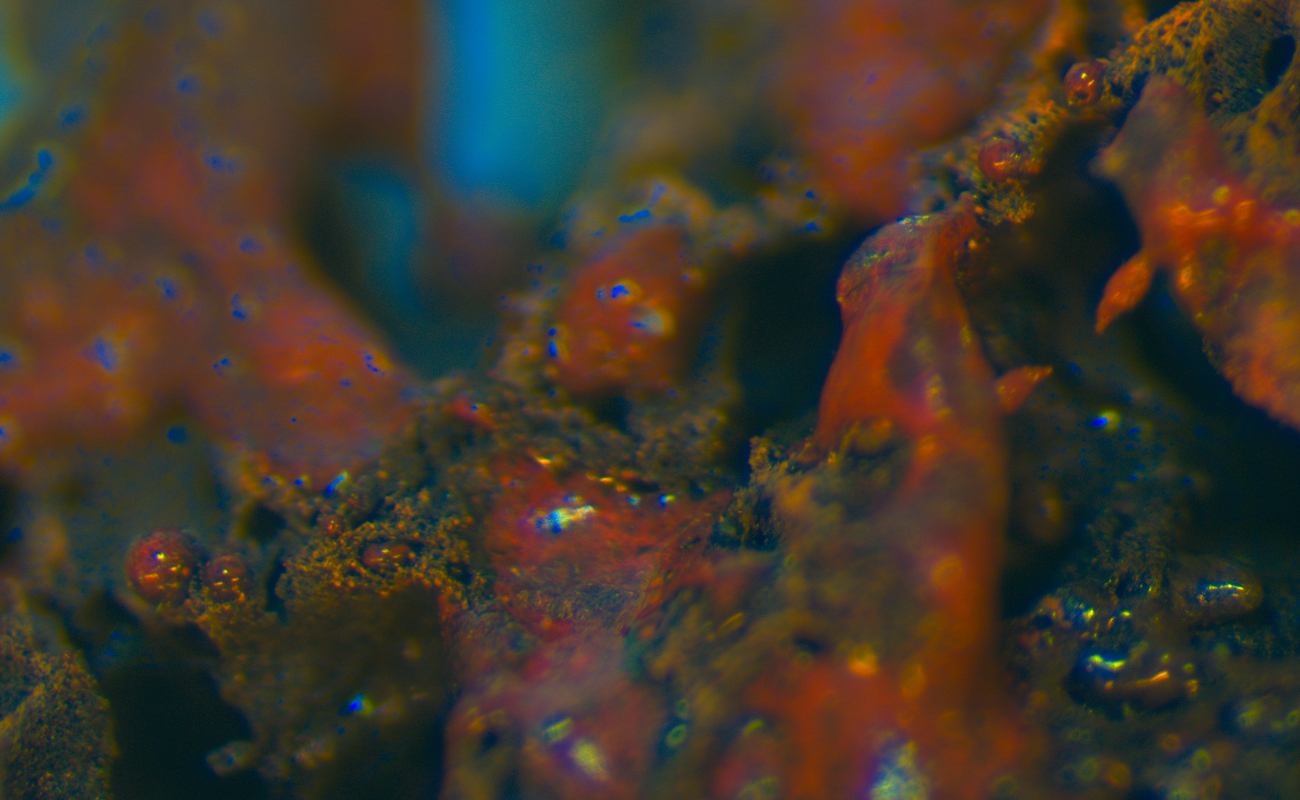

I did a few exploratory experiments with these carbon foams and a sodium silicate solution (waterglass). I tried three basic treatments:
* repeatedly soaking in waterglass, then dilute sulfuric acid, then rinsing
(Na2O)x·(SiO2)y + xH2SO4 -> xH2O + ySiO2 + xNa2SO4
the idea was to coat or permeate the foam with silica. The foam was baked to dry after each dunking in the waterglass, which led to the formation of many tiny sodium silicate bubbles. These structures survive the acid treatment as this photomicrograph show. At high magnification, there appear to be small silicate needles on the carbon.
roastedSilicateWide.jpg - 1.3MB roastedSilicateBub.jpg - 959kB
It seemed to stand up to a MAPP gas torch pretty well; afterwards, the pores of the carbon foam seemed to have been filled with a bubbly/crystalline silicate
blazedSilicate.jpg - 1MB
* soaking in boric acid, baking to dehydrate to boric trioxide, then soaking in waterglass
(Na2O)x·(SiO2)y + zB2O3 -> (Na2O)x·(SiO2)y·zB2O3
Boric acid was dissolved in absolute EtOH, and the carbon foam soaked in the solution. It was dried, then baked to dehydrate, then soaked again. After a couple of repetitions, this was dunked in waterglass and baked dry again. The result was a fluffy, flakey white crust on the foam. When hit with the MAPP gas, the whole structure crumpled, suggesting that the boric/silicate soak had permeated and disrupted the carbon network, such that it lost all integrity when the intersitial material melted. When examined, the silicate/boric material had melted into droplets clinging to the foam surface, which cooled into tiny beads containing air bubbles. I wonder what role the foam geometry (voids, ridges) have in forming the beads?
glassDroplets.jpg - 1MB
* soaking in copper acetate, then soaking in waterglass, then dilute sulfuric
The idea here was to coat the foam with a mixed copper/silicate layer, like you'd see in a chemical garden. After soaking in an ethanol/copper acetate solution and drying, a chunk of foam was cut open. The salt appeared to be mostly but not entirely superficial, with a small amount appearing to have made its way into the interior. When hit with a torch, a thin layer of copper was left firmly adhering to the surface.
After soaking in waterglass, drying, and then sealing with dilute acid, the surface had a light green, foamy appearance. When this was torched, it seems to withstand a lot of heat; afterwards there is a glassy red-brown residue on the surface. Under the microscope it looks to be a mix of copper metal and silicate. It also looks like the silicate is wetting the carbon surface much better in this case than the others.
I wonder to what extent the cupric ion is being reduced by the acetate ion vs. by the carbon substrate...
redFoam.jpg - 981kB wetRedGlass.jpg - 1.3MB
