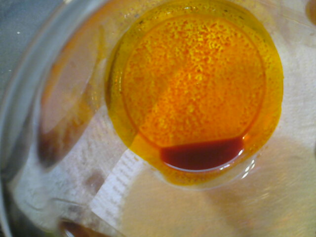

arkoma - 23-1-2021 at 21:50
Pictures from the other day.
https://en.wikipedia.org/wiki/Rosocyanine
Turmeric extract 91% IPA
2021-01-23-003324.jpg - 35kB
After gentle heating/stirring with Boric acid
2021-01-23-003312.jpg - 48kB
Hard to see the green of the Rosocyanine, but it's there
2021-01-23-005128.jpg - 41kB

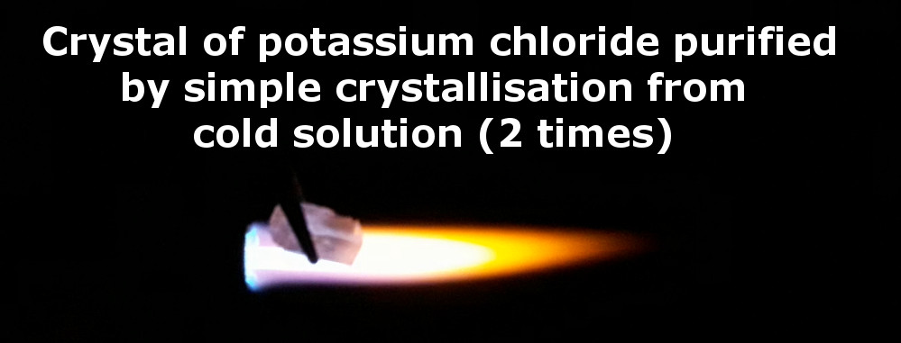

Piroz - 8-3-2021 at 15:20
Finally I got potassium chloride from wood ashes practically free from sodium compounds. I used crystallisation from saturated hot solution in plastic bottle (>50 deg. C), sodium was removed in crystalline mass, leaved potassium chloride in the solution. However crystallisation from cold solution (several times) wasn't enough to remove some sodium.
Flame analysis suprised me, potassium chloride from chem store reffered as 99% purity have more sodium than my potassium chloride from wood ashes.
Flame_colour1.jpg - 60kB Flame_colour2.jpg - 50kB Flame_colour3.jpg - 53kB Flame_colour4.jpg - 42kB

njl - 8-3-2021 at 16:05
Is there a conclusion one can draw from that?
arkoma - 8-3-2021 at 21:41
Yes, from the flame colors. Takes barely any Na ions to color a flame yellow. The hot xtallized KCl is a lovely violet.
*edit* Conclusion being that his own work-up had a much better flame color. obviously violet, unlike the commercial. Hence his contained less Na ion.

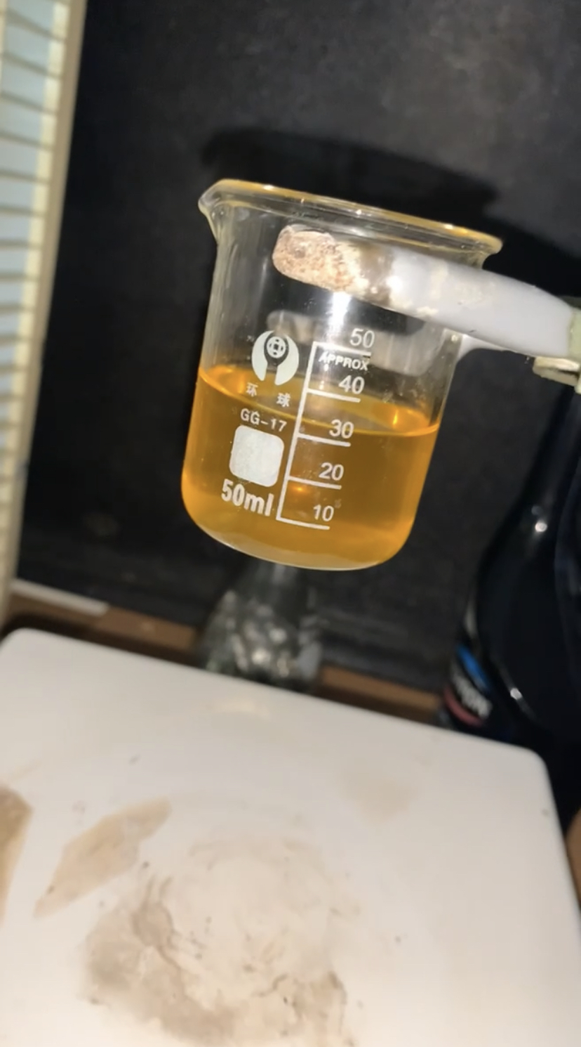

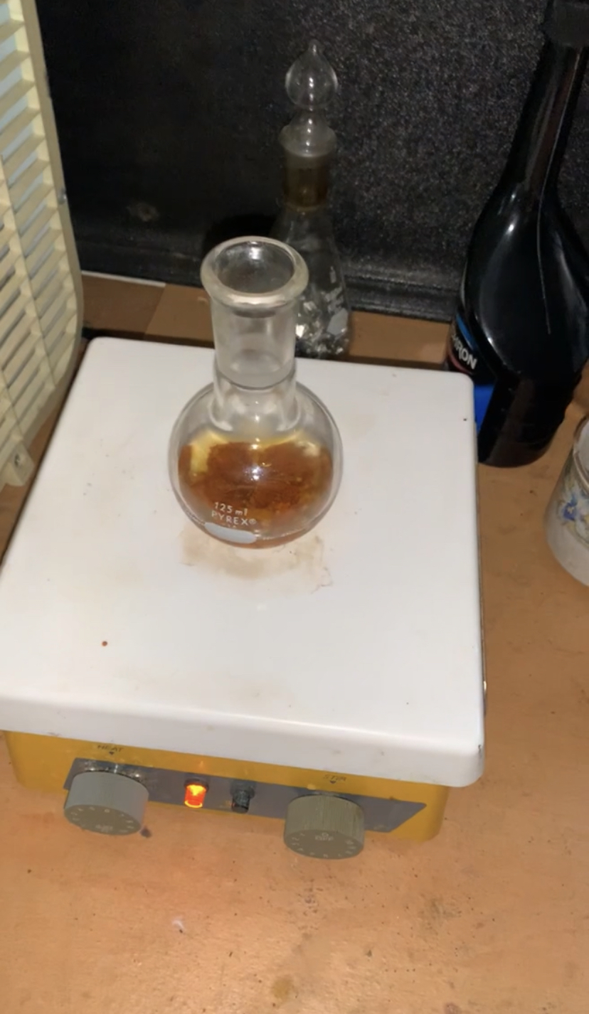

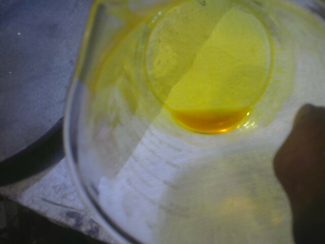

Elemental Phosphorus - 14-3-2021 at 20:04
I just did a little extraction of capsaicin from dried habaneros, hope to do it on a larger scale this week, but it was just a small scale run.
Wish I had a soxhlet extractor to use, but I just used boiling acetone in a flask and then poured it off and evaporated. Final product was a little bit of orange oil, and of course I had to taste a tiny bit, so I just put a knife tip in it and tasted it and it was definitely spicy (I know it’s not best practice, but I had to try).

I recently recrystalised commercial potassium nitrate multiple times to 'purify' it.
(a few mini-fireworks made with used 120mm filter papers)
Problem is, I don't know the initial or final purities.
Everything I observed makes me 'think' that the original kno3 was/is quite pure.
(no sediments, colors, change in crystal shapes etc)
Some research reqd.

Took my recently acquired heating mantle/variac for a spin, steam distilling citrus peels ... all went smoothly

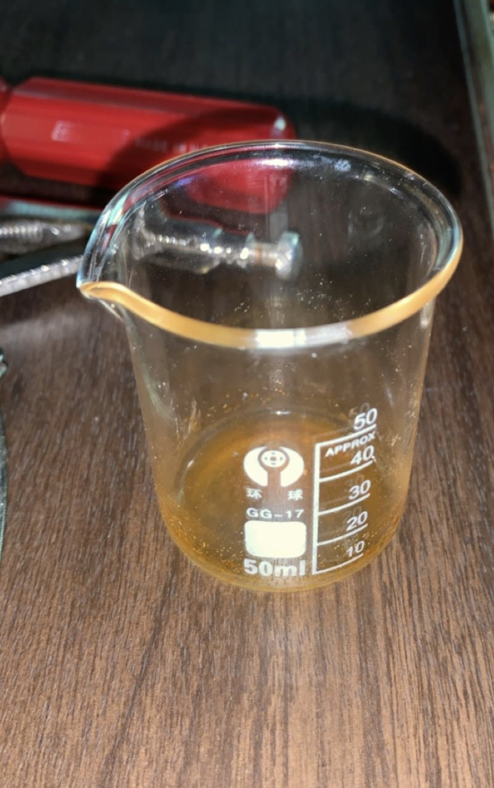

Tried to extract, purify, and dry anthocyanin. Sourced from red cabbage, beats, and then finally amazon. This molecule is very, very easy to destroy/decompose. I wanted to test it as a catalyst for the "alcohol catalyzed perduction of sodium metal" reaction.
Extraction was easy. Drying was not.
After 20 drying experiments, which decomposed the anthocyanin, I used store bought freeze dried.
Exposure to mineral oil from the same bottle of oil and anthocyanin from the same bag perduced verying results each time. Solved by bubbling h2 through the oil with 200c heat under vacuum (-15inhg) for 1 hour to clean/dry the oil
Test tube:
Exposure to sodium jump start at 105c produced a passiveation layer (brown oil) on the sodium and bottom on the flask. Sometimes, the sodium could be brought to the top of this layer and reacted more, but soon was covered again.
25ml round bottom flask:
Heavy stirring was added, and the results were a thick brown layer. Additions of magnesium metal produced a hard, solid black tar after a few minutes.
I added NaOH even with the listed problems. The tar that resulted was difficult to remove and contain unreacted sodium metal. 10% H2SO4(aq) was able to remove it with violent effectiveness
I think instead of working to find an easier to obtain catalyst, I will search for a more available reducing agent. Magnesium is not as cheap or as available as other metals. Aluminum should not work, so I'll start their. My thoughts on this are: Magnesium shouldn't work because it's lower on the reactivity series. NaOH + Mg = Na + MgOH works.
I know aluminum and sodium will produce an almogum, but maybe an excess of sodium hydroxide will be able to separate the mixture and force the reaction to completion. Baby steps.

I tried the condensation reaction of anisaldehyde with malonic acid, hoping for p-methoxycinnamic acid. I tried two slightly different methods and got two very different products- one is fluffy white crystals, the other is a sulphur-yellow powder.
I strongly suspect the yellow one would be anisylidenemalonic acid.(CH3OC6H4CH=C(CO2H)2)
