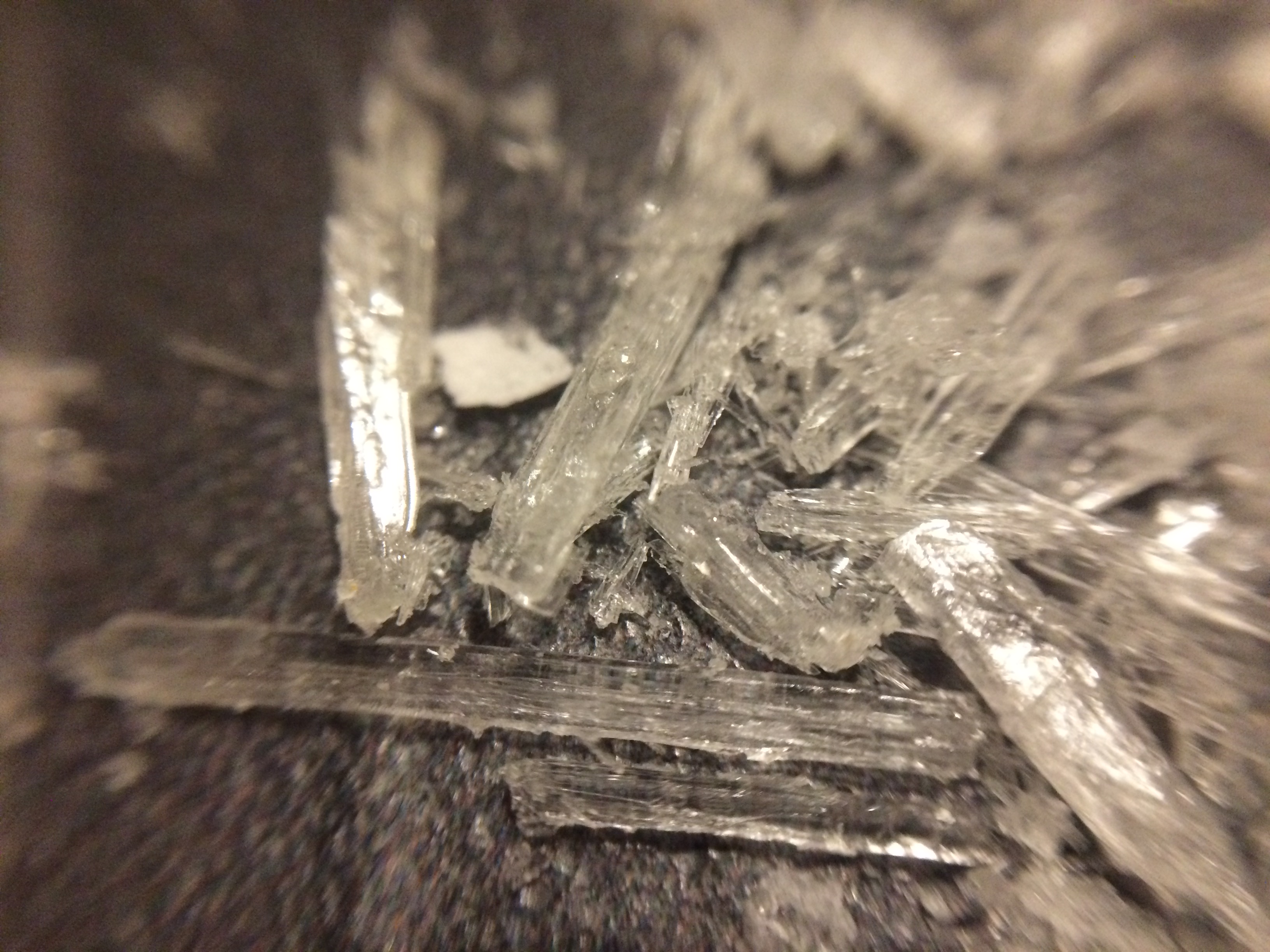

Keras - 22-3-2022 at 11:47
Update: I did that. I just dropped a screw made of zinc plated steel into a solution of a few hundredths of milligrams of KNO₃.
Heated it up a bit, let it evaporate at r.t.
Got some beautiful transparent, needle like crystals. Does that correspond to potassium nitrate?
IMG_1011.JPG - 1.2MB
Fantasma4500 - 22-3-2022 at 15:01
@keras please read the other posts in this thread
interesting with dithionite and iron, this in solution could maybe work for nitrite- it could maybe work to produce zinc powder? i have a bit of it that stuff- honestly i feel done with experimenting with producing nitrites, i have found working methods by now

Lionel Spanner - 27-1-2023 at 21:52
Having made 7 attempts at it, 5 in tin cans and 2 in a stainless steel saucepan, I can only conclude the Grossmann method for making inorganic nitrites (US Patent 792,515, 1905) which is cited in the wiki, is not useful or reliable. The results vary wildly depending on the surface material of the reaction vessel, and when successful (in tin cans previously used for food) the nitrite was of very low purity, i.e. 40% or less. The two runs in stainless steel produced no nitrite at all; the only product recovered was unreacted sodium nitrate.

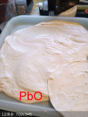

Myc - 28-1-2023 at 01:37
I have been pursuing the old molten lead method over the last couple of weeks. 85 g Sodium nitrate and 207 g lead (I used lead fishing sinkers) were melted in a cast iron pot and stirred continuously. An orange oxide begins forming, and the mixture bubbles. After about 30 minutes, the mixture is a thick orange mud and the lead seems to have mostly reacted. Stirring is continued after the heat is stopped to prevent a solid mass forming. Once the mixture solidifies, about 200ml water is added and the mixture left to soak for 15 minutes or so. All chunks should disintegrate.
The mixture is filtered and CO2 is bubbled through the filtrate for a few minutes; a white precipitate forms, which is removed by filtration. The filtrate is then reduced by boiling. When the temperature reaches 125-130 degrees C, heat is removed and the mixture cooled to fridge temperature. The crystals are then filtered and the filtrate reduced again for a second crop. Adding HCl to the salt gives plumes of brown gas. Pretty straightforward, right?
Now it was clear to me from early on that not all the lead had reacted. There were small grains of metallic lead amongst the lead oxide. So I tested the purity of my product as follows. 1 g of my salt was dissolved in a couple of ml of water. 2.5 g silver nitrate was similarly dissolved separately in 5 ml or so. The two solutions were mixed; a white precipitate of silver nitrite formed instantaneously. This was filtered, dried and weighed. If the 1g was pure sodium nitrite, the yield of silver nitrite should be 2.23g.
After one lead/nitrate reduction, my salt mixture was 30% nitrite. I then repeated the procedure with this salt mixture and fresh lead and got it to 50%. A third cycle got me to 80%. For reference I also tested some sodium nitrite isolated from curing salt, which I measured at 95% (although, in this case, I think any sodium chloride contaminant would have formed the insoluble silver chloride which could throw my numbers off).

A major breakthrough!
Lionel Spanner - 11-3-2023 at 09:29
One of the biggest problems in producing nitrite by reduction of nitrate is its tendency to react with oxygen at the reaction temperature. The solution? Remove oxygen.
I recently got an argon cylinder over the counter from a local welding supply store (Machine Mart) and decided to retry the sodium sulphide reduction method described in Morgan, in the same manner as the molten lead method (reductant added to molten nitrate in portions), while sparging the flask with argon and keeping oxygen out.
It only went and bloody well worked!
I'll need to reproduce and refine the method before providing a full write-up, but this is definitely a viable way to produce nitrites at a small scale. Get in!

Major success- breakthrough
Fantasma4500 - 27-8-2023 at 11:30
Very finely divided metallic copper is first prepared by distillation of acetate of copper, and from this freshly prepared metallic powder, 2 equivalents, or even a slight excess, are taken to 1 equivalent of saltpeter, according to the equation
you think thats an interesting quote? this is a marvellous breakthrough in nitrite preparation. i just tried it, mixed 3.2g KNO3 with 3.2g copper sponge i made from copper-copper electrolysis, NaCl + .. 1-3% HCl?
i believe CuCl2 + Al would also give copper fine enough for this
i folded up some aluminium foil and heated the mixture with a blowtorch until it melted and torched the top as well, maybe 5 seconds, it glowed from the flame
dipped that into 10mL water and shook it until the solid came off, black solid

RU_KLO - 2-6-2024 at 14:04
Last experiment was failure.
So i tried the Pb - Nitrate procedure. It seems it worked.
Tested the supernatant, few drops on potassium permanganate in H2SO4, it cleared, so there must be some nitrites.
Currently the Nitrite is drying. Im following Nurd rage permanganate standarization (with Sodium oxalate), so I can follow (previuos in this post) titration of the nitrite/nitrate, so to know how good it was.
attached some pictures.
The sodium nitrite I got is white, not yellow as stated in this post from others.
The PbO I got is creamy white , but pictures show it is yellow...
Are this colors I got correct?
Lead was from UPS batteries, maybe some contaminats are there.
NITRITE.jpg - 135kBPBO.jpg - 123kB
Rainwater - 3-6-2024 at 13:33
PbO is usually black, red, brown or yellow depending on the oxidation state.
That looks like white lead.... googling 2PbCO3·Pb(OH)2wiki
, heating a sample over a flame it should cause a color change, or react it with an acid to evolve CO2.
Heat it to about 650c and it should turn black if its PbO. Just remember its toxic and will contaminate all your gear
