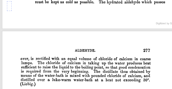

S.C. Wack - 17-4-2014 at 15:59
Sabatier and Senderens did not use copper scrubbers. Bouveault (attached) made an apparatus improvement going vertical, and used rolls of copper gauze coated with reduced copper, from the hydroxide and hydrogen at 300C.
Attachment: Bull_soc_chim4_3_119_1908.pdf (556kB)
This file has been downloaded 1396 times

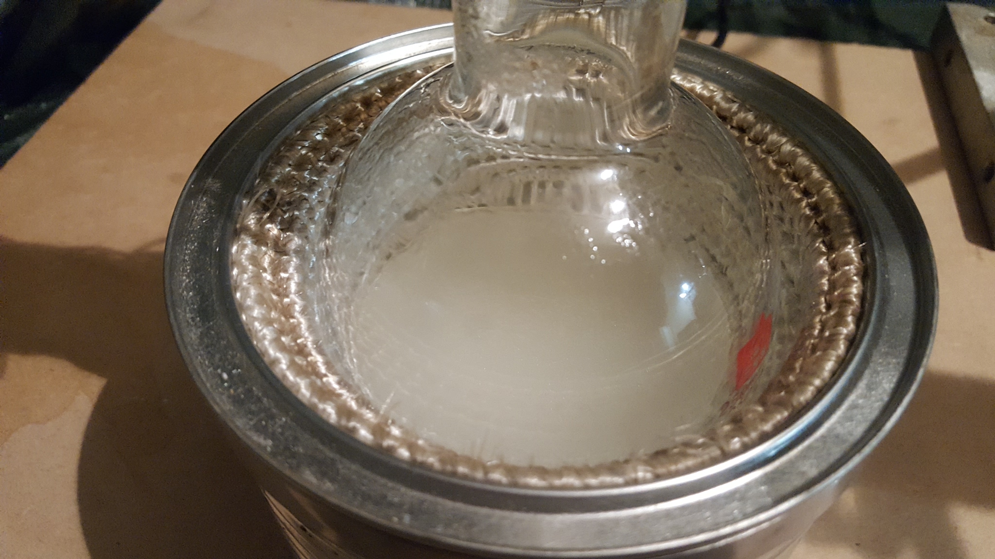

I am planning to use the apparatus I presented in acetanhydride topic. The setup is somewhat general and the operating principle is simple. The reactor could be placed vertically as well, but this way the catalyst will hold in there easier.
Unreacted methanol is always more preferable than decomposition, since methanol can be recirculated indefinitely through the bed with refluxing recirculation, but CO and H2 are total loss.
I don't believe 300C will sinter metallic copper in any reasonable time. Other tale is when using gas torch which can put 800-1200C surface temps.
ketene-mantlex2.png - 394kB

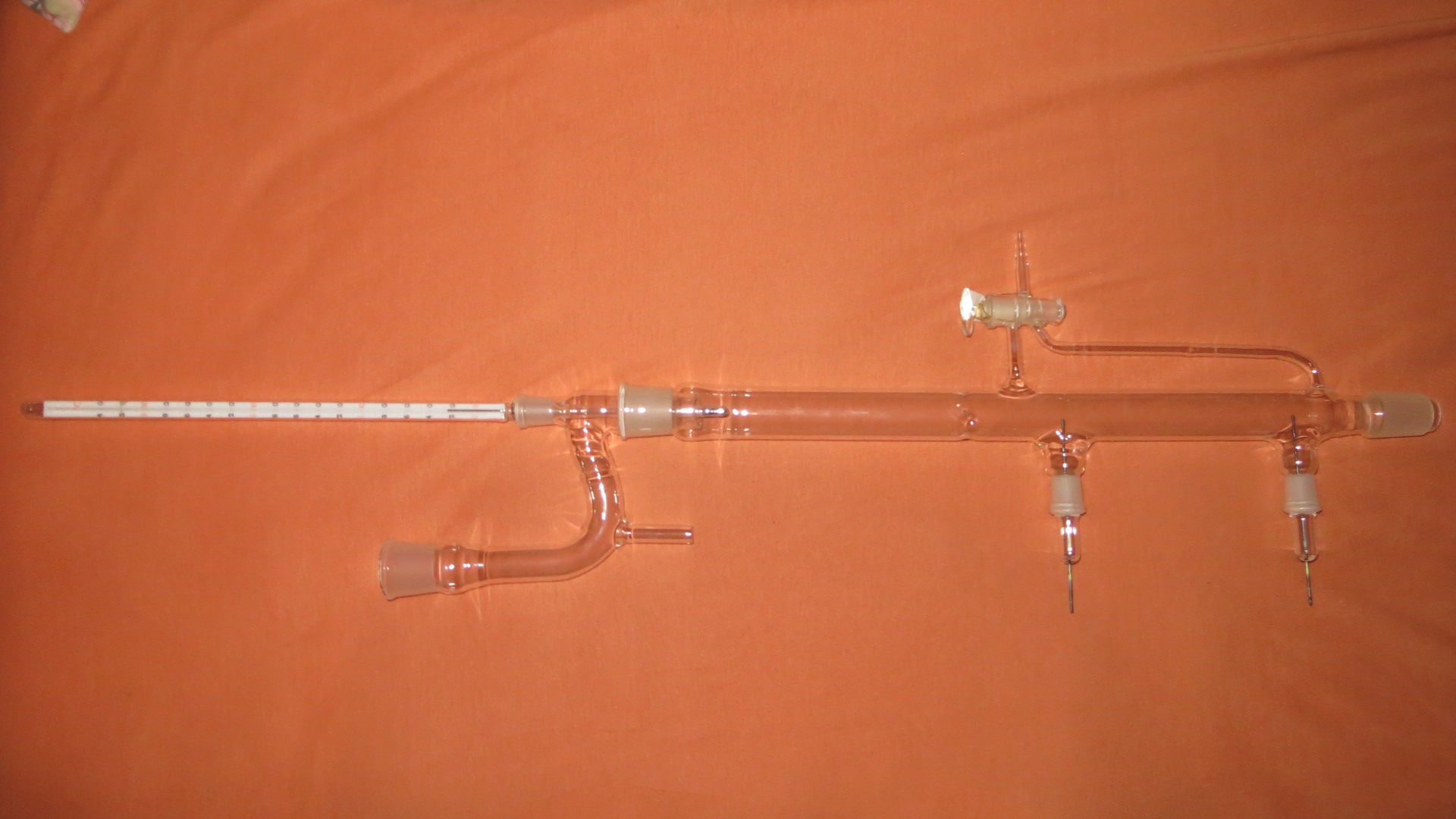

Hi folks, I custom made a new alcohol oxidation reactor, since I broke the old one (I almost cried).
I will also try to oxidize alkanes with it, C3-C6 to see what I can get, and how far the oxidation goes, hopefully not till H2O+CO2. Note that the kanthal filament will be inside the glass tube, instead of heating the glass wall, similar to a ketene lamp.
IMG_3584.JPG - 362kB

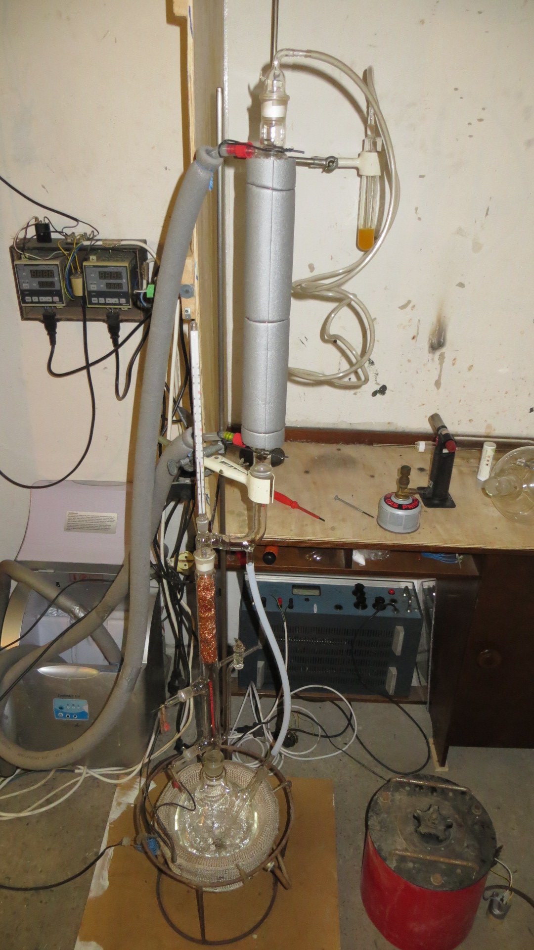

Jimmymajesty - 15-3-2015 at 11:21
Here is the reactor in operation, the kanthal wire was brought to dull red, the gas evolution was continuous. I led the gas into ccNaOH sol, after ~10mins and orage precipitate appeared with an intense apple smell. The gas was led into 1ml of ccH2SO4 after ~15mins it charred. I did not try to isolate the acetaldehyde since it would require some -30°C temps.
IMG_3598.JPG - 537kB IMG_3604.JPG - 381kB IMG_3599.JPG - 405kB
Magpie - 15-3-2015 at 14:35
That's an interesting looking apparatus, Jimmy. What is the side tap with the stopcock for?

Jimmymajesty - 16-3-2015 at 13:38
Hi Magpie, the tap is for letting air in below or above the filament, lack of good mixing of the vapors may cause a mini explosion, that is why I still collecting some nerve to try it.

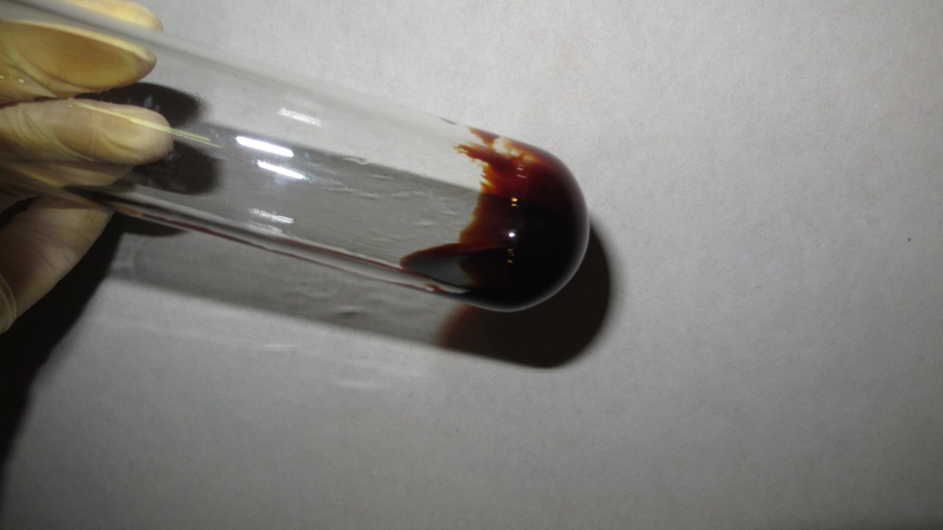

Today my curiosity conquered my fear and let air into the reactor through the upper tap, the flow was around 1ml/sec but nothing really happened. The temp on the thermometer was remained 110°C, the gas evolution was about the same, maybe it was not enough to make any change, I will give it another go in the coming days.
This time I went with platinum (+rhodium) catalyst scavenged from a catalytic converter of a diesel car.
The thermometer with this type of catalyst was not read as much as with copper, but what does it tell you? Is the platinum cata better because the reaction without air is slightly endothermic?

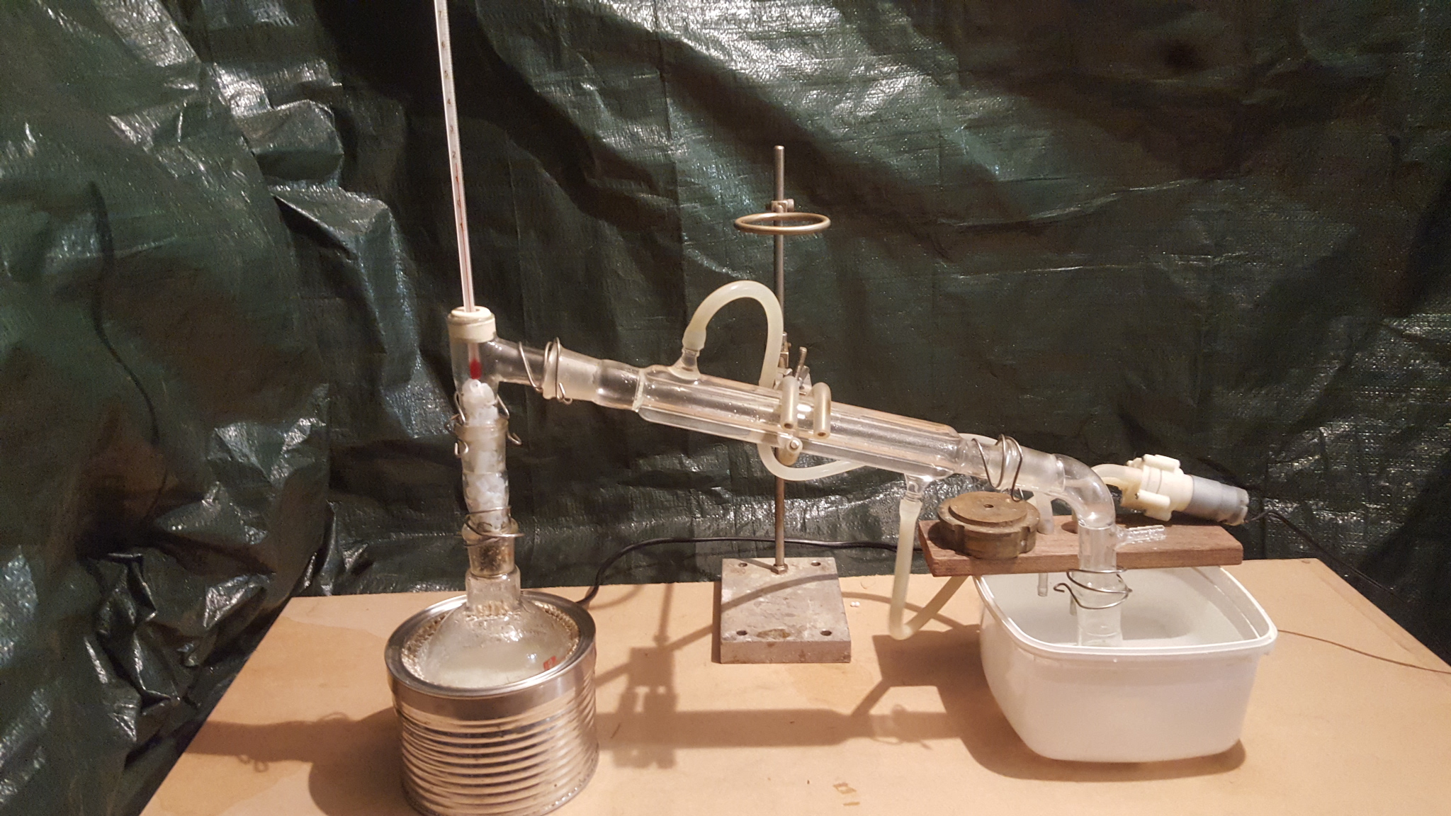

xfusion44 - 24-5-2015 at 07:05
Hi, today I've got an idea on how to make acetaldehyde, using copper catalyst. I'll add my drawing below... I think I'll try it, but I need to buy aquarium air pump and hose barb to ground glass joint adapter (I don't know where I'd be able to get one though - size 29/32). I'd be happy for you to let me know what do you think about this setup - do you think it would work?
Thanks :)
[Edited on 24-5-2015 by xfusion44]
IMG_20150524_165659.jpg - 1.5MB

Hawkguy - 24-5-2015 at 07:36
Thanks :)
That looks like a pretty good method as for affordability. Keep in mind however that you will also end up with a lot of Acetone in your product, so it will likely have to be purified extensively. You shouldn't need a ground glass adapter for the tube to condenser, use a cork fitted with thevtube. And push that into the socket. Nice

WGTR - 24-5-2015 at 16:39
If you want to try something quick and dirty, I would suggest this configuration over doing it in a jar.
IMG_1107.JPG - 900kB
The wad of copper wire on the left is intended to function as a flame arrester. It should stay cool during normal operation in order to provide this function. The copper wire on the right is a wad of very fine wire (to provide as much surface area as possible). These wads of wire are pushed down into the glass tube, which is then bent appropriately with a propane torch. The left side goes into a rubber stopper in an Erlenmeyer flask that contains ethanol. The ethanol is heated slightly in a warm water bath to increase its volatility. In the same stopper, a glass tube is pushed under the ethanol surface, and air is slowly bubbled through. This forms a fuel/air mixture. During operation, the copper on the right can be heated gradually with a propane torch. If the fuel/air mix is correct, the copper will glow even when the torch is removed. This is kind of fun to look at in the dark.
Just because it is safer than doing it in a large jar doesn't mean it is completely safe. Certainly use a face shield. Leather welding gloves are a good idea if it is necessary to adjust things during operation. Even better, a Plexiglas blast shield can be added for extra safety.

BR, xfusion
No, it does not work very well. Yes, the right side of the tube goes to a condensor. The efficiency (or my patience) was poor enough that I couldn't get quantitative amounts of acetaldehyde from it. At the same time, it will be more effective than a copper spiral in a jar, and much safer. It will also give an idea of how air flow and fuel mixtures affect its general operation. And yes, one can smell some pretty pungent products coming out the other end.
Now, to explain the previous a little better: Temperature control was very difficult with this setup. Yes, the initial heating was accomplished with a torch. However, the thin wire of the catalyst offered poor heat transfer, so localized overheating would occur during operation. The bulk of the wire catalyst was not used evenly. Most of the reaction would occur at one localized area in the bulk wire, usually at the leading edge. The self-sustainability of the reaction was determined by the air-fuel ratio. This in turn was determined by the alcohol temperature and the effectiveness of the air bubbler. As byko3y mentions, it is easy to overoxidize the product.
The air volume was very low. I would estimate about 1 cm^3 per second, but that is probably too fast for this particular setup. When one considers the low air flow involved and that alcohol vapor is a only small fraction of this, it's not surprising that one will wait a very long time for that first mL of acetaldehyde. In "Catalysis in Organic Chemistry" (Sabatier) pg. 654, a column full of copper catalyst 25-30mm in diameter, 1 m in length was used to prepare 500g of acetalydehyde per day. That gives an idea of how slow this process can be.
I gave up on the idea of oxidative dehydrogenation, and instead focused on direct dehydrogenation. The latter process requires the continual addition of heat to continue, so it is less likely to overheat. It also avoids the use of oxygen, so the products are free of acetic acid, water, etc. I detailed the construction of this idea here:
https://www.sciencemadness.org/whisper/viewthread.php?tid=55...
Also, JimmyMajesty's setup is quite impressive, and works on similar princicples. He has done well with the output condensor design, which is something I have yet to do properly. The acetaldehyde product will contain a large amount of unconverted ethanol. For this reason it is always necessary to seperate out the ethanol from the products, and send it back to the boiler. The condensor will need to be able to separate out this alcohol from the acetaldehyde, and also to efficiently condense out the aldehyde. This is easier said that done, as one can see when reading back through JM's posts in this thread.
I would strongly advise reading through Sabatier's book on catalysis. It was such an instructive and interesting book, that I almost read it cover-to-cover in one sitting. It is available for free all over the internet. It will help you more than I possibly could in a thread.
That is a nice drawing, by the way.
+1 for question about effectiveness. Catalyst has a limited activity, so there's also a question about whether ethanol should be boiling, or maybe some inter carrier or air is passed through it without ethanol boiling. I think something like 70°C and air will do the job. Because boiling ethanol is hard to control, and higher amount of oxygen will lead to oxidation into CO2.
The temperature I was using was about 40-60C. It has to be adjusted to change the air-fuel ratio. I would generally get the alcohol concentration as high as I could, while it would still allow a self-sustaining reaction in the catalyst.

nux vomica - 12-9-2016 at 19:15
Link to youtube video https://youtu.be/7XNoWUeWxIk
Magpie - 12-9-2016 at 19:47
Nice going nux! Please give us the details on this preparation including purification and the yield.
I love seeing use of the peristaltic pump, and have noted your fine homemade mantle. ;)
Also, did you make those joint clips? I want some of those for high-temperature reactions. What kind of wire did you use? Anything special or just coat hanger wire?
[Edited on 13-9-2016 by Magpie]
nux vomica - 12-9-2016 at 20:19
Thanks magpie i am going to do some more work on the purification tonight so i can post some more info .
I find i use the peristaltic pump more than a dropping funnel as long as the silicon tube can take the liquid flowing through it.
I got the clips off ebay after the plastic ones kept melting or cracking.
[Edited on 13-9-2016 by nux vomica]

nux vomica - 14-9-2016 at 19:10
Ive uploaded another video showing the purification of the acetaldehyde and the yield.
https://youtu.be/-x_lMokdjxk
20160913_182448.jpg - 793kB
20160913_191508.jpg - 643kB
Magpie - 14-9-2016 at 22:08
Very nice. I like the simplicity. Does the CaCl2 absorb water? Are azeotropes a concern? Did you have a lot of bumping?
I have tried that method for making butyraldehyde and propionaldehyde without much success(per Brewster). But CaCl2 was not used.
I will definitely be trying this.
nux vomica - 14-9-2016 at 22:39
thanks magpie I got the information out of a book on google books
Capture 2.PNG - 42kB Capture.PNG - 45kB
The calcium absorbs the water and seem to smooth the boiling out.
As I understand it there isn't a azeotrope with water or ethanol so separation is reasonably straight forward.
Cheers nux.

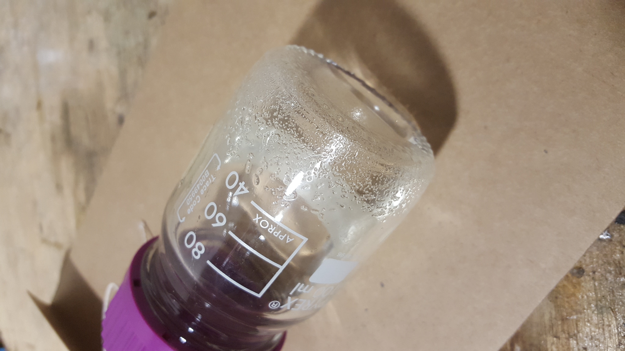

nux vomica - 26-9-2016 at 23:53
I found a intresting occurrence happening in the storage bottle that my Acetaldehyde is kept in, there seems to be crystals of some sort forming on the walls of the bottle , i can only presume that metedehyde is forming and i wonder if a tiny amount of Sulfuric Acid has somehow contaminated the bottle and has catalysed some of the Acetaldehyde.
20160927_173827.jpg - 489kB

Slug pellets and dilute sulphuric acid might turn out to be a better synthesis of furfural than ethanal.
Why? Because of the 88-97% remaining unknown material? Is it a pentose/hexose (cellulose or polyose) related material?
tsathoggua1 - 20-2-2017 at 07:13
Cheap? more or less free since I already have the sulfuric, and the the pellets were bought by my old man for killing slugs. I took them, just in case he got tempted to use them, because of the effect on wildlife in part (I am very much an animal lover, and indeed I'd even side with the slugs rather than kill them, I'd just catch them and move them to the garden of somebody I didn't like. And if I see snails in the street when I'm out I'll stop to pick them up and place them at the side of the street or on a garden fence assuming its not sunny and hot. If it is, I put them in the shade under someone's garden plants; to avoid those in the middle of the street being trodden on accidentally, or deliberately for that matter and crushed)
And partly because a lot of me was looking at the jar of pellets and thinking...hmm bet that tetramer of acetaldehyde can be depolymerized and some acetaldehyde had from it!
I don't know what the slug pellet base is,, the bulk filler I mean. I'll give it a crack now once I've finished my smoke and had my morning dose of morphine, chlormethiazole, clonidine, tizanidine and additional oxy.
Edit-slight delay, need to find a spare mains plug for my water pump for the condenser. Also, checking, also found another half to 3/4 full pack of metaldehyde slug pellets, although they are metaldehyde based it doesn't say what percentage is in them or what the base material is either. Plus as a bonus another full pack, but not metaldehyde, ferric phosphate. Which presumably in the anhydrous state is a lewis acid and could be dehydrated using P2O5 as a slurry in some suitable solvent of choice?
[Edited on 20-2-2017 by tsathoggua1]
