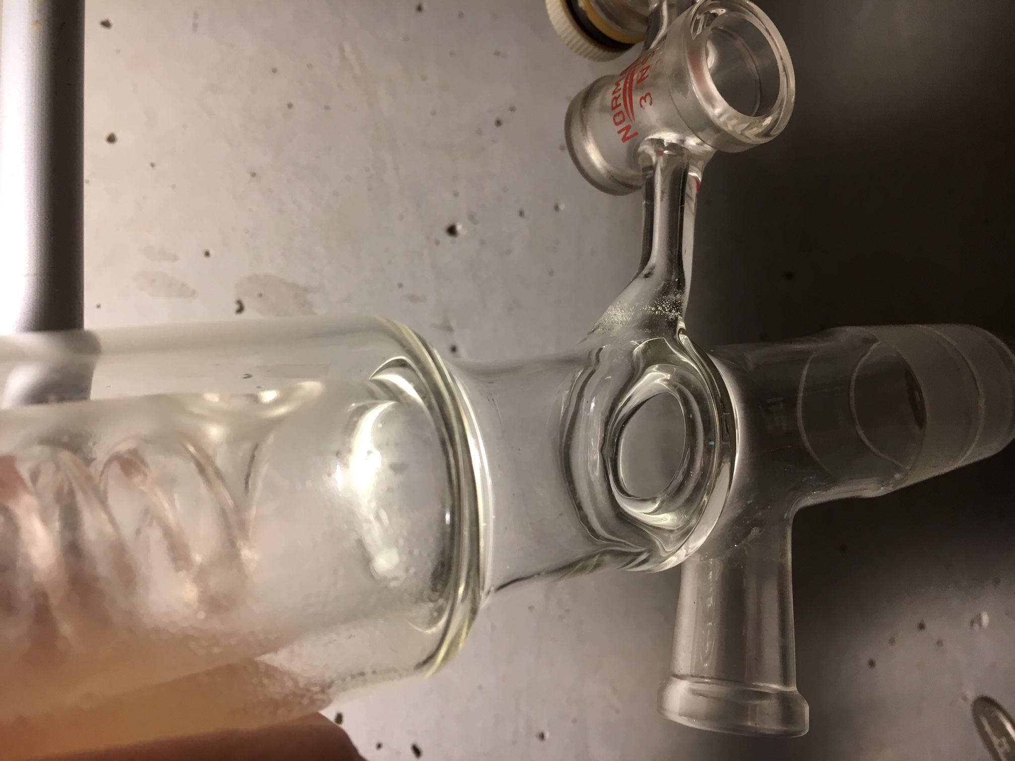

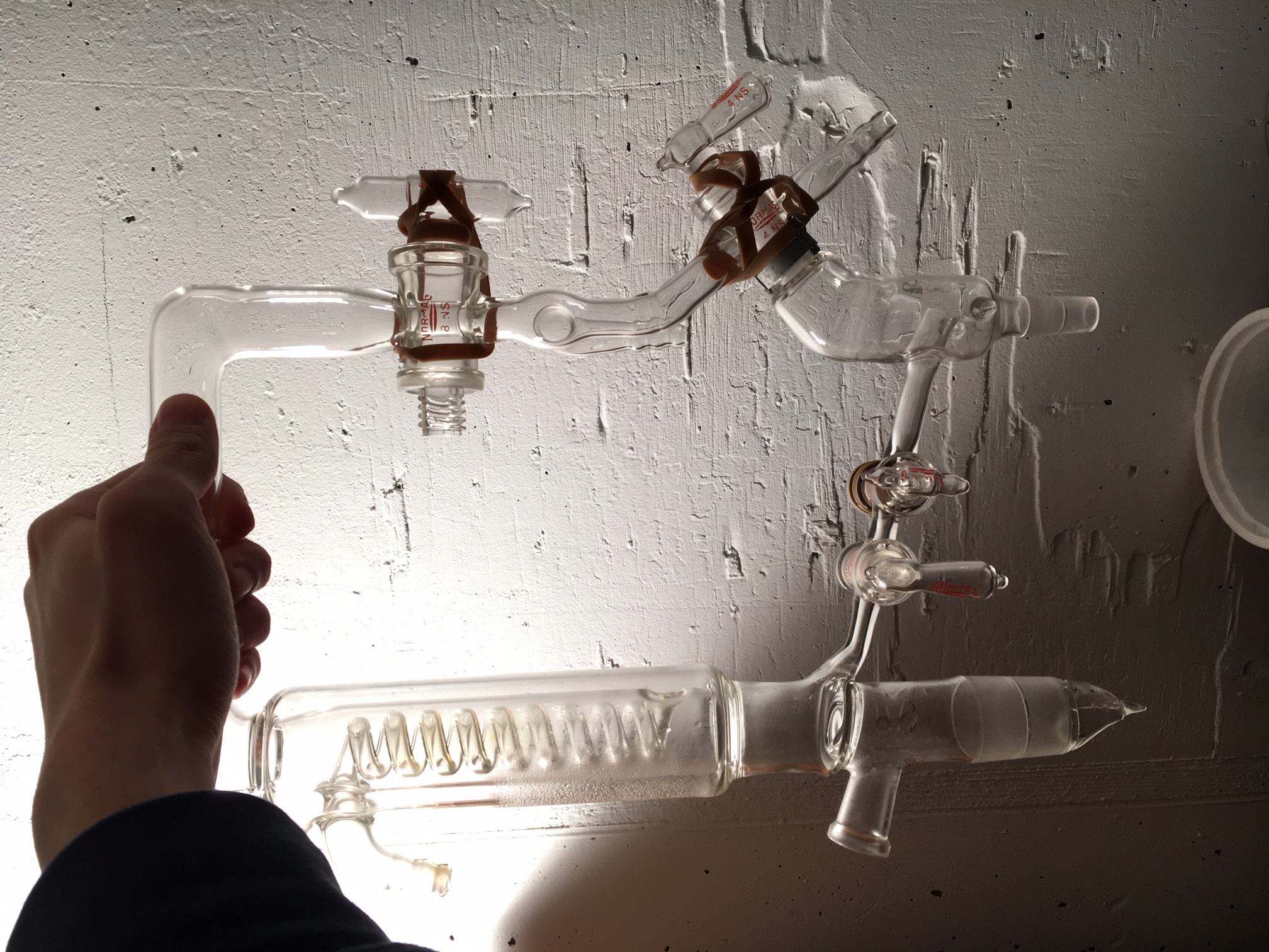

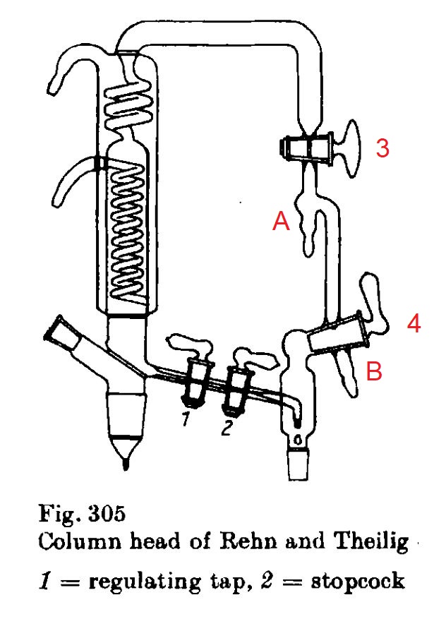

Heptylene - 6-12-2019 at 14:12
Christmas came early this year, I found a very nice partial-takeoff distillation head for $100 on ebay! Shipping + customs taxes puts the total just over $150. Probably the best deal I've ever made considering these retail for around $700 new from a glassware supplier. It's in perfect condition, except for a broken stopcock thread and some rotten stopcock nuts, o-ring and washers.
distillation head.JPG - 1.1MB
This particular design is the one of Rehn and Theilig. (Figure from E. Krell's Handbook of laboratory distillation, 2nd ed., p. 392)
Vapors condense on the "intensive" condenser and fall down on the oblique weir just above sideway joint. This diverts the condensate to the horizontal arm with two stopcocks. Stopcock 1 precisely controls the reflux ratio: the distillate that doesn't go through this stopcock falls back over the weir into the column. Stopcock 2 is there to start or interrupt product withdrawal without modifying the reflux ratio.
The receiving flask is connected to the joint on bottom right, possibly through a condenser to cool the product further. Stopcocks 3 and 4 allow changes of receiver during vacuum distillation without disturbing the column. Hose barb A is connected to a vacuum source, and hose barb B to the atmosphere or some other gas.
Rehn-Theilig design.JPG - 111kB
Sulaiman - 7-12-2019 at 03:18
Looks like a useful piece of glassware, nice condenser.
To satisfy my curiosity, could you show a close-up of the weir/bottom of the column,
I can't see how the refluxed liquid gets back to the column.
Heptylene - 7-12-2019 at 06:29
I'm don't have access to my lab right now, but I'll post close-up shots later. The oblique plate is actually perforated in the middle. It's kind of difficult to see here. The liquid fills up the left side of the small tube with two stopcocks and overflows through the large hole in the plate, and drips down into the column. The reflux-adjusting stopcock has an interesting design for very small flowrates, I'll show it as well.

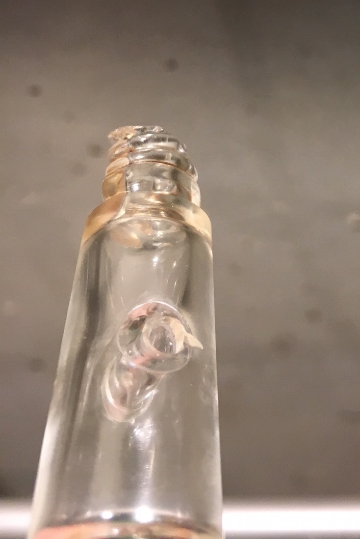

Heptylene - 9-12-2019 at 12:31
As promised, a picture of the weir inside the colmn. As you can see, the condensate flowing on the walls of the condenser is diverted into the side tube. This also explains the choice of condenser design: A regular Dimroth condenser where condensation drips down from the coil in the center (and not the walls) would not work for this as it would miss the weir.
Also a closeup of the reflux ratio stopcock. Small notches on both sides of the stopcock bore (not chipped, it really is designed like that) allow very small flowrates to be let through when the stopcock would normally be in a "totally closed" position. Unfortunately the thread on this one is broken, so I might replace it with a PTFE one which I will modify to also have those notches. A really nice detail, and I think this would work well on an addition funnel for very slow addition rates.
reflux stopcock detail.JPG - 165kB weir detail.JPG - 616kB
[Edited on 9-12-2019 by Heptylene]

Sulaiman - 9-12-2019 at 16:59
Thanks, I see it now,
and
the tapered notch in the stopcock can also be found on some (older) burette stopcocks.

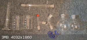

B(a)P - 16-1-2020 at 00:18
My latest purchase, nothing exciting, but all decent quality. I have sworn off cheap glass.
IMG_20200116_190939.jpg - 4.6MB
G-Coupled - 16-1-2020 at 12:32
What troubles were you having with cheaper glassware?
B(a)P - 16-1-2020 at 15:21
The last straw was losing 1 L of dissolved ammonia nitrate and calcium sulfate precipitate all over my bench and floor. I was half way through an ammonia nitrate synthesis and got slightly over zealous stirring with a glass rod, tapped the side wall of the breaker and it broke a piece out of the base of the wall of the breaker.
I have also had issues with cheap glassware cracking when on the hotplate.
I have never had an issue with Simax.
[Edited on 16-1-2020 by B(a)P]
G-Coupled - 16-1-2020 at 19:50
Was it Chinese no name stuff, or a brand like Ninshin or whatever?
B(a)P - 16-1-2020 at 22:37
Chinese no brand, roll the dice and take your chances purchase. It was sold as borosilicate glass.

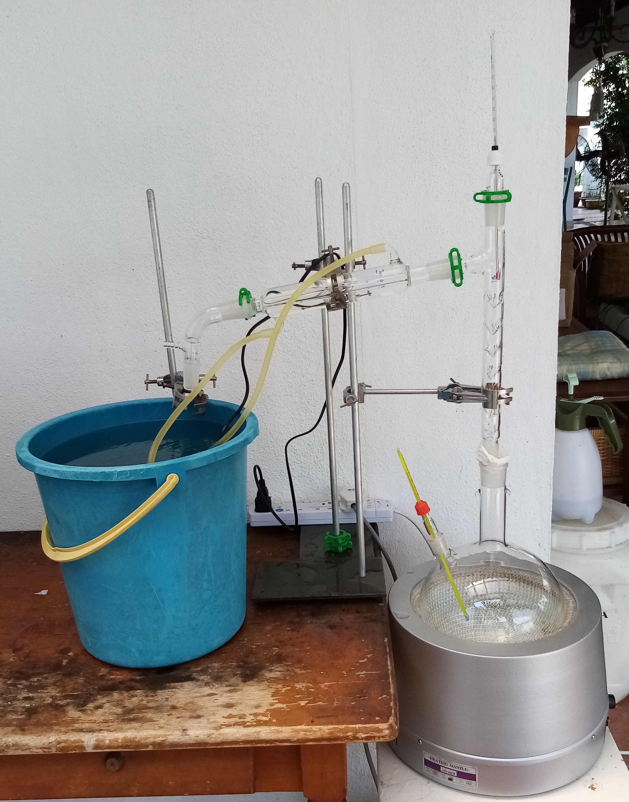

I was recently given a 2-neck (34/35 & 19/26) 5L rbf with 700W heating mantle and three retort clamps with stands ... lovely
Unfortunately other parts of this kit have not materialised,
and all of my chemistry stuff is in UK, so I can't do much,
... I've ordered a few things;
. a 19/26 thermometer adapter https://shopee.com.my/19-26-Thermometer-Adapter-Inlet-Adapte...
. a -10 to +110 x0.5 oC mercury thermometer https://shopee.com.my/READY-STOCK-Thermometer-Mercury-Lab-Us...
. 24/35 to 24/29 adapter https://www.ebay.co.uk/itm/Glass-Reducing-Adapter-From-34-35...
. a cheap Chinese '1000ml Distillation Kit' https://shopee.com.my/Teamwinm-Distillation-Apparatus-Lab-Va...
At least I will have a Vigreux column to compare HETP with my usual Hempel columns.
I already have more than one distillation kit at home, this is just temporary setup.
Now to start a sugar wash fermentation so that I can distill some EtOH for hand sanitizers.
Hopefully I can get product before the covid pandemic dies out.

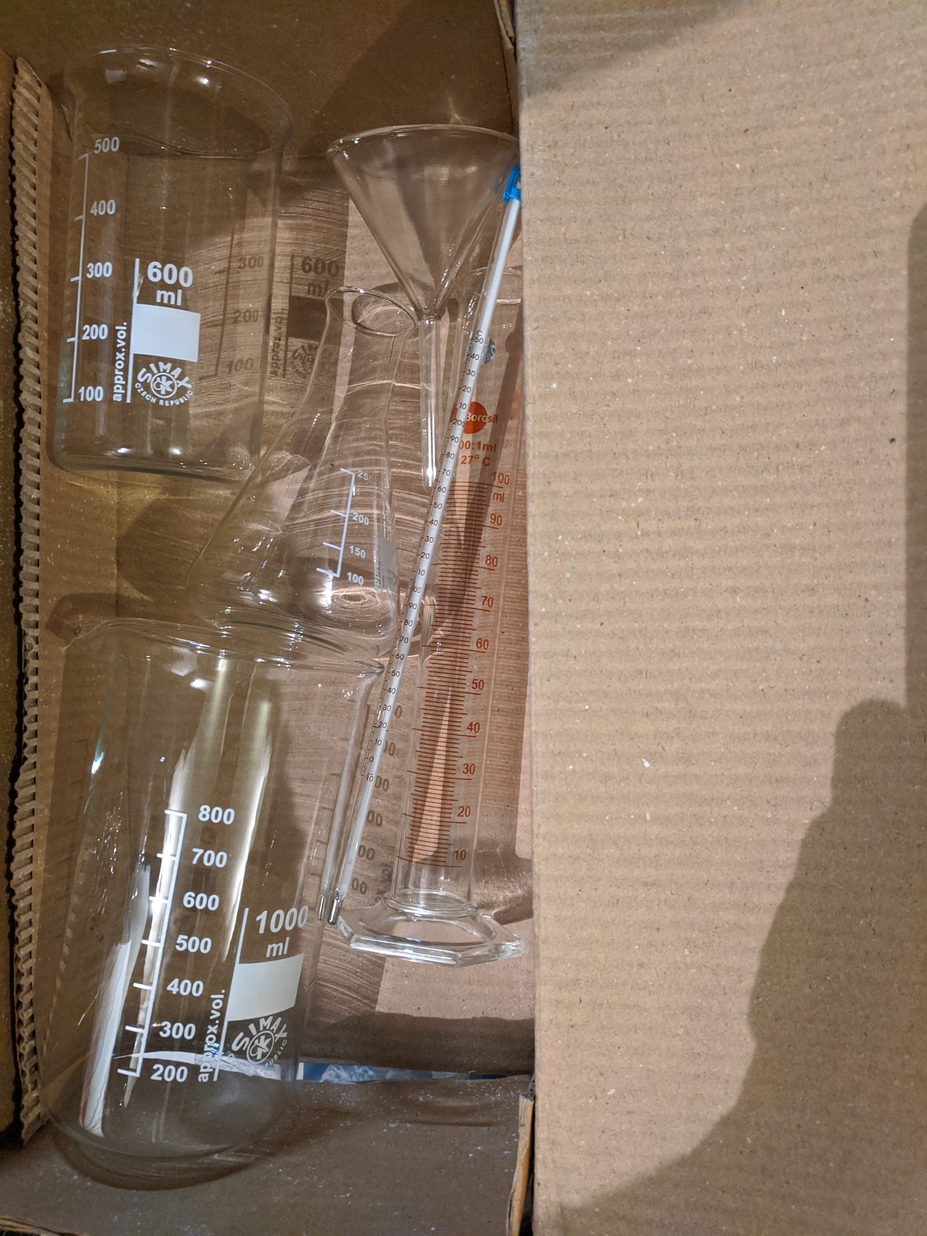

Draeger - 3-4-2020 at 17:28
Just bought all of that.
Let me translate everything in order from top to bottom.
Beaker, low form, boro 3.3, 100ml, no graduation, pack of 10
Standing flask, boro 3.3, ground glass joint 29/32, 250ml
Joint clamp, ground glass joint 29/32
Liebig condenser, boro 3.3, glass olives, 29/32, 400mm
Distilling head with vertical junction, 2 29/32 ground glass joints, 1 14/23 ground glass joint
Universeal thermometer, white-coated, filling Hg, 76mm immersion depth, length 300mm, -10 to +360:2° C
Moldex 8090 particle filter adapter, 2x per pack
PTFE-joint sleeves for ground glass joint 29/32
PTFE tape

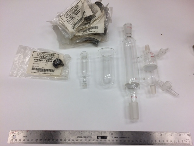

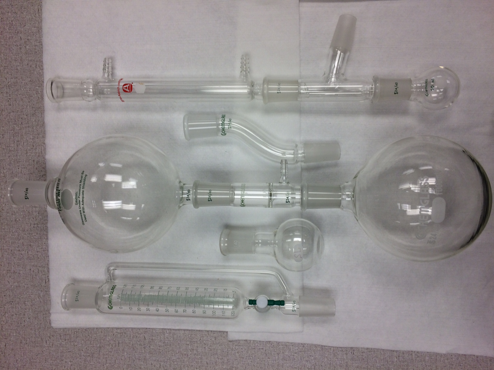

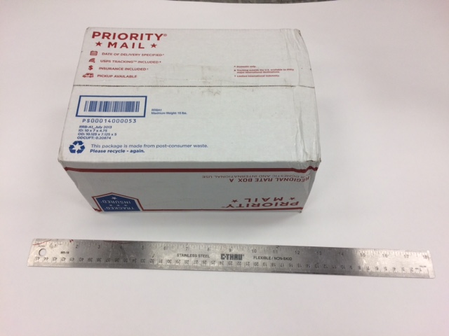

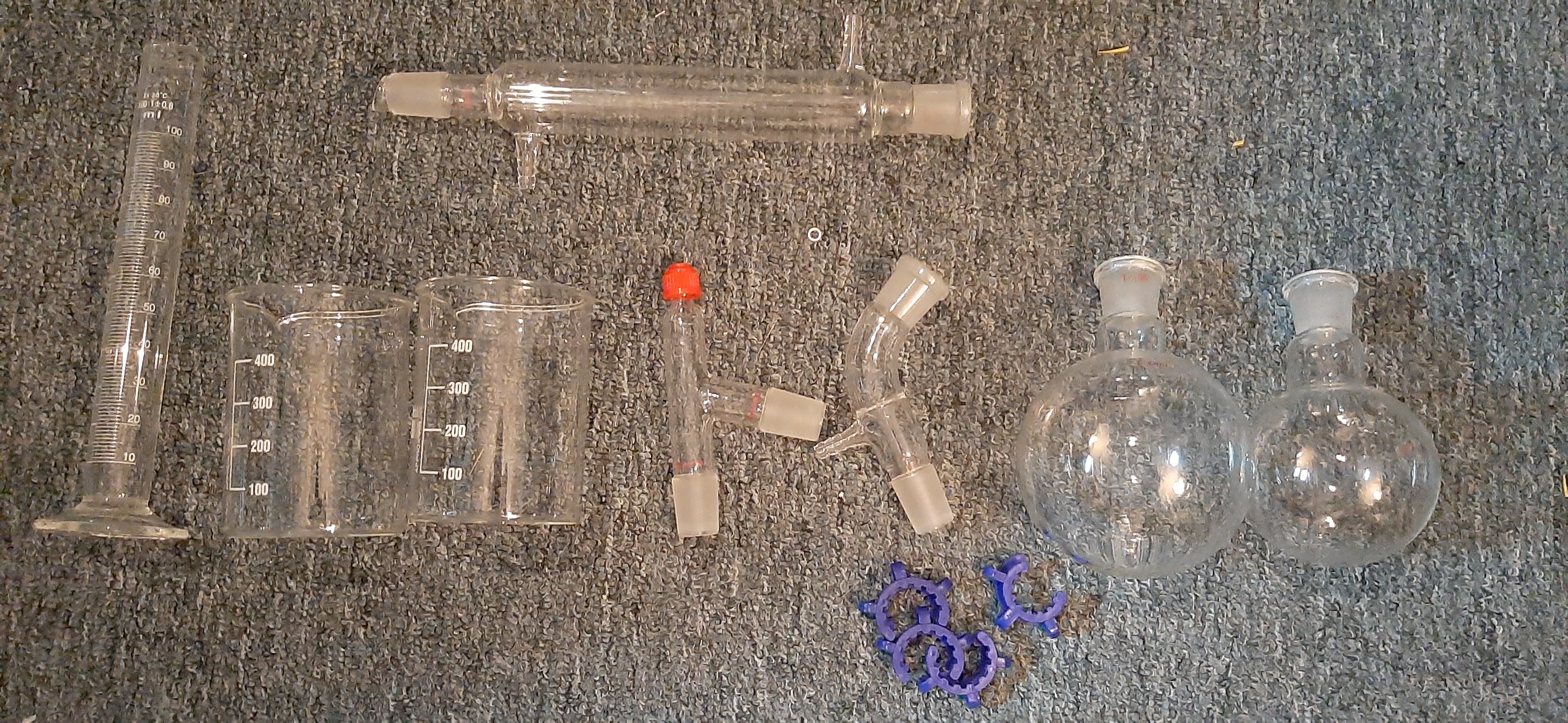

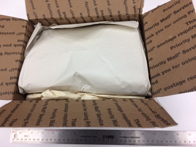

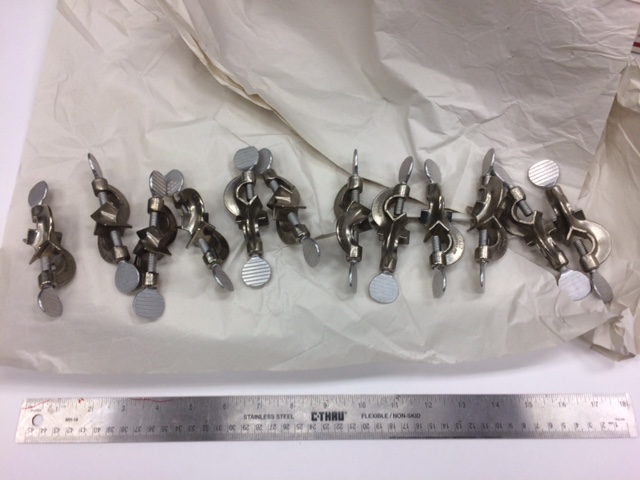

WGTR - 9-4-2020 at 11:29
I celebrated the relaxation of Texas' glassware laws by making my first real glassware purchase ever.
After spending a lot of time over-thinking what brands to focus on and who to buy from, I decided to go with domestic sellers and stick with reputable brands. I narrowed my search down to this seller on eBay: labstuff16 as he seemed to have most of what I was looking for at this time.
So here are some pictures:
IMG_0625.JPG - 82kB IMG_0626.JPG - 108kB IMG_0627.JPG - 560kB IMG_0629.JPG - 512kB
Everything was very nicely packed and individually bubble-wrapped. The glassware itself is all Chemglass except for the 100ml RBF (Pyrex) and maybe the Liebig condenser (Sigma). They are all used, but all pieces are essentially flawless or show very minor use.
The only possible issue that I can see is that I cannot find a 105 degree bent adapter in the box, and I should have received one. I am going to check my packaging a few more times and check with the seller. It was not sent then I believe it was simply an innocent oversight.
I am still awaiting a cold finger trap and some Keck clips from other sellers.
[Edited on 20-04-09 by WGTR]
j_sum1 - 9-4-2020 at 13:43
Looks lovely, WGTR. The obvious thing missing is eithe a multineck flask or a Claisen adapter. So often you want a spare neck when using the addition funnel.
Have fun with it all.
Sulaiman - 9-4-2020 at 18:18
+1 on the Claisen adaptor, for addition funnel or thermometer
also;
A 24/40 stopper for the addition funnel
(or a more versatile 24/40 gas adapter with stopcock)
A thermometer adapter/well/pocket
A roll of plumbers ptfe tape (or some messy joint grease)
A plain column which can be used as a Hempel column, air condenser, or chromatography column
or
A Vigreux column as even one to two additional theoretical plates make a worthwhile difference
and it also acts as a splash adapter :P
nice-to-have are an NS24-sized bottle brush for the joints and maybe a burette brush for the condenser
______________________________________________________________
Out of curiosity ... is the flask with joints at the top and bottom for essential oils steam distillation ?

My latest glassware, showing long term testing of water circulation reliability
... all collected whilst here on holiday/lockdown ... waiting for a 34/35 to 24/29 adapter
5L Rig2.jpg - 2MB
I've been very lucky;
. the 5L rbf with heating mantle and three stands w/clamps were gifted to me
. the Vigreux column, still head adapter, thermometer adapter, thermometer, condenser and receiver adapter were free
as the 1000ml and 500ml flasks of an eBay '1000ml distillation kit' were broken in transit so I got a full refund
I've only had to buy a 14/23 thermometer adapter (in the rbf), a second thermometer, and a water pump,
plus the 34/35 to 24/29 adapter which I'm waiting for.
P.S. the upper thermometer shows the current ambient temperature - in the shade before noon :o
P.P.S. my stands and clamps in UK are cheap Chinese plated steel ... which rusts
if you are considering new stands and clamps I recommend aluminium (as shown above) because they are rust-proof (except for the screws).

I just received another purchase from a different seller on eBay, letterkenny7745.
IMG_0642.JPG - 65kB IMG_0643.JPG - 102kB IMG_0645.JPG - 91kB IMG_0646.JPG - 89kB
These are 1451 Fisher Castaloy 90° double lab clamps. I was a bit surprised when I opened the package. The clamps looked brand new, not used.
Unfortunately, I do not see any other lab equipment in his store at this time.
It was a pretty straightforward eBay purchase and a good experience I would say.

I purchased a collection of stuff from tommytubez, also on eBay. This was more than a business transaction; I found it to be a pleasant experience. He was very quick to reply to his messages, and a seemingly gracious individual.
I actually purchased only the large filter tube and the collection of Kontes 90° lattice connectors. He threw in a few other things as freebies. There's a 100mL reaction flask in there, in addition to some Schlenk filtration tube and a peptide vessel with some small frit at the bottom.
IMG_0650.JPG - 73kB IMG_0653.JPG - 135kB IMG_0654.JPG - 71kB
It looks like he still has some of the small lattice connectors available. I tried one out and it clamped securely onto 1/2" aluminum rod. They look brand new. In fact, the glassware looked brand new also, even though it is "used".
He mentioned to me in a message that he has a large quantity of brand new Kontes glassware that is not listed in his store right now, because he has way more glassware than he has time to photograph and list individually. He offered to send pictures of the collection if anyone is interested.

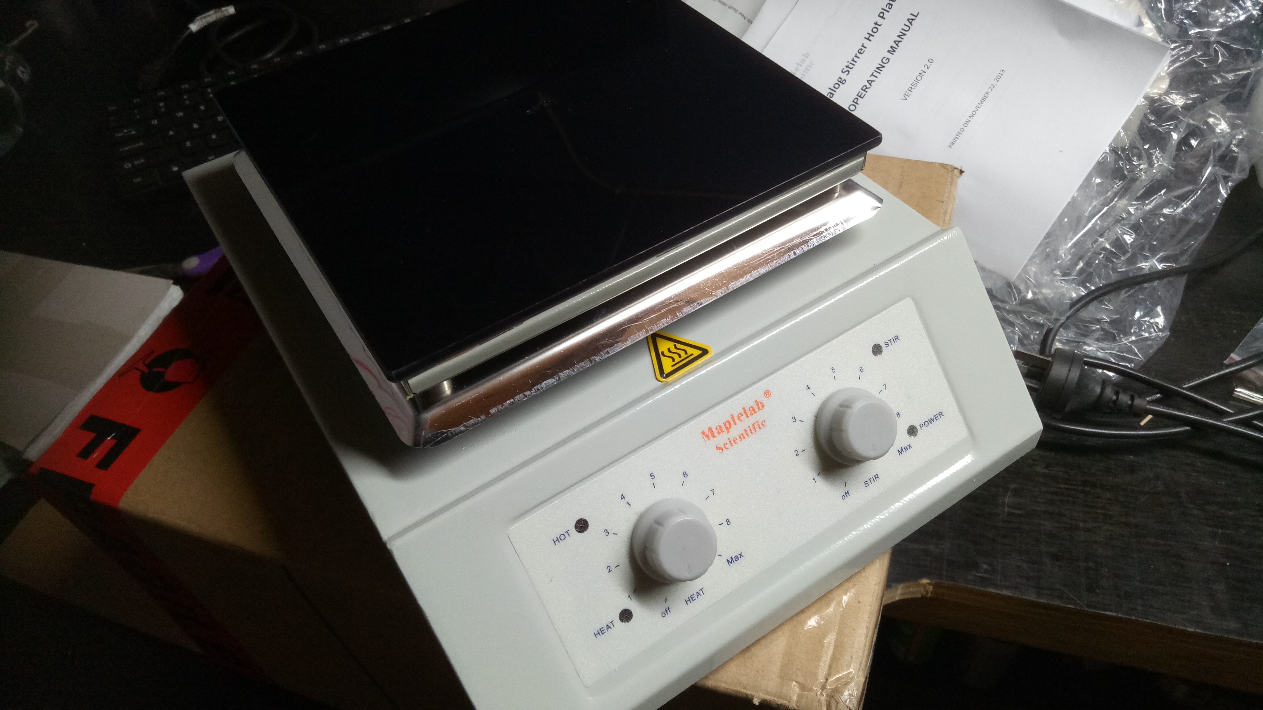

OK so not glassware but here seemed the best place to post it.
Fresh out of box:
2020-05-22 17.32.30.jpg - 2.3MB
This has been a long-overdue acquisition. Ceramic top. Rated to 550°C. Good sturdy construction. Hours of productive fun await.
And for those interested:
https://www.ebay.com.au/itm/New-magnetic-stirrer-high-temp-c...

About a month ago I got a steal of a deal on a Buchi Rotavapor R-200 on eBay.
Unfortunately, the seller didn't package the glassware appropriately and wrapped it in some bubble wrap and placed it in the same box as the heavy base unit. The receiver flask, the condenser, and the end catch assembly were DOA.
Honestly, most of the value was it being a complete package with really interesting, high-quality glassware, so it was a huge disappointment. Luckily the package was insured by FedEx, so he's either going to reimburse me out of that, or refund most of what I paid because of the damage.
I reached out to Adams & Chittenden who said the receiver should be a very routine repair, so should have that back in a month. I then acquired a new condenser, receiver flask, a few new evaporation flasks, and a Woulff bottle (still waiting on that). Here's what it looks like with the replacement parts and some cleaning
I'm really excited to get the fixed receiver flask back. I believe it's 2000ml and I'm not really sure the purpose of the valve on top and the vent on the side. I suspect it's for emptying the receiver without losing vacuum? I haven't been able to find anything else like it to even compare.
I also really like the 2L evaporation flask, it was new in box from a guy who bought out all the old surplus from when Brinkmann was the sole US distributor. The neck on it has an ID of 34mm, same as the steam duct, and it attaches directly to the steam duct, bypassing the adapter while shortening and widening the distillation path for higher boiling point solvents. I wish I could find more like that in different sizes and it makes me sad that Buchi stopped producing them long ago!
Now I'm trying to address the missing base plate insert for the heating bath, the broken end catch, and the lift mechanism. After many a conversation and back and forth with the Buchi technicians, I managed to social engineer several chapters of their official service manual as well as internal repair protocol documents for specific repairs. Those have been a huge help! I think I may just have to buy a new base unit since none of the parts I need are made anymore... I may just get a R-205 while I'm at it too.
Fresh out of box:
How do you rate the performance?
Does it hit the max temperature, and what is the temperature stability like?
j_sum1 - 29-6-2020 at 02:02
In all honesty I have not pushed it yet. Recovery from busted pelvis, catching up with work and family commitments have all kept me out of the lab to a certain degree. Stirring works a charm and it certainly heats up quickly but I have not got anywhere near its limits on either function. I guess that is a very positive sign.

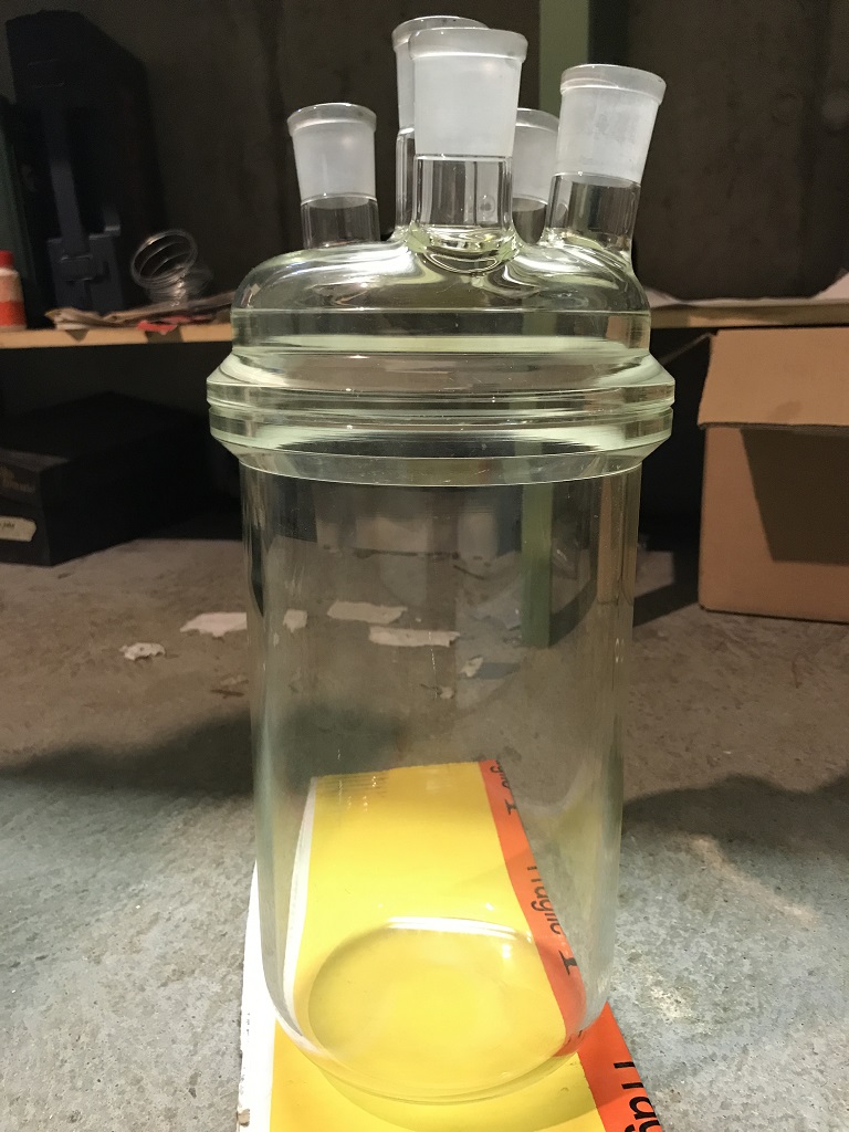

DN 150 reactor

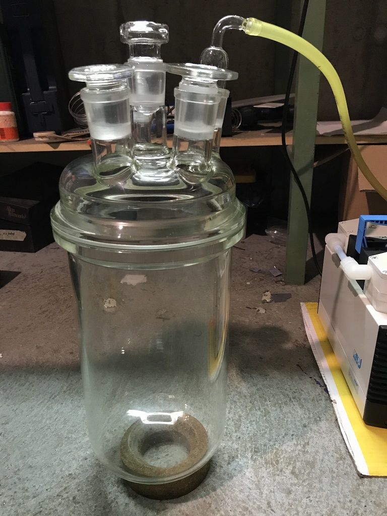

Heptylene - 5-7-2020 at 02:11
I just bought a 4 liter reactor + 5 neck lid on a local website for $80! Came without any damage or chips. It has a large "DN 150" duran flange and the glass is really thick. The ID is about 14.5 cm, OD about 16 cm, 30 cm tall + 15 cm for the lid.
Second photo shows it connected to a vacuum pump to test it.
I have some vacuum and plasma experiments planned for this, but not many idea chemistry-wise. Perhaps a chlorate cell? Does anyone have large-scale reaction suggestions?
reactor1.jpg - 222kB reactor2.jpg - 270kB
Sulaiman - 5-7-2020 at 02:39
There are so many uses,
Dessicator, Digester, electrochemistry, vivarium, ...
First you could consider standardising 'tubing' diameters;
Glass tubing for gas/liquid in/out, thermometer or thermocouple shafts, and maybe overhead stirrer.
As the cheap Chinese overhead stir shafts are 7mm diameter,
maybe 7mm is an option.
7mm od x 5mm id glass tubes could also be used to sheath electrical wires etc.
Might reduce the total number of stopper-adapter pieces accumulated
The ptfe (with internal rubber O-ring) bearing stoppers for the overhead stirrers may be useful.
Dedicated all-glass adapters are preferable due to inertnes,
but glass tubes are cheap enough to try glass bending, stretching and sealing ideas
- without regretting failures
[Edited on 5-7-2020 by Sulaiman]
wg48temp9 - 5-7-2020 at 02:48
You could kill two birds with one stone and try to make coated electrodes by sputtering lead dioxide on to them or just lead with very low pressure oxygen. You will need a microwave oven transformer with a current limiting ballast, preferably rectified for the HT power supply.
Heptylene - 5-7-2020 at 04:43
Sulaiman: Overhead stirring sounds good. Definitely needed for reactions as I doubt my stirbars are large enough for this beast of a reactor. I already have a glass stirrer rod with an impeller which, maybe it fits the chinese stirrer bearings!
I also like the idea of having glass tube to pump liquid in and out. I have a 29/32 thermometer adapter with a teflon joint that actually fits 10 mm tubing, so I might get a couple more for inlet and outlet.
wg48: I actually already have an MMO anode, so lead dioxide is not needed at least for chlorates. Besides I think PbO2 anodes can be made by electrolysis methods. Do you know if the sputtered ones have an advantage over the ones made by electrolysis?
I might try sputtering anyway. Do you know if a roughing pump is sufficient for this? I'm repairing a 2-stage rotary vane pump at the moment, hopefully it will pull down to 1e-5 atm :).
wg48temp9 - 5-7-2020 at 06:14
No I do not know if anodes made by sputtering or other vacuum techniques have an advantage. I can say that potentially they can produce unique materials or unusual forms of compounds that may have desirable properties for anodes. I thought you just wanted to experiment (play)
Sputtering requires some gas pressure to works so a roughing pump may be fine. With single stage pump I have evaporated tungsten from a tungsten rod electrically heated by the current from a one turn secondary of a toroidal transformer. The initial effect is to getter the residual gases and hence improve the vacuum. The film formed was a transparent blue colour (probably an oxide) with good adherence to glass.
You can also improve the vacuum by making a discharge between aluminium electrodes. That also gives an indication of the vacuum. The more defuse discharge covering more of the electrodes indicates a better vacuum. A dark discharge indicates a good vacuum. No discharge a very good vacuum or no vacuum.
You can connect up as much of your glass as you have in a line and create discharge from end to end. it will even discharge thru a wash bottle filled molecular sieves or plastic tubing.
Make certain the last electrode is earthed and is the electrode nearest the pump or the discharge will use the pump as an electrode. That's how I discovered the discharge can go thru a wash bottle filled with sieves I was using as a trap for oil vapour from the pump and water vapour from the chamber.
PS: I found a diagram illustrating how a discharge changes with pressure. Note you only get that type of display with a ballasted DC supply.

A vacuum drying pistol

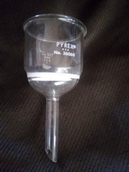

buchner.jpeg - 52kB
Gift from my friend in California
Draeger - 6-7-2020 at 13:22
Wow, what a nice friend. Those things are surprisingly expensive.

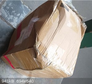

I received some items from Laboy in China today, and I can say that it is fairly high quality glassware. Recommended from that aspect.
The internal aspect of order was well packed, and the exception is that they utilise incredibly flimsy cardboard for their outer packing, so buyer beware if they are looking at purchasing some of the more delicate pieces from this place. No pieces were broken, but I don't know how.
pic1.PNG - 941kBpic2.PNG - 393kB

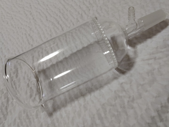

I picked up an auger funnel, a backup 90mm 1L pore plate funnel (which is very high quality and rings like a bell), and some microscale odds and ends. I don't actually need a new pore plate funnel, but my current one is one of my most heavily used pieces of glassware, and I don't want to have to wait for months if I break it.
augerfunnel.jpg - 142kB porefunnel.jpg - 138kB 14-10.jpg - 140kB
[Edited on 25-8-2020 by JJay]
Sulaiman - 25-8-2020 at 02:20
Not only have I never seen a pressure equalised auger funnel,
I never knew that they existed.
Please video the use of it.
JJay - 25-8-2020 at 02:38
I'll see what I can do. I don't actually have a purpose for it yet, but I'm sure I'll come up with one.

Distillation head for taking off reflux at desired ratio, received just today. 1 good supplier was able to obtain it for me, it was freshly made in lab glass factory. 29/32 ground glass joints for attaching flasks and 14/23 for thermometer (dimensions used widely in my country).

That is a nice one. Out of curiosity - how much cost such a piece of glassware made on demand?
Fery - 4-9-2020 at 22:32
Hi outer_limits, the reseller asked for 8500 CZK which is approx 320 EUR. If I had contacts directly in glassware factory the price would be lower, but I was really very happy that this reseller was able to obtain this rare piece of glass for me. He has been waiting for 3 months using an official way without any sign of result, so then he asked directly the glass worker (good old contact) then he got the glass immediately. I would pay even more, glass is always much more valuable than money :) I believe that the most difficult part in creating the piece was to create the loop. Connecting 2 ends of glass to create 1 connection is not so difficult, but creating 2 connections simultaneously (connecting 4 ends) is a masterpiece (I cannot imagine how to do it using only 2 hands, perhaps it required 2 workers to do it synchronously).

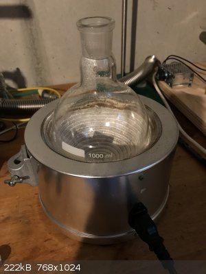

I finally have a heating mantle and it works like a charm!
heating mantle.JPG - 222kB

The glassware I ordered from Aliexpress arrived a few days ago. Deschem's famous foam coffin works like a charm every time. Also ordered a few glass beakers and graduated cylinders to start off my home chemistry glassware set.
IMG_20200914_135739.jpg - 3MBIMG_20200914_135917.jpg - 3.2MB
Reading this I remember using following setup for reflux with items I had on hand:
- Packed column with raschigs
- Claisen head with thermometer on straight end and reflux condenser on bend
- Take-off valve with ground joints
With this I had total control of reflux, the condensate pooled in the takeoff valve and rest poured back to the column.
This could also be done with clevenger or dean-stark, especially with the smaller volume ones which a smaller cuts could be made.
[Edited on 17-9-2020 by Fyndium]

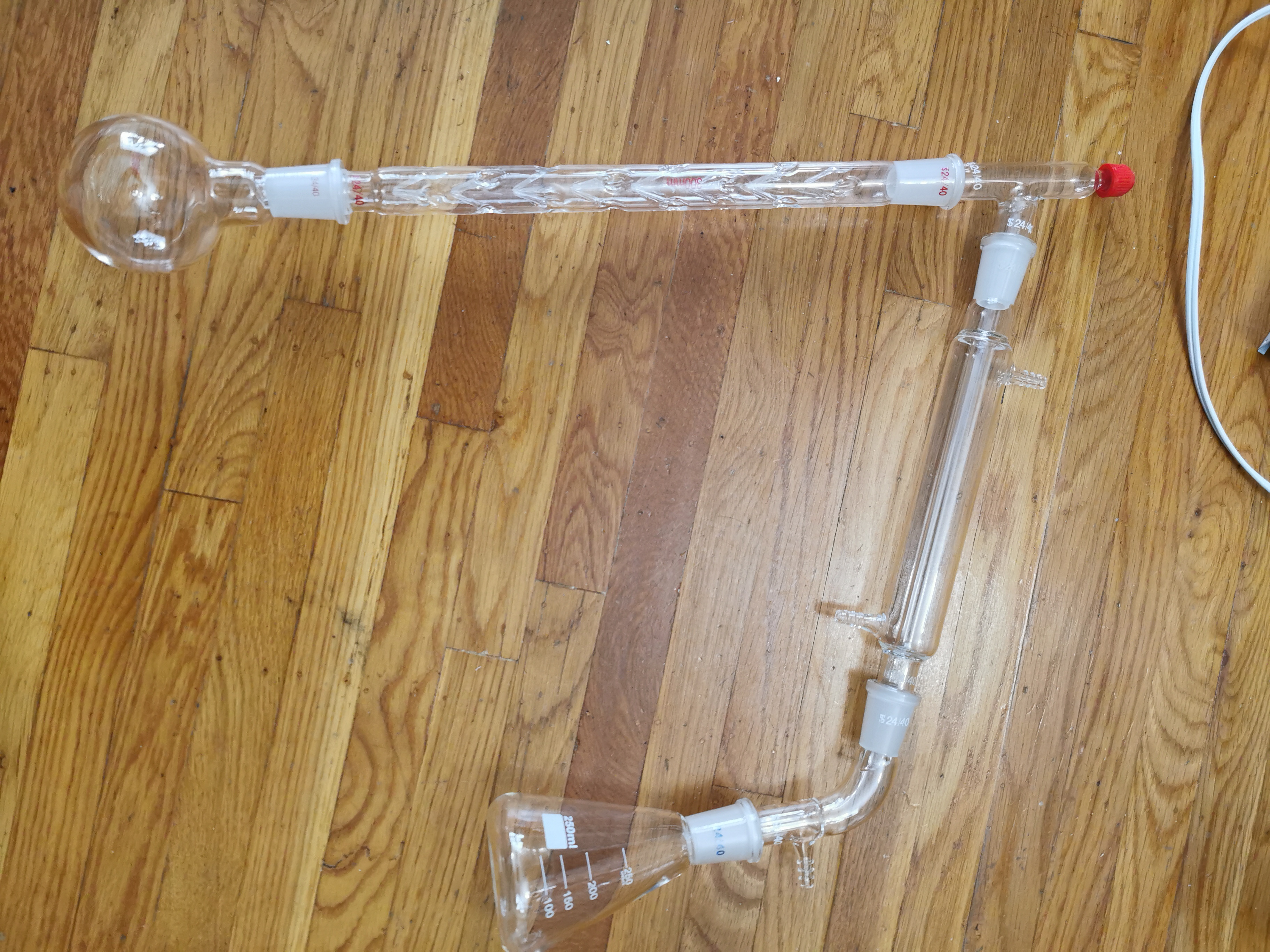

teodor - 5-10-2020 at 03:24
I was unable to fractionate some of my small-scales synthesis with usual full-scale separate Vigreux column and Claisen head. Feeling of unfinished jobs is devastational - my fridge contains several bottles of crude, not purified products. So, today eventually I've got this.

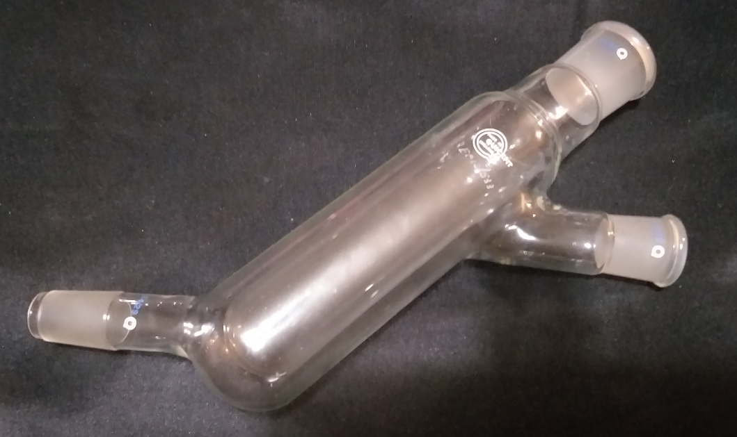

Heptylene - 18-11-2020 at 09:23
I just got an Anschütz-Thiele receiver, which is the german version of the Perkin triangle. I've been trying to find one for some time now since they cost an arm when new. Thankfully, ebay exists and an opportunity finally presented itself :)
This is actually a really useful piece of equipment: it allows the collection of many fractions during vacuum distillation without having to bring the whole apparatus back to atmospheric pressure. Normally you are limited to 3-4 fractions if you're using a cow receiver, but not with this!
