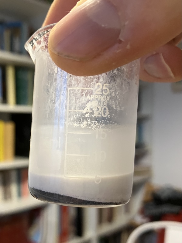

Okay. So I bought a bottle of 13% NH₃ (d = 0.95) in a convenience store and tried the process with weights and volumes divided by 100. It definitely works. However, I couldn't reach a ‘klar Flüssigkeit’. I had a lot of zinc oxide in suspension (see picture), and I stopped the reaction when it seemed to me all the zinc had reacted. The few spots of zinc you see spattered in the white powder are zinc which had stuck to the stir bar.
The titration I did next was not very conclusive. I missed my first one, because I failed to take into account that the excess ammonia would neutralise the few drops of sulphuric acid I had used with the permanganate. I then redid it with a large excess of acid. The yield was probably around 65 to 70%, which is not bad, given that I really eyeballed it (~6.5 mL where 100% would have given me 4). Must have been mechanical loss in the filtering and my process was very rough anyway.
It may be worth trying with 10x more reactants. Will do that if I have the time.
[EDIT: Ooops forgot to attach the picture! This is A 25 mL beaker btw]
IMG_2974.jpeg - 1MB
