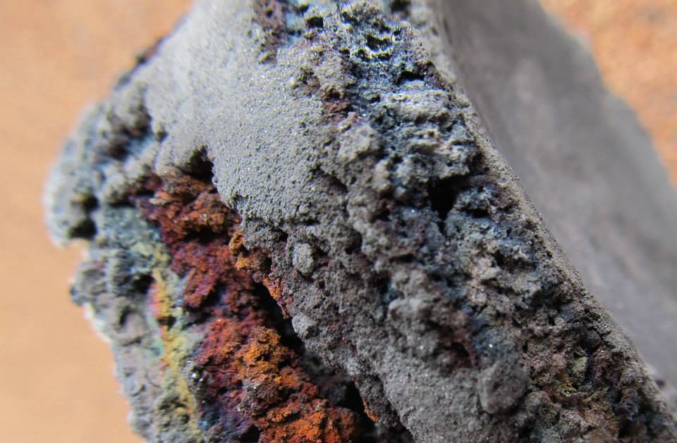

Ag2SO4 thermite
I gave this a whirl about three years ago. I used 300MESH magnalium powder as the fuel and diapered the mixture together. The mixture was ignited with a piece of visco-fuse.
vlcsnap-2010-11-11-19h12m36s190.png - 139kB
The composition would self-confine easily and it was a very vigorous reaction. Due to no presence of nitrogen in the reagents, one could only deduce that it would decompose the nitrogen in the air into various oxides, as evident from the orange fumes in this still image.
Compared to silver nitrate, silver sulfate has a low solubility in water with a quick glance at Wiki quoting its solubility at 0.79g/100mL at 20 degrees Celsius. I actually never experimented whether or not it would be water sensitive, but having no interest in its practical uses it wasn't an interest at the time.
I also experimented with silver oxide, but the results weren't nearly as exciting. Perhaps my ratio calculations were off. To this day, I still have 300g of both these silver salts, as well as acetate...

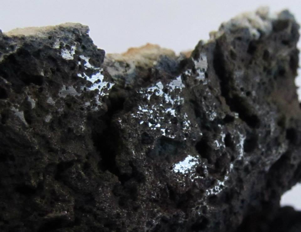

I made titanium ingot, Aluminum reacting with TiO2.
I was curious about the reaction of Magnesium with TiO2, unpressed.
Out of 300 g of a mixture (TiO2 + Mg 62:38) I have received 160 g of black powder.
The flame burned up to 1 to 1,5 meters.
Is it possible to extract titanium, from this powder ?
[Edited on 19-12-2014 by specialactivitieSK]
Al2.jpg - 62kBAl1.jpg - 78kBMg.JPG - 2.1MB
Tdep - 19-12-2014 at 06:18
I believe that's a lower oxide of titanium. I would recommend re-doing the thermite with the black oxide to try and reduce it all the way to the metal
gdflp - 19-12-2014 at 06:46
Yep, that's most likely titanium(III) oxide.

A little while ago I was experimenting with thermites that could be made with common and cheap metal/metal oxide combinations. I came up with two that rather than burn at a high temperature like a normal thermite, explode colorfully. The first combination I came up with is zinc and copper oxide (ZinCox I call it). I took cupric oxide (CuO) that I obtained by taking "Basic Copper Carbonate"
which I got from electrolysing copper pipes in tap water (I know, not very pure, but it has just enough ions to get the electrolysis started). Initially the source voltage was around 300V (From an inverter I made with 10 disposable camera flash circuits in parallel charging a 1200uF cap bank through rectifiers) then after enough copper ions had formed in the solution to allow the electrolysis to sustain itself I switched over to a 12V 15A power supply and let the electrolysis run for about 72 hours, replacing the anode occasionally and scraping as much of the basic copper carbonate into a separate container as I could manage. I later filtered the copper carbonated, air-dried it, and then heated it in a crucible at 600F until the green powder had turned uniformly black, and ground it using a mortar and pestle until it was a super-fine powder (it crushes like talc).
I mixed this in a 1 to 1 molar ratio with magnesium or zinc powder. When lit off in a fire-cracker-like package the materials explode rather powerfully. They both produce a small blue-white fireball and a lot of noxious smoke.

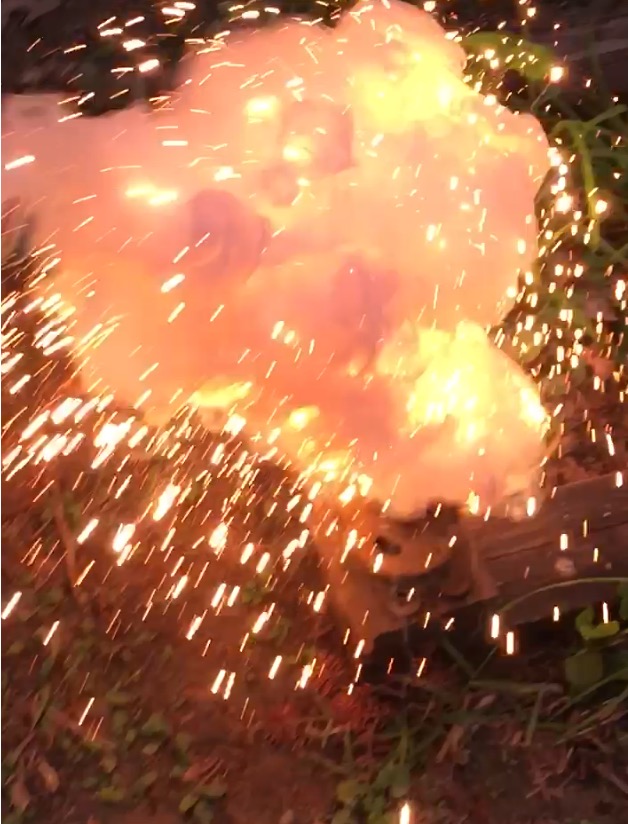

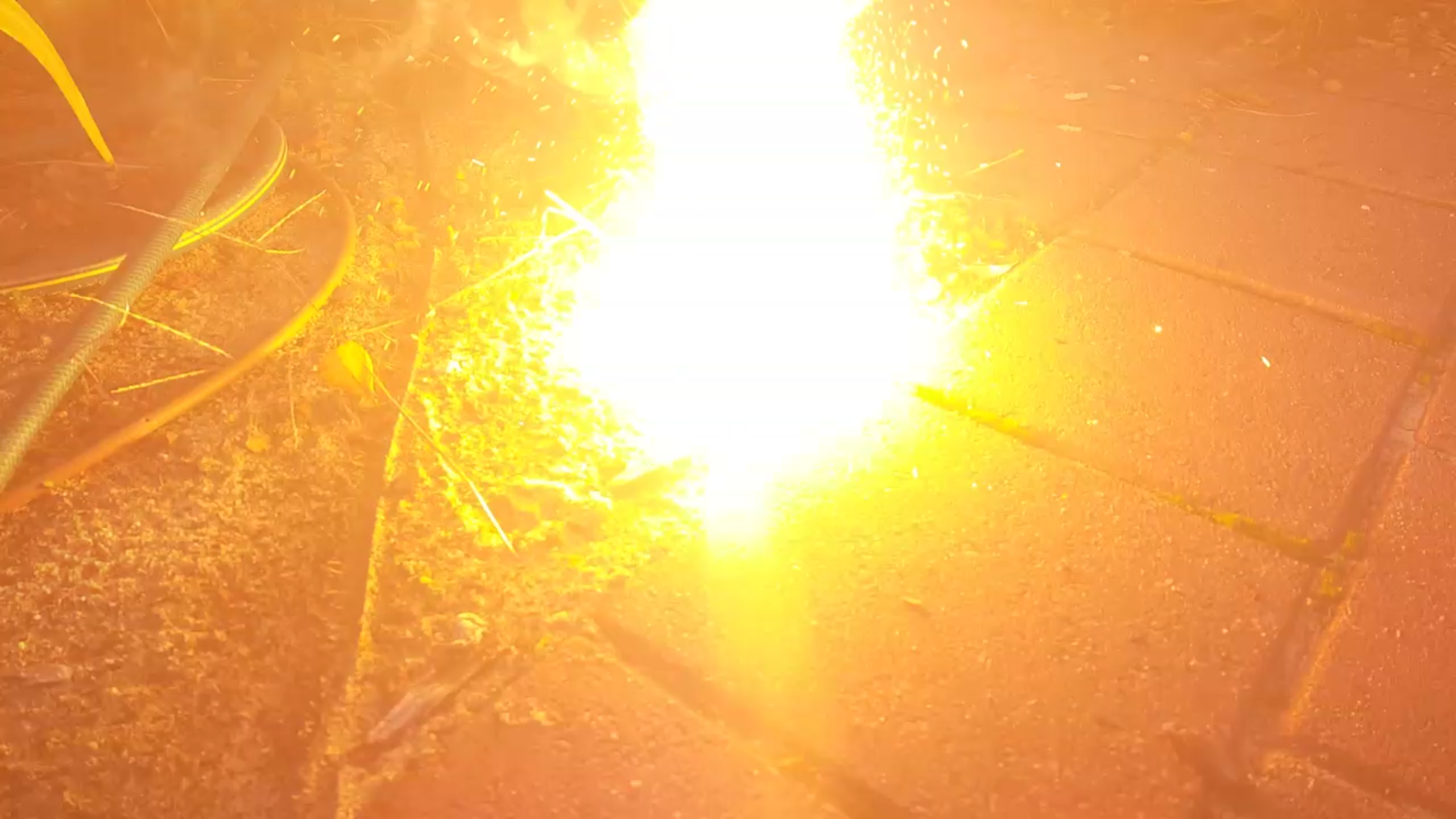

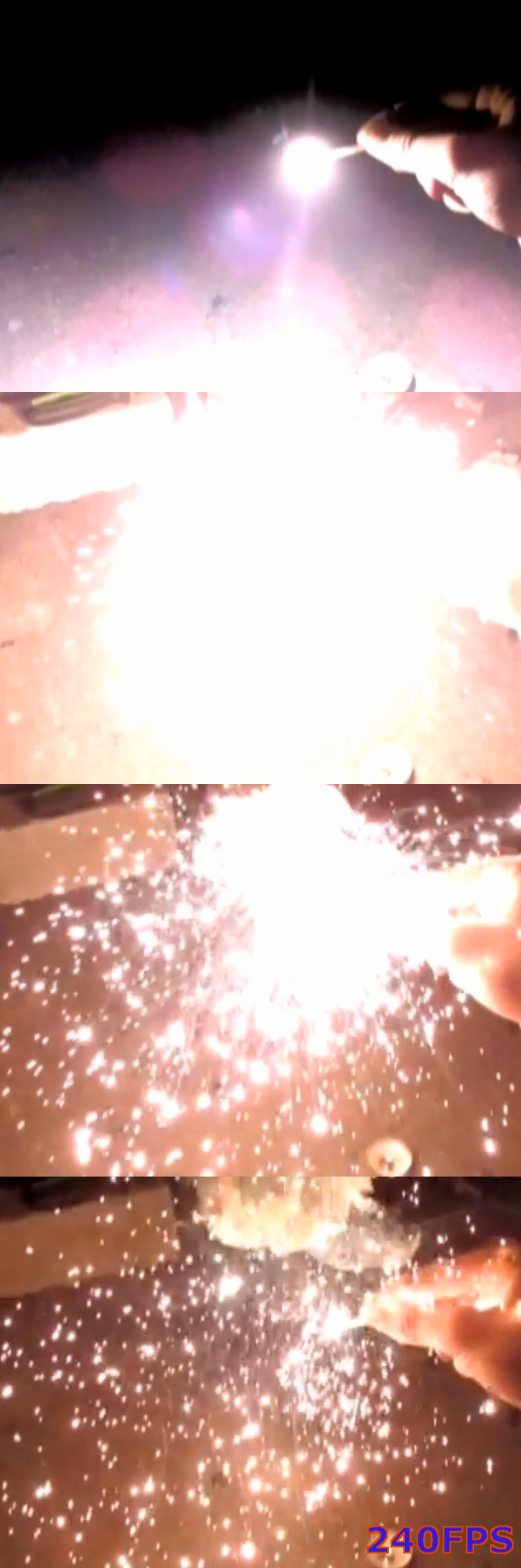

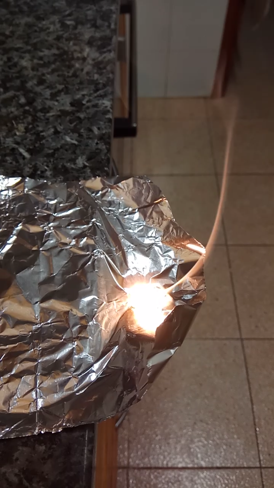

Today I ignited about 600 milligrams of thermite made with 200-325 mesh magnalium and red iron oxide (pottery grade, extremely fine, I can post a photo if necessary). Much to my surprise, it did not deflagarate like traditional Fe2O3/Al thermite, rather it deflagarated extremely fast (for thermite, slower than flash powder), and on analysis of the video the flash lasts ~8 frames. Can anyone provide insight as to why this happened? I mean, 4 of the frames are a completely yellow-white screen. That is simply not consistent with what I have seen of iron oxide thermite. Any comments? Thanks.
ShotBored - 24-5-2017 at 16:51
What was your ratio of mag-al to Fe2O3?
Elemental Phosphorus - 24-5-2017 at 17:42
250 milligrams of magnalium and 350 milligrams of red iron oxide.

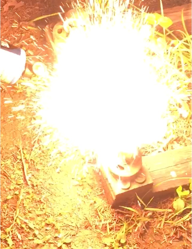

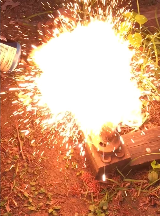

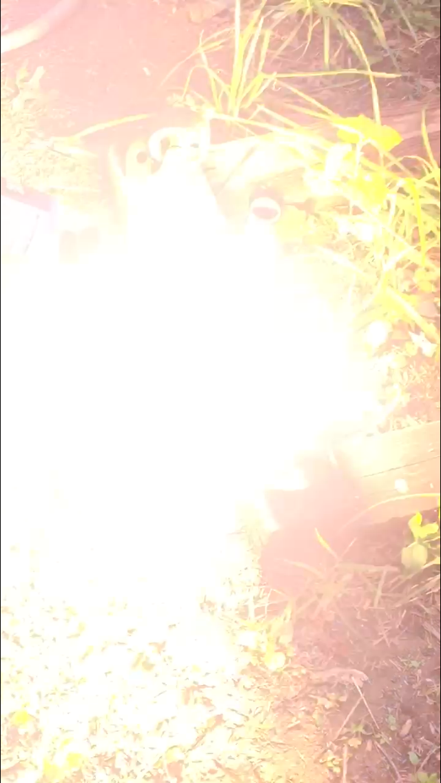

greenlight - 24-5-2017 at 23:53
I have done some tests with magnalium thermite before and took photos.
I had a similar ratio to the one you list to start and it deflagrated very fast mainly throwing red hot metal all around and slightly charring what it was in contact with.
Results from testing in 5 gram amounts were:
2:1 Fe2o3:Mg/Al = Slightly slower but still too fast burning. Nearly no slag left.
3:1 Fe2o3:Mg/Al = Much slower burn rate 3 seconds) leaving some red hot slag.
4:1 Fe2o3:Mg/Al = Even slower burntime (5-6 seconds) leaving a lot of red hot slag behind.
I found it to be about perfect between the two last ratios. Here are two pictures of the tests midburn that I found. The left is the ratio similar to yours and the right is about 4g iron oxide to 1.2g Mg/Al.
[Edited on 25-5-2017 by greenlight]
2017-05-25 15.38.37.png - 2.8MB Screenshot_2017-05-25-15-43-00.png - 2.2MB
PHILOU Zrealone - 25-5-2017 at 00:40
Magnesium si more reactive than Aluminium so the mix ignites faster and easier...the activation energy is thus lower.
Magnesium burns brighter than Aluminium so your photo or video camera sensor did a (over)saturation of its sensor and had not the time to adapt for brightness.
Elemental Phosphorus - 25-5-2017 at 03:58
That makes sense, thanks. I was going to guess that since I had not previously dried the red iron oxide, it was a steam explosion. But that didn't really make sense, since there was a very bright flash, and the oxide didn't seem *too* wet. I'll post some freeze-frames later today. Anyhow, I'm glad I only made 600 milligrams, since I did not expect a fast deflagaration. I suppose that I can take away the lesson to always test any sort of pyrotechnics or energetic compositions in small quantities.
PHILOU Zrealone - 25-5-2017 at 12:04
Yes prior small testing is a must not only once, but everytime a parameter changes...moisture, new ingredient or batch, different mesh, different temperature, different confinement,...
And when scaling up...it is a good idea to do it by slow increments for safety considerations...even a simple scaling up factor 2 has lead to casualities onto industrial plants or on lab reactions process...via unsuspected side-reactions with a lower minor thermodynamic kinetic at one scale but higher and major at double scale...
Photos, as promised
Elemental Phosphorus - 25-5-2017 at 13:26
Here are the photos, as I promised:
image.jpeg - 131kB image.jpeg - 164kB image.jpeg - 138kB image.png - 660kB
Edit: I chose to omit the entirely white frames since those don't really help.
[Edited on 25-5-2017 by Elemental Phosphorus]

Piroz - 28-2-2021 at 16:06
Few years ago I had some experiments with Fe3O4/Al thermite, I found it have very interesting properties. As you know this type of thermite is hard to ignite but finely powdered is very easy to do it- just by touchung with flame from match or lighter etc. In large amounts it burns really fast however in tiny amounts it can "explode" giving enormous amount of light (it blinded me for several seconds) and sparks shower. Here the video with tiny amount of thermite burned on match in slow motion:
https://youtu.be/_Mp24ePmUiM
And here the second video with thermite compilation, with Fe3O4/Al, except first burning termite. If particles are bigger but not too much also greater amounts of thermite can explode. After slightly heating in flame thermite starts to glow more and more and suddenly explodes.
(in the video finely powdered thermite form 1:30 to end):
https://youtu.be/gsdWFBVx2fc

Linus1208 - 7-6-2021 at 04:57
Flour-fine CuO from a ceramics supplier burned with extreme vigor with 300 mesh aluminum in a stoichiometric ratio. I ignited one charge of about 30 grams at night with a hot aluminum/sulfur ignition mixture. The thermite mixture was in an aluminum can with the top cut off and the igniter laid on top. The CuO/Al burned in a fraction of a second with a hearty "whump!" and shot glowing debris (likely the igniter slag) 10 meters in the air.
A 50 gram charge of the same mixture was initiated in the daytime with 2 grams of HMTD. There was a satisfying flash and explosion, and a large cloud of brownish smoke (vaporized copper mixed with aluminum oxide) rose above the test site. It is interesting that this mixture yields *no* permanent gases at STP yet exploded with sufficient force to make the plastic stand holding the charge vanish without a trace.
"standard" thermite?
A mix of anhydrous copper sulfate and magnesium (45µm) in a 13:2 or 20:3 ratio reacts very violently, I discovered it when I wanted to make CuO / Magnesium Thermite (which doesnt react as violently) but didn't have CuO on hand.
Even though the CuSO4 wasn't that fine (Idk how much exactly but similar to fine sand, maybe a bit finer) ~25g of it unconfined exploded very violently when ignited by a plain old sparkler (--> attachment).
Attachment: IMG_0523.TRIM (convert-video-online.com).mp4 (4MB)
This file has been downloaded 645 times

Linus1208 - 20-11-2021 at 06:15
So I noticed I completely miscalculated the ratio (it was still explosive though). The stoichiometric ratio would be 4:3 anhydr. CuSO4/Mg. In this ratio small amounts (1/10ths of a gram) deflagrate quite strongly, definetely comparable with permanganate flash. A knife edge amount loosely confined in aluminium foil, ignited by heating in a flame will go off with quite a good bang. The problem with this mixture still is that it's hygroscopic, so it needs to be stored air tight to be usable for more than 2 or 3 hours.
