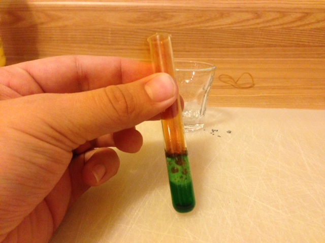

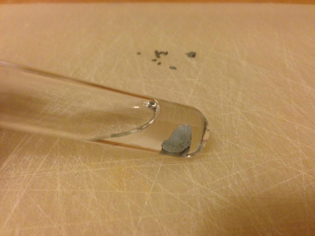

As for the chromium? No reaction with nitric acid. It passivates. Just for fun I did a quick little demo here :)
70% HNO3, along with a dumped out container of pure Cr.
photo 1.JPG - 109kB
Threw a bit of Cr in the HNO3.... No reaction.
photo 2.JPG - 87kB
And of course, to avoid wasting the HNO3, who could resist....Copper turnings!!!!(you can see the nitrogen dioxides running over my skin, so nice!)
photo 3.JPG - 101kB
[Edited on 3-11-2012 by Mailinmypocket]

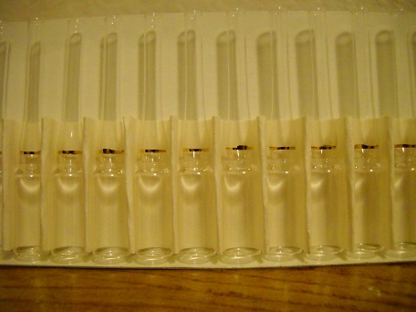

darel - 2-2-2013 at 13:38
I purchased a few small ampoules with a gold band where I assumed it is to be broken. I originally thought it was gold or some thin sheet of metal that when heated would have broken the glass at that point on cooling due to thermal stress. Upon research I found it is color coding.
http://en.wikipedia.org/wiki/Ampoule#Ampoule_codes
http://link.springer.com/article/10.1007%2FBF03007733?LI=tru...
That was all I could really find. Does anyone know or have a table for what these codes are?
Ampoule.jpg - 169kB
Vargouille - 2-2-2013 at 16:01
The bands aren't ampoule codes, they're indicating where the ampoules have been prescored. See here.
