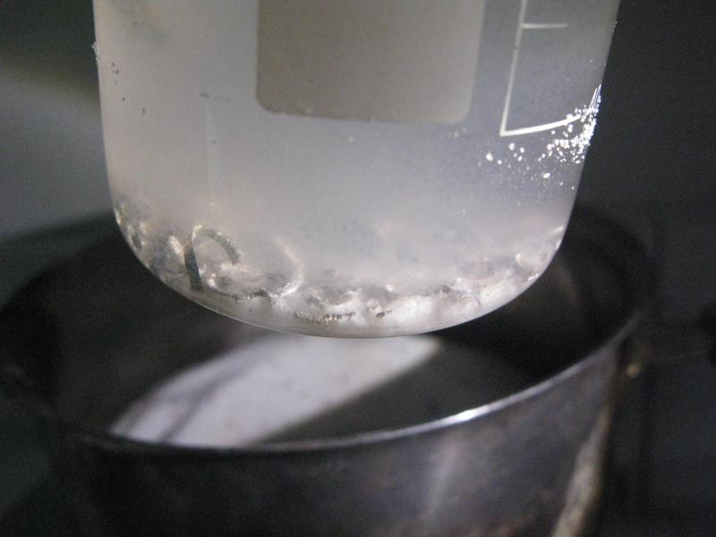

metalresearcher - 19-2-2011 at 03:20
Another try of my experiment:
I heated the beaker in a sand bath and kept it at 190 C (to prevent boiling) During heating up it bubbled when 80-100C: is that the reaction ? Refluxing is done by a porcelain crucible on top of it and the thermocouple wire through the spout which kept virtually all oil inside. It had been running for 45 minutes. Or should I stop heating further when it bubbles (not as a result of boiling).
Here a picture : I cannot recognize the K metal did it form ??
IMG_4472.JPG - 40kB
[Edited on 2011-2-19 by metalresearcher]

blogfast25 - 19-2-2011 at 08:09
Preventing boiling isn’t really a solution to anything. Even at 190 C the vapour phase of the catalyst/solvent mix contains a lot of the alcohol. Also, the actual potassium forming reactions are likely to be very temperature dependent, thus slower at 190 than they are at 200 or 210 C.
The initial bubbles you see at 80 – 100 C are the removal of moisture in the KOH by Mg. Actual metal formation starts (we believe) much later and at higher temperatures. They are slow reactions, requiring several hours to complete. 45 minutes is really nothing.

peach - 24-2-2011 at 10:48
Results with kerosene, argon, magnesium from a sharpener, t-butanol and 24h of reflux
Method
I have used the same KOH and kerosene as before, and acquired the magnesium by drilling holes in a pencil sharpener with a 6mm drill bit.
The KOH and magnesium was weighed into 20ml of kerosene, the glassware setup and thoroughly rinsed out with argon. 1ml of t-butanol was then added to the funnel along with 5ml of kerosene, before more argon was added and the glassware sequentially closed up. The exit of the glassware is through an oil bubble.
This was brought straight to reflux and I noticed gas evolution in the oil bubbler. Slower than before, and fully stopping after 1 hour. I proceeded to add the alcohol over 30 minutes, using two 5 minute additions to split it in half.
Over three hours, the solution gradually turned a dull grey, and the magnesium itself. There was a building layer of white solid around the surface of the solution, which was well fixed in place regardless of the mantle temperature. I saw bubbles evolving at the trap approximately once every thirty seconds. After calculating the reaction could take up to 56h to complete at this temperature and rate of evolution, I decided to leave it as long as possible.
Approximately 11 hours after the refluxing starting, I returned and was unable to see any bubble in the trap over 3 or so minutes of watching it. The white solid had now blocked off the entrance to the funnel, and I had been concerned it would do the same with the remainder of the flask, but it seemed to have stopped growing directly under the condenser, so I felt confident leaving it to reflux overnight.
After 24h of reflux, I stopped heating. Whilst this is around half of the predicted time, there would still be enough potassium present for me to see it if it had functioned.
Once cooled, I emptied the flask out into a beaker and began looking for signs of potassium. I found none. On adding water, there was nothing abnormal.
I was able to remove the white solid with hydrochloric. And I found the material that had been blocking the addition funnel has, in part, 'melted', despite it now being removed from the glass.
Observations
I suspect the white solid I saw may have been KOH, perhaps bound up in oil somehow, as it would explain how it seemed to melt on exposure to the atmosphere.
I am in 100% agreement with Len that the percentage of magnesium you require to dry the KOH has to be finely divided for the solid / solid interaction to function. (***Len, you know what patents are like. They are not lying by forgetting to tell you that and they could easily argue it should be common knowledge, but they are preventing easy replication, 'theft', of the patent).
I strongly believe the slow evolution of gas I saw before adding the alcohol was directly related to the large size of my chips. On this point, notice how full the flask appears when the chips are larger.
I also agree, it is unlikely to be critical if the remaining magnesium is powdered or not, as the second stage is a liquid / solid reaction. It would likely function faster with a smaller particle size, but this also means using more expensive magnesium for the entire mass.
As a result, I am growing suspicious of the discussion of 'magnesium purity', and believe it is more to do with this first drying stage and ensuing the magnesium is not passivated before adding it (perhaps by freshly producing those chips or rinsing the magnesium with dilute hydrochloric before hand; this is used with amalgam methods, where the oxide on the aluminium is first removed with dilute NaOH / KOH and the aluminium is then rinsed to remove the alkali, immediately before adding the aluminium to the flask).
Judging by the gas evolution rate after my addition of alcohol, temperature is critical to getting it done in a few hours. I believe the gas I was seeing may have been due to water left in the KOH, and not from potassium formation.

KOH
STAND UP FOR CHRIST'S SAKE! It's the Queen! A 2p for size comparison. These came from a 6mm drill bit.
Remember the original "You've got loads of magnesium in there! Where's it gone!?" arguments?
It's home, for the next day
Starting to warm it up
What I would guess to be around 3-6h later, given this camera has no time stamp, the white solid appearing around the top
You seriously want one of these
Many hours later, 24 of them to be exact
I don't see blobs, but I can't see much through all that muck anyway
Nil poi!

blogfast25 - 24-4-2011 at 10:11
Latest crop of K globules under recycled Shellsol in a 100 ml conical flask:
Mostly 0.5 - 1 cm balls, nicely clean-skinned, some smaller ones too. Will be further coalesced tomorrow for yield determination.

blogfast25 - 25-4-2011 at 08:16
Yes to Cs but it’ll have to wait until Na has been tackled: CsOH isn’t easy to come by for hobbyists.
Meanwhile, another potassium floating experiment failed. I’ve been trying to get potassium to float in various hydrocarbon liquids but to no avail. Density is the key point here (stating the blindingly obvious). At RT the density of potassium is about 0.862, at MP (63.4 C) about 0.828. So I took the heaviest hydrocarbon liquid I had lying about : 10W40 engine oil (for petrol engines, from TESCO) and dunked a few very small globules of K and one about 0.5 cm in it. The density of the oil had previously been determined as 0.884 at RT.
Well, bizarrely the small ones did float but the larger one didn’t… Heating to about 160 C didn’t change anything… except that the small ones dived too! At 160 C the density was again estimated to be about 0.834.
Interestingly, the engine oil, undoubtedly compounded with antioxidants and other adjuvants, did not react noticeably with the molten K.
I seem to recall nurdrage got floating potassium with Nujol (IR paraffinic oil) and that’s got a density of only 0.838. I just don’t get it…

blogfast25 - 25-4-2011 at 12:01
Tanker78:
Thanks for the kind words. :cool:
Engine oil is now off the menu: the hope was to improve coalescence (thus reduce process time!) by having the nascent K float to the top but the 10W40 didn’t deliver.
A HC in which sodium would just about float would require a density of d > 0.927 (molten Na at MP) and that’s very high for a liquid hydrocarbon (plus: they expand quite a lot on heating). To reach above 0.9 with HCs (and stay liquid) you basically need to introduce heavier hetero atoms into your H and C based molecules. O and Cl, Br, I are obvious candidates but show far too much affinity for alkali metals. (Booom! potential)
With silicones you’d go above 0.9 easily but it’s a recipe for a brisk alkali metal fire. Yum.
So it really isn’t that easy…

blogfast25 - 26-4-2011 at 04:26
Watson:
Whatever the cause of poor floating/poor coalescence, it’s a major problem because it increases the process time enormously. The chemistry is basically over in about 1 h, 1 ½ h tops and could possibly be sped up further with a better catalyst but the coalescing tine is what it is: basically about 2 h. And the poor coalescence affects yield also: many fine particles are lost, irrecoverably. The last test gave a de facto yield of 55 % for instance, not great.
The long coalescence times may also cause the MgO to clump together (I feel the larger lumps are the product of some accretion process), which also makes separating the wheat from the chaff harder….
Surface tension must play a part: I’ve seen quite large globules (> 1 g) dent each other, yet refusing to merge! Len1 claims the lowest metal viscosity (ergo highest temperature) is beneficial but I’m still not convinced by that argument. Lowest possible solvent viscosity must be beneficial as lower viscosity reduces the film thickness separating the globules and the film should be easier to pierce.
Do you think glycine has some solubility in hot alkanes?
I also seem to remember someone using dioxane (but at much lower temperatures, obviously). Furan might be a possibility as well…
[Edited on 26-4-2011 by blogfast25]

blogfast25 - 30-4-2011 at 09:43
Following Tanker’s suggestion to look at polyglycols (such as found in brake fluids) as coalescing liquids, I purchased some DOT for a simple test.
Well, I couldn’t get DOT 3 but got DOT 4 instead, which states ‘contains polyalkylene glycol ethers and ether esters’. I believe these brake fluids are highly anhydrous because moisture would reduce the desired high boiling points and could lead to ‘spongy’ brakes.
A globule of 0.5 cm diam. of clean K was placed in a few ml of the liquid and the assembly immersed in a water bath, starting at RT. The K floats right away and at RT there isn’t much reaction going on. But as temperature increases and bubbles started to form on the surface of the metal. At about 40 C the reaction is brisk (but contained) and the metal dissolved in the DOT 4 in matter of a minute or so.
This reaction, assuming I’m right about the water, must come from terminal OH groups present in the brake fluid, thus rendering it unsuitable for contact with (warm) K.
This defect could possible be remediated by esterifying the -OH groups. But that’s not so simple either: any excess carboxylic acid not used is likely to be miscible with the brake fluid, as would also reaction water. These would then be fairly difficult to separate from the bulk of the liquid…

blogfast25 - 30-4-2011 at 12:15
To further evidence that the DOT 4 does contains alcohol functionality I tested the substance as follows (it’s a little test I devised some time ago): to two test tubes was added 5 ml of 1 M K2Cr2O7 in 1 M H2SO4. To the first was then added 8 drops of ‘methylated spirits’ (ethanol, essentially) and to the second 8 drops of DOT 4. (Dichromate oxidises primary alcohols to carboxylic acids and secondary alcohols to ketones (it doesn’t affect tertiary alcohols) and is itself reduced to green/blue Cr3+.)
At about 70 C the ethanol control reacted fastest of the two but the DOT 4 tube really wasn’t far behind: within minutes both tubes had their dichromate reduced to Cr3+ COMPLETELY. This shows strong alcohol functionality present in the brake fluid…
Tanker, to carry this further means to me to have to eliminate the alcohol functionality: it's no good using a liquid that react with the metal, even if reactivity was much smaller than it currently is.
Like I said, it might work better for Na.
I will seriously consider esterifying the DOT though: these polyglycol ether esters are interesting liquids and could indeed be good coalescing agents, if modified. I might raise a note in the organics section about it...
[Edited on 30-4-2011 by blogfast25]

blogfast25 - 1-5-2011 at 09:46
Well, well: the result of the DOT 4/kerosene (50/50 V/V) was a bit unexpected. Firstly the liquids don’t mix completely and form a two phase system, kerosene on top (obviously). Dropping a small piece of clean potassium in it, it settles at first at the interphase. But then, as temperature rises the K starts reacting with the DOT 4 and it shoots up into the kerosene phase because of the hydrogen which ‘carries’ it. The reaction then subsides and it sinks back into the interphase where it starts reacting again, then shoots up into the kero, etc etc. Here it is currently floating in the kero (this is a 1” test tube):
As a result the potassium lasts much longer and I lost only about 50 % (still way too much) or so after cooling.
Interestingly this two phase approach could be useful because the kero protects the metal from air oxygen. The activity of the DOT 4 remains too high for K though.
As a sideshow I’ve estimated the -OH functionality of the DOT 4 semi-quantitatively with a simple experiment. To 3 test tubes was added 15 ml of 0.1 N K2Cr2O7 in 0.1 M H2SO4 each (note: this was 0.1 normal dichromate, not as previously used 0.1 molar dichromate - it’s 0.1/6 M). To the first (the control) was added 1 ml of methylated spirits (this reduced all dichromate quickly to Cr3+) and to the two others resp. drop by drop methylated spirits and DOT 4. All tubes were kept on water bath (about 90 C) and plenty of time was allowed between drop additions for the reaction to proceed (it’s slow at these concentrations). By comparing the colours of tubes 2 and 3 with the control it could be estimated how many drops of alcohol and DOT 4 were needed to achieve complete reduction of the dichromate.
The methylated spirits took about 9 drops, the DOT 4 about 17 drops. So in essence and approximately to completely esterify the same volume amounts of methylated spirits and DOT 4, the brake fluid would require about half the quantity of an (identical) alkanoic acid (no wonder it reacts vigorously with Na and K!).
This approximate result could also be used as a basis for back titration of an excess of dichromate which should allow precise determination of the molarity of the -OH functionality of the brake fluid.
