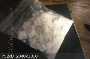

JJay - 19-1-2016 at 15:43
I haven't finished building my lab yet, but I figured I would start the workup. I distilled off the remaining ethanol and discovered that the solution contained more water than I had expected. So I distilled off the water until crystals started to form, after which I transferred the solution to a dish and warmed it gently to drive off the remaining water. The sodium ethyl sulfate precipitated as flakes.
This is the crude, slightly wet product. I will have to finish building my lab before I do the final purification.
[Edited on 19-1-2016 by JJay]
20160119_142336.jpg - 823kB
JJay - 16-3-2016 at 13:41
Today I heated about 100 grams of crude sodium ethyl sulfate in 450 mL of methanol with stirring. This formed a cloudy suspension... I suspect the contaminants are sodium bicarbonate and sodium sulfate, but I don't really know how much contamination there is, and I'm not really sure how much methanol to use.
This suspension is extremely hard to filter... the suspended particles form a layer on the filter that is almost impermeable, and the filtrate quickly gels in the flask under vacuum.

JJay - 9-4-2016 at 14:04
Sounds like you need more solvent. Hot solvent.
BTW my earlier comments were unrelated to where sodium bisulfate is the source of sulfuric acid; just the textbook route, where step 2 is removal of sulfate with CaCO3. It's a tedious step if you're making a lot, but when done carefully, everything else is simple.
I tried a variation on Cohen's textbook procedure for potassium ethyl sulfate (in Practical Organic Chemistry) with 200 mL of 95% sulfuric acid and 600 mL anhydrous ethanol. It was a lot of work, but right now I am looking at about 500 mL of crude, saturated NaEtSO4 solution. It really wasn't that hard, and that's actually consistent with his yields....
JJay - 10-4-2016 at 11:10
It looks like I am the only one interested in this topic....
600 mL anhydrous denatured ethanol was placed in a 1L flask, and it was fitted with a 2-neck Claisen adapter. 200 mL of 95% sulfuric acid was placed in an addition funnel and it was fitted to one neck. A reflux condenser fitted with a drying tube was placed in the other neck. The sulfuric acid was allowed to drip into the ethanol slowly over 12 hours, and then the flask was placed in a water bath, which was slowly heated to boiling over 1h and maintained at boiling temperature for 2.5h. Very little reflux took place. The solution turned yellow, then orange, then dark red, then almost black (it is thought likely that this occurred due to decomposition of the denaturant). The contents of the flask were cooled slightly and poured into 3.5L water in a polypropylene bucket. Freshly precipitated calcium carbonate was added in small portions until no further reaction was evident, and then the mixture was allowed to settle and decanted from the precipitate. 1L water was mixed with the precipitate, the mixture was allowed to settle, and the liquid was decanted and the supernaturants were combined. Most of the red-orange impurity stuck to the sides of the bucket or to the precipitate, leaving only a yellow color. Sodium carbonate was added in small portions until the solution measured pH 9, after which the mixture was filtered and the filtrate concentrated to 1L in a PTFE-coated pan on a hot plate, then decanted into a 1L beaker. The solution was further concentrated on a water bath until liquid withdrawn on a small spatula immediately hardened at room temperature. Yield: 275 grams. Purity is not known; assuming 90% purity, this represents a yield of about 40% on sulfuric acid.
[Edited on 11-4-2016 by JJay]

JJay - 10-4-2016 at 21:37
The denatured alcohol that I used contained no methanol, but I'd probably suggest using non-denatured if you have any available. For the neutralization, I used a freshly precipitated paste made by mixing sodium bicarbonate and calcium chloride solutions in a 20L bucket. The supernaturant was decanted from the precipitate, which was washed 3x with an abundance of water and allowed to settle to jelly-like suspension. I have read that when care is not taken in neutralizing with calcium carbonate, up to a 10x excess may be required, but the freshly precipitated chalk reacted pretty close to quantitatively when added in small portions, stirring with a PTFE-coated rod.
JJay - 10-4-2016 at 22:29
Oh and of course, here is a picture of the crude product.
20160410_222705.jpg - 752kB
JJay - 15-4-2016 at 20:42
It's definitely sodium ethyl sulfate, and I think 90% is a good estimate of the purity. I did another run, this time neutralizing to pH 8 (instead of 9) and filtering the solution at 500 mL. I got slightly less product, and it appears that slight decomposition took place, so the product is light tan instead of nearly white. But after evaporation of the water, the product is crystalline (consistency of coarse sand). I don't know the purity, but I am guessing that it is higher than 95%.
